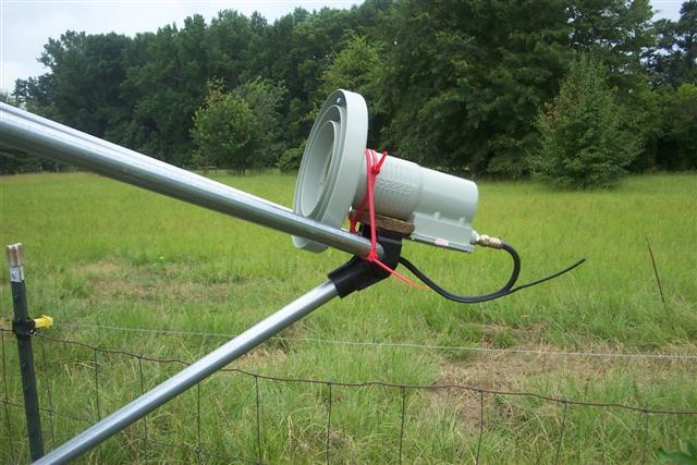

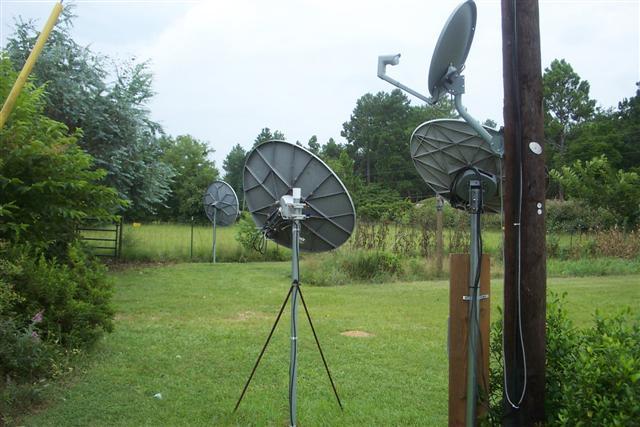

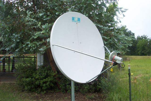

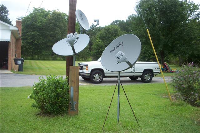

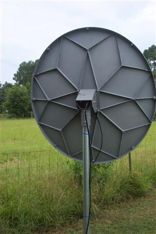

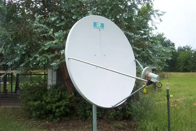

Well here are a few pictures of my setup. Cascade was the inspiration for the micro-BUD. I am using a Coolsat Pro and am getting 73 quality on G10R. My polar mount will be here next week and then I will add my 18" actuator and will use the VBox to control it.

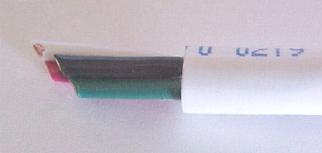

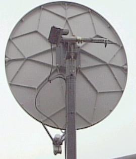

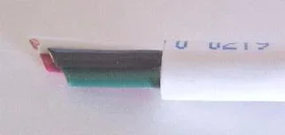

I don't have mine yet but I do have some pictures and the installation manual that Channel Master sent me. I hope this helps. One question. I have to run wires for the actuator and limit sensors. I do not want to buy C-band ribbon cable because it is expensive and I already have a 1000' spool of good RG6. Can I use 16-4 gauge speaker wire rated UL CL2 CL3? I will attach a picture.
  • 800026501 Polar Mount I.I.'s.pdf
  • CM Polar MT.pdf
    CM Polar MT.pdf

I'm using 916ft (yes, you read that right) of Cat6 cable, 3pairs for +v and 1pair for the sensor for testing and it's working flawlessly, nothing's melting yet.
I'm cutting it down to the proper length this afternoon.
16AWG should work perfectly as long as you're careful about moisture ingress.
Lol. I thought about using that also. My run is only 180' and Cat 6 is cheap enough to replace if it gets ruined. I might still use that because 16-4 wire is not cheap. If it doesn't work then I will upgrade.
Anykind of wire should work for the actuator wires as long as it has enough wires for all the separate lines and the wires that carry the power to the motor aren't too small and thus can carry sufficent current. With these actuators you guys are using and the fact that your using them to move fairly small dishes, the actuator isn't going to be drawing a huge amount of current and so you should really need very large wire. Just make sure you connect the wires correctly to the actuator and Vbox. By that I mean make sure you don't connect the motor drive to the sensor wires. Accidentally Doing that might damage the sensor. On my birdview I used some wire I picked up at the local Lowe's. It was wire for use with automatic sprinkler systems.
