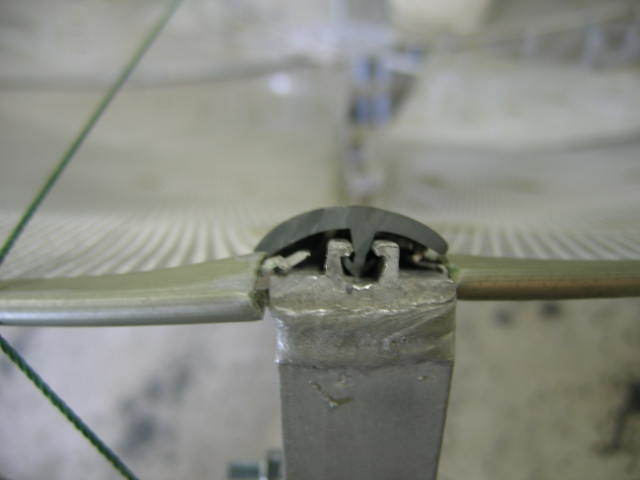

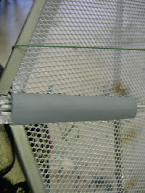

I combed my hometown looking for trim today...this is the best anyone could do. They were nice enough to give me a piece to try. .80 a foot, 12 foot pieces. Looks like a six foot piece can do a rib, so I would need 4-12 foot pieces.
Mauiguy, what say you?

The purpose is to hold down the edges of the mesh and it appears as though that material will suffice.
With that central rib running down each truss, I have been unable to come up with another option...
Me either. The places went I to today had heard of the brand you provided the link to, but they told me no one around here is a distributor, so they cannot get it. I don't know just how tight it will be, but I guess with enough clips the mesh isn't going anywhere anyway. The moulding will just be protecting the edges, and for looks. I think it'll be pretty smart looking...to have it Tuesday I have to order it tomorrow, so off I go...LOL

I went this morning to presumably order the trim, but the guy had found what I needed in his warehouse on site, in the grey color I wanted, so, 43 bucks later, I have 4-12' pieces of trim ready to go.

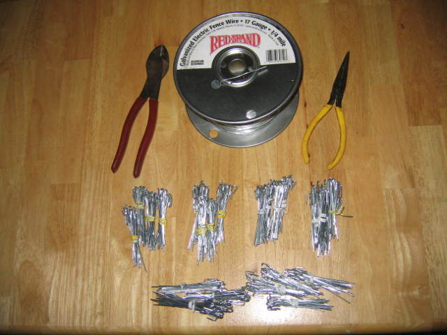

Just in case y'all think I have been laying down on you this weekend...here's 600 clips, ready to go. :)
Oh, and my fingers hurt, too....LOL
I am jealous of your organization. I just made mine and tossed them in to a bucket.
Not jealous of sore fingers though. Been there....

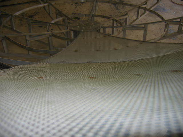

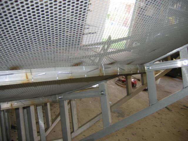

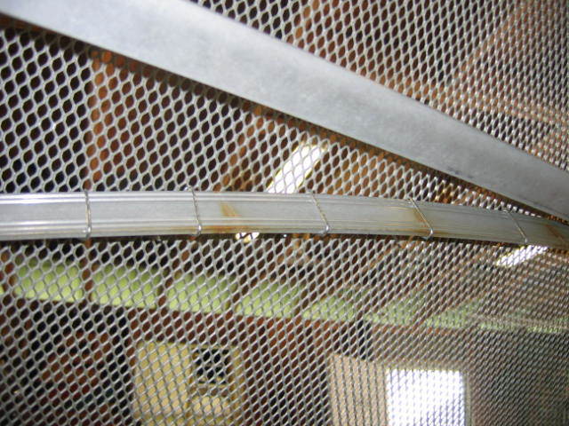

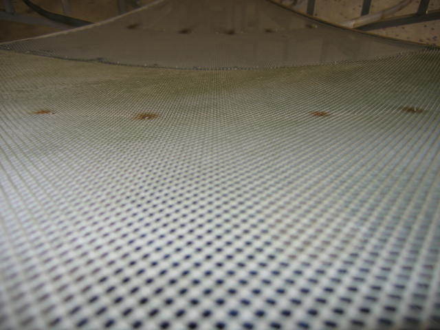

I finally started re-meshing today...got one panel done in about an hour and a half....voila....
If I thought it needed a clip, I put two. :D
I still have to go back and put a couple more in the seam, the mesh was ripped and what I put isn't holding it flat.
