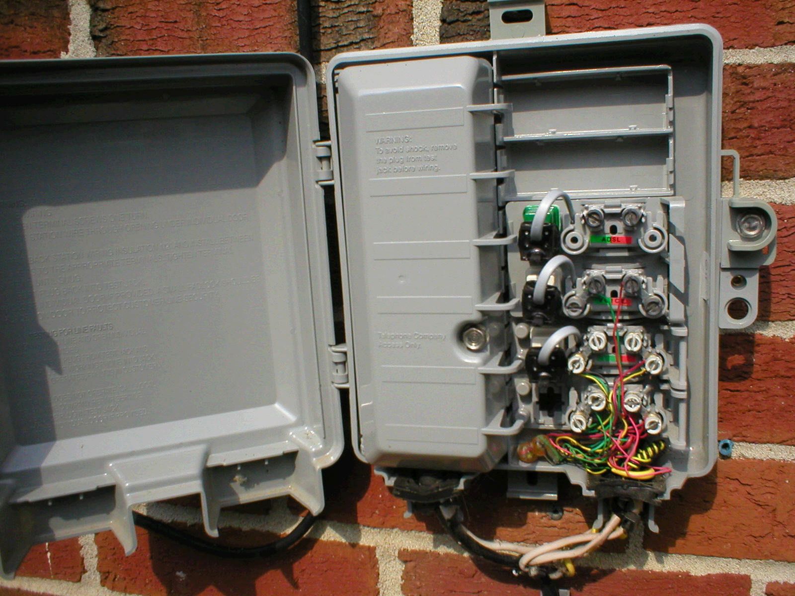

Can I plug the Ooma or Nettalk device into a wall port instead of directly into a phone to power all of the wall jacks in the house?
Got her working. The Ooma is plugged into one of my wall jacks and every phone in the house is power up.

It is important to unplug the the gray jumpers in the phone nid to prevent back feeding and interference.
