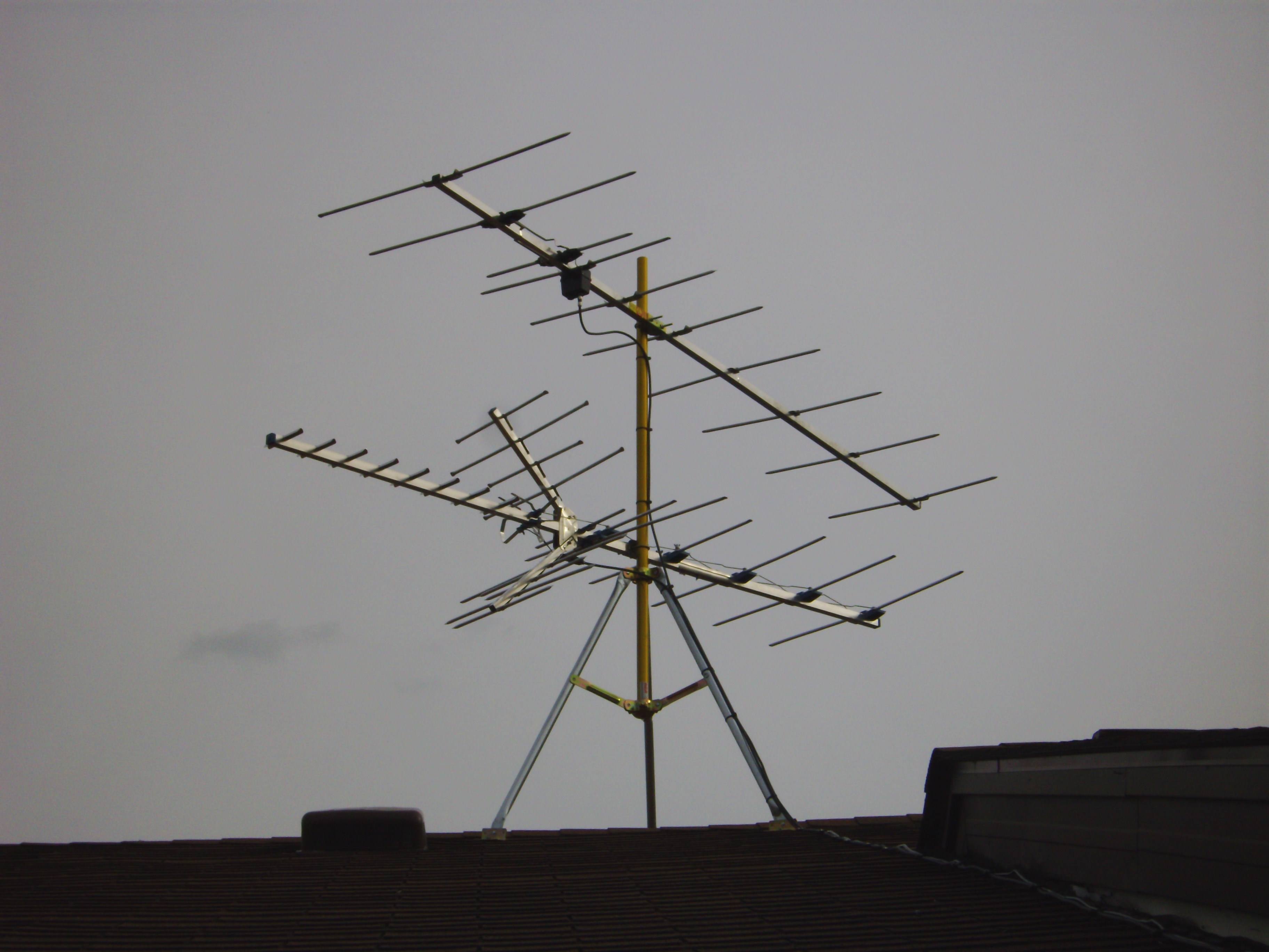

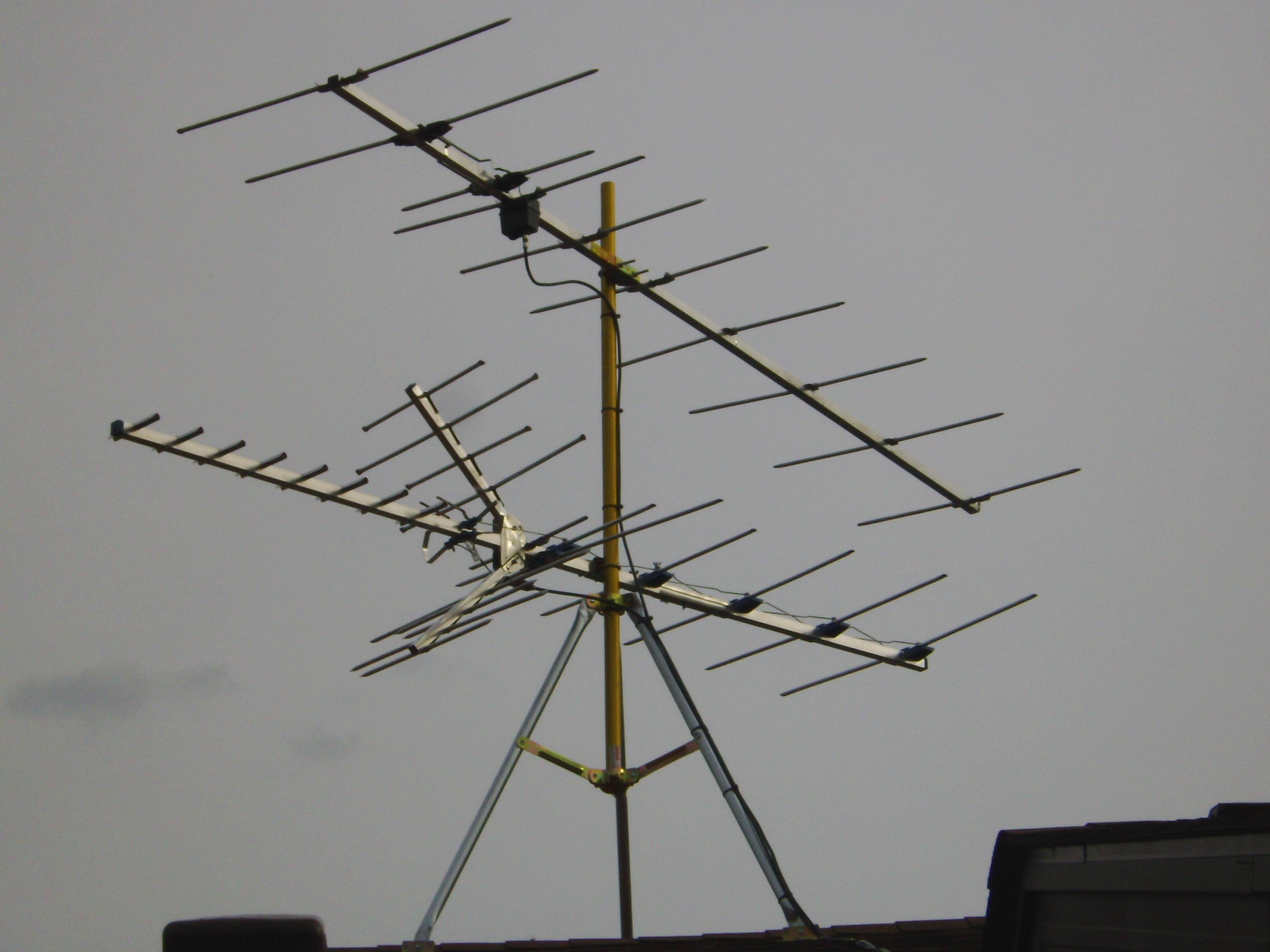

well it FINALLY was sunny out do I got the antenna up today and put the smaller one (HBU33) below it
The HBU33 maxed at 69 on KEYC with the converter box whereas the Winegard maxed at 85 (solid 81 most of the time)
will post pics tomorrow ;)
pics of the antenna setup
5 foot mast on the tripod...I ended up running two lines down the roof into the house
the HBU33 goes to 4 way splitter....DTVPal in the computer room, DTVPal in bedroom, HDTV in main room, 4th goes to a combiner on the UHF side
Winegard goes to the VHF side of combiner and that runs to DTVPal DVR..9 & 11 are between 88-95 (with antenna facing the wrong way) and 12 fluctuates between 74 & 93..had 93 this morning at 10:00 and at noon it was down to 78 and stays around 74-76 during the day

no problem. The top one is facing SW for the distant station and the bottom one is aimed NE for the Minneapolis stations
