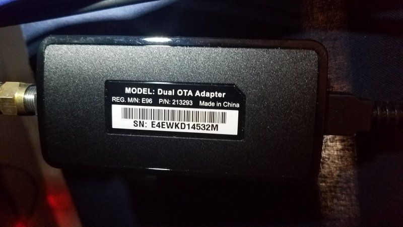

Well I just received a new style black Dish OTA dual tuner I purchased over ebay. The add said it would be the latest version # 213502 and the photo in the add also showed the tuner and a box which read # 213502. But when I inspected the new tuner I noticed that the label on the tuner has a part # of 213293. Now I have read in this thread that others have had the same issue when ordering off ebay. My question is does anybody actually have a new style black Dish OTA dual tuner with the part # of 213502 on the label on the tuner? Because I am beginning to think that maybe there is no such Dish network tuner with the part # 213502 on the label. Just need to know.

I ordered my black new style DISH OTA Dual Adapter from Dishdepot. P/N is 213293. See attached pic.

Obsessive yes. But I still don't have the answer to my question. Does anybody have a new style Lark dual tuner with the part # of 213502 on the label on the back of the tuner? Simple really no need to obsess over my question. If you don't have an answer no need to reply.
