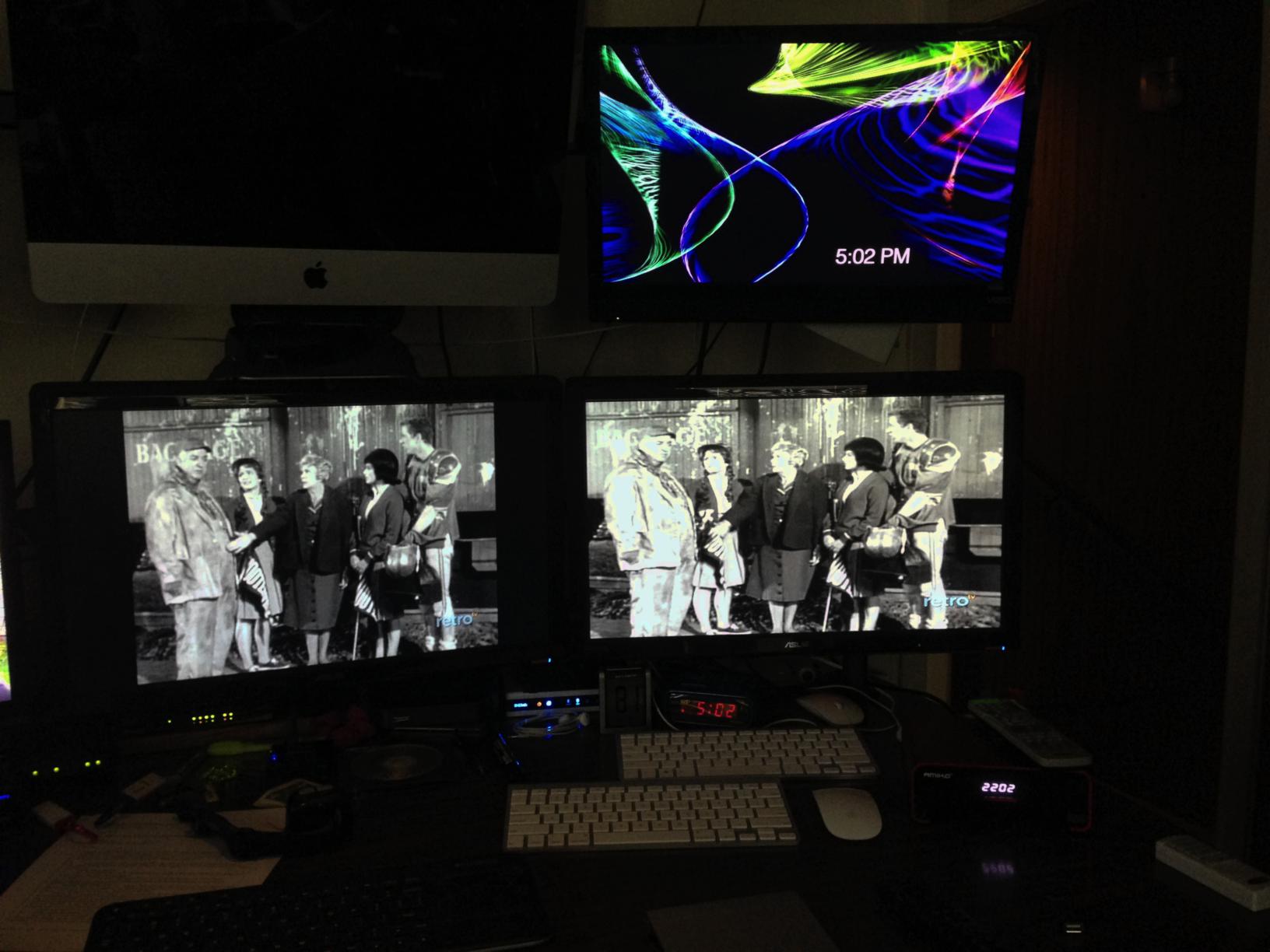

I searched the forum but didn't find anything new about aspect ratios and Squish-O-Vision..
I have two identical displays on my desk and the A3 is connected to one via HDMI. That's the display on the lower right.
The center display is connected to my Mac. I connected to the A3 via the web interface then I clicked the VLC icon and the browser passed the video over to VLC.
I made VLC go full screen and as you can see the same thing playing on both screens. But on the center screen (VLC on the Mac) it's playing in a 4:3 mode which is correct and what I prefer.
The black bars on the sides are how I would rather it be. But on the A3 there is nothing at all I can do to force it into a 4:3 mode. I've tried all the options that appear under "TV Settings - Conversion" to no avail.
I went to the system setup and tried all the options available in there as well. Other channels do allow me to change back and forth between the different modes like Letterbox, Ignore, Combined and Pan Scan.
I need to mention that on my MicroHD I can control this and it displays in 4:3 with black bars on the side as I like it. Honestly, I deeply despise this squished out mode, it's dreadful and whoever invented it should be drawn and quartered.
Is there any way to fix this? I have recorded Luken stuff and it plays back on my Mac (in VLC) as 4:3 without me having to do anything at all.
Recordings play back squished when play back on the A3. It seems that only Luken stuff does this.
At least it's not cutting anything off the top and bottom as I could see when I played the two side by side in real time.
