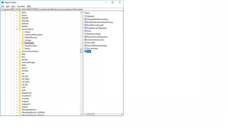

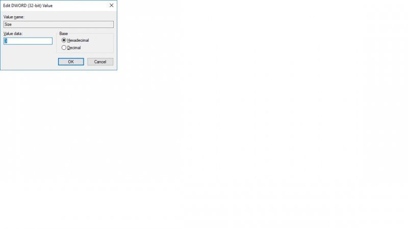

Below is what I found to be a lasting solution to SMB not seeing and connecting to your Kodi Movie Server on Windows: I found the information here:
When you configure one of the four options for the Server service, the information is saved to the following two registry keys:
HKEY_LOCAL_MACHINE\SYSTEM\CurrentControlSet\Services\lanmanserver\parameters\size
Your choices for this registry key are 1,2 and 3.
Note: Mine (Windows 10) was missing the registry key "Size" and I added it gave it a value of "3"
1 = Minimize Memory Used
2 = Balance
3 = Maximize Throughput for File Sharing and Maximize Throughput for Network Applications
HKEY_LOCAL_MACHINE\SYSTEM\CurrentControlSet\Control\Session Manager\Memory Management\LargeSystemCache
Your choices for this registry key are 0 and 1.
1 = Maximize Throughput for File Sharing
0 = Maximize Throughput for Network Applications
So, make sure the "size" key is set to 3. Mine was set to 1, and setting to 3 instantly solved the problem (a reboot might be required for the changes to take effect).
The other key value was already at 1 for me, but still make sure it's not 0.
Reactions: mc6809e and KE4EST
