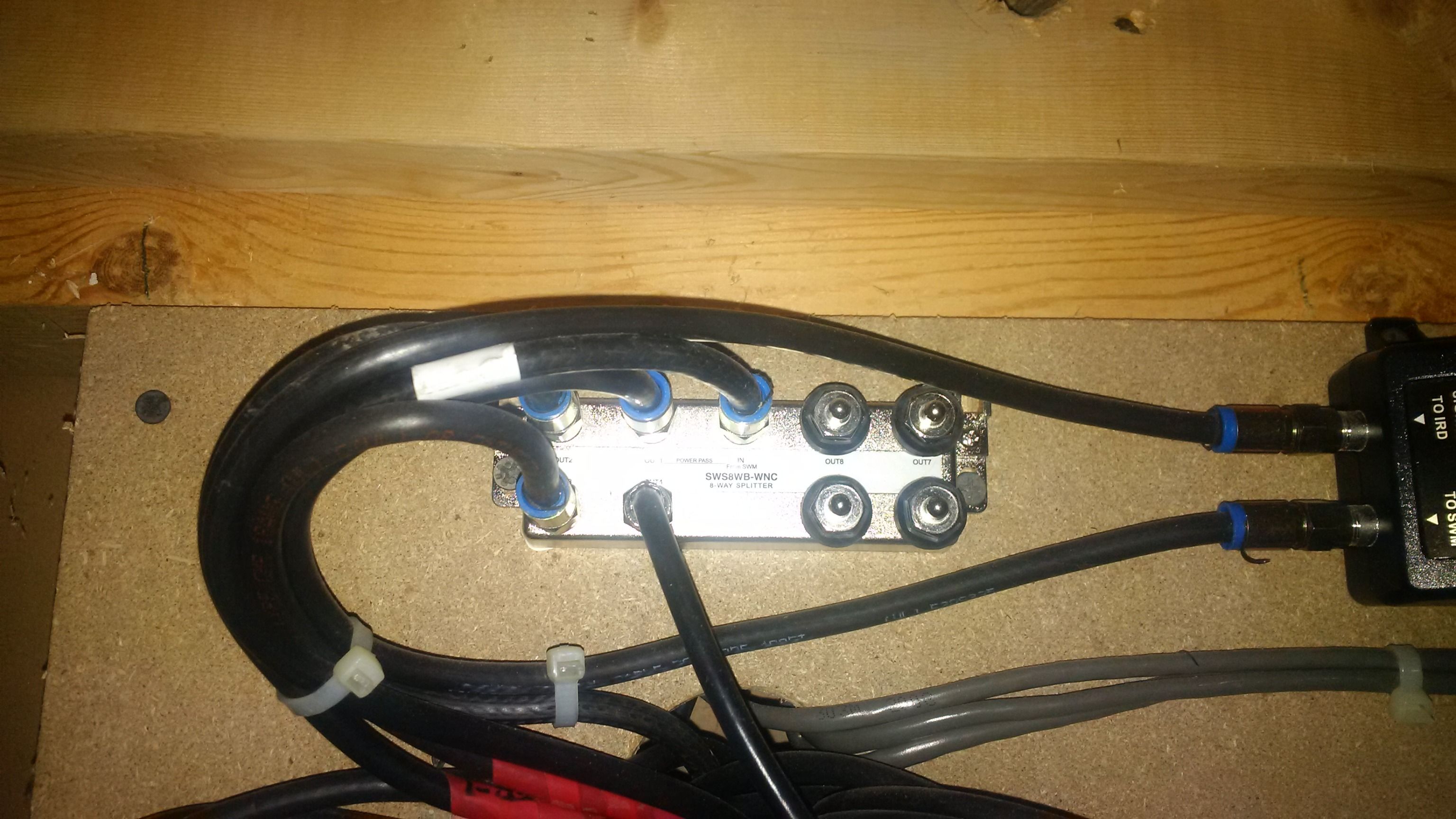

I'm not sure if they are terminated, they have these rubber thing on them, here is a picture.
Those are terminators with rubber boots. You might try a different port, one of them could be bad.
