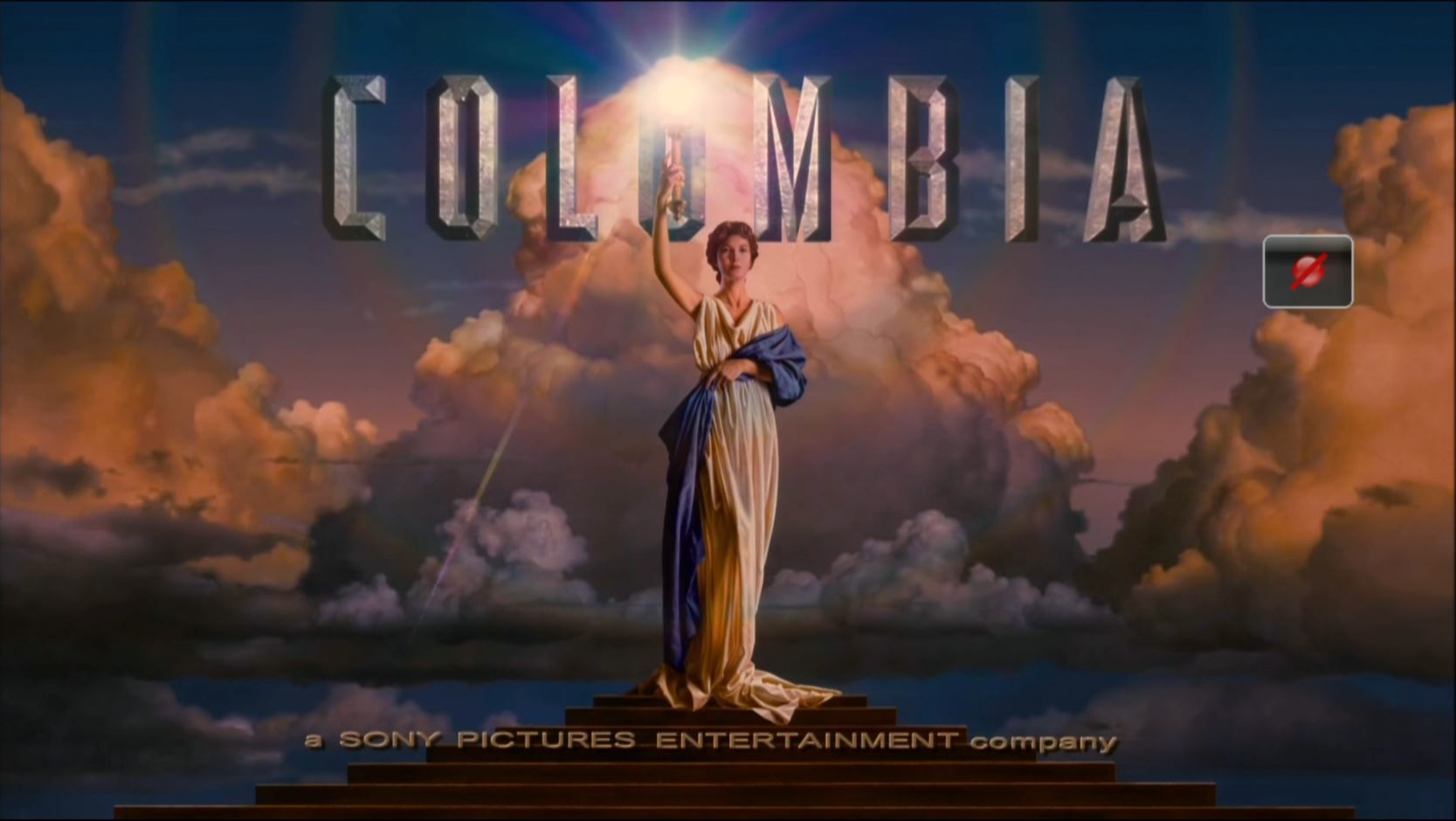

So, here's where the External HDD issue comes in. I previously had two 722s, both using external drives for overflow storage (I'm a bit of a movie hoarder). Before the install date, I moved everything from the 722s to two external drives. The same evening as the install, I tested both drives on the Hoppers, and found all of the content available, though one or two shows were not viewable (blank screen only). I also noticed that pausing and 'trick play' were problematic from the external drives. I would get a strange icon on the screen when pausing (see attached screen shot), and would have to press stop, then press play to resume. Not an insurmountable problem, but it did make me want to move the content to the internal drive for a better viewing experience.
