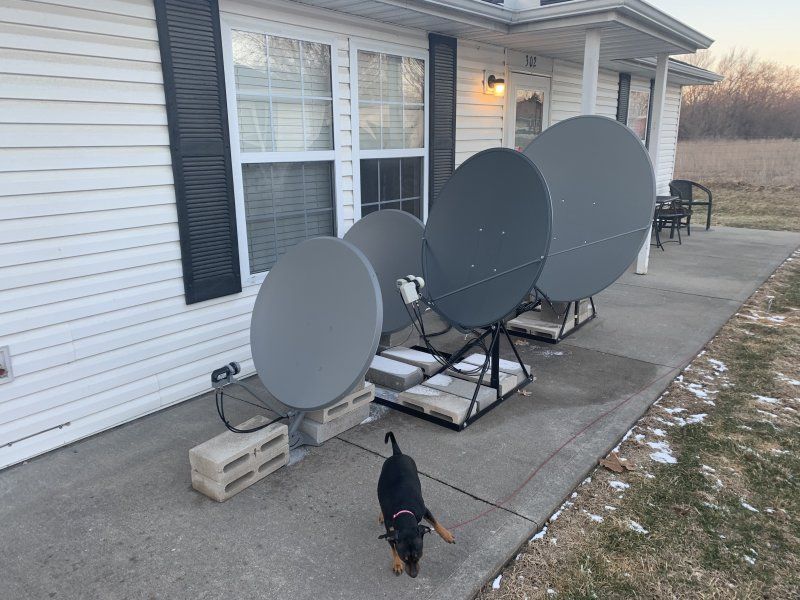

I'm almost tempted to get it installed so I can get a dish on the roof that will give me LOS to Ku sats west of 103. Currently my house blocks LOS to my ground mounted dishes.
Since it's prepaid service without a contract, it seems worth it for the experimental value :)
Dude, your landlord and your dog will not allow that - All dishes MUST be on ground level so the pup can pee on them -
