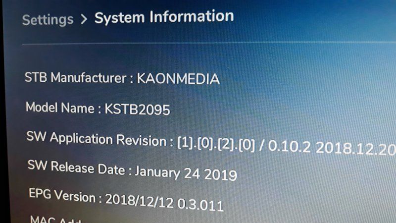

Update: Came into the shop this morning to find that the STB updated overnight. The SW version has today's date. The previous version installed on the STB by the factory was dated November, 2018.
Here is the kicker... The STB issues are resolved! Performed a system reset and went through the set-up without a hick-up. BTW, the 22KHz tone is no longer present. Did the STB only need to need to rest overnight (or take a break from me - LOL) or did a software update change something? Anyway, happy to report that like Bob's system, the STB is working flawlessly with the standard linear LNBF LO 10750.

Just setup my receiver it was having a hard time keeping the signal. I see the software date is Dec 20, 2016. Is there anyway to update from the internet or do i just need to leave it on and pointed at 117 until it updates?
OK I rebooted it and i saw it try to update. Kept failing. Ran a a coax from the LNB to the receiver. This removed all the coax in the RV. Once it had a direct run it updated fine and has been working really well.
