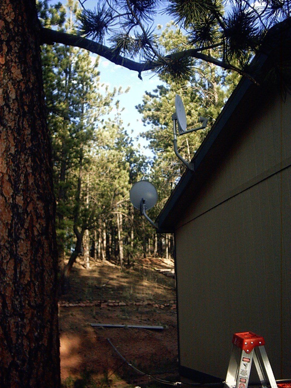

Here's my shot through the trees for 61.5. :)

Judging by the site of what you have there... you really have several solutions...
1: a bulldozer will clear a nice path...
2: a chainsaw will clear a nice path... ( though it will take a bit longer)
3: my personal favorite.. couple sticks of dynomite!!!!
Khandurian....
What a nice place to come home to. Looks like we know what came first from the budget, and the driveway came in second. I will be more optimistic after looking at what you had to shoot through. What do you get for readings on 61.5 from the recievers? I have a DP-Twin and a Dish 500 that I am going to try to get 61.5 with. I am also replacing a DP-Quad with a DP-Twin for my 110/119. Should I put those 2 leads into a DP-34 with the lead from the 61.5? What is your opinion? I also ordered a 941 today, so I'll be using 2 of the 4 outputs on the DP-34 for that. Another output will be used for a 510 that I already have in place. Any and all suggestions are really appreciated.
Thanks: Lyle :up
Thanks! Actually, that's not the driveway at all, just a natural gap (about 5' wide).
On my 921, I get:
  • 65+ on TP 10 26 30
  • 70+ on TP 2, 16, 27, 29, 31, 32
  • 85+ on TP 6, 14, 18, 22
  • 90+ on TP 25
  • 95+ on TP 8, 12, 20
Nothing on anything else. Note that the V* TPs (1, 3, 5, 7) do NOT show up in the point dish screen, so no way to know what's what there.
If you have any doubts about getting enough strength on 61.5 use a DP Single or Dual and a D500 with I-beam adapter. Other than that, you've got a good plan for your 942 or 921. Which is it?
