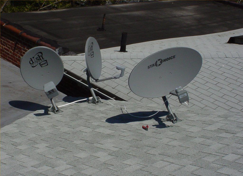

but, I did snap some photos of my whole system. ;)
Pic 1 is on the top roof, the E* and *C dishes. (nothing FTA up there yet) [110, 119, 111.1, 117.3, and 61.5]

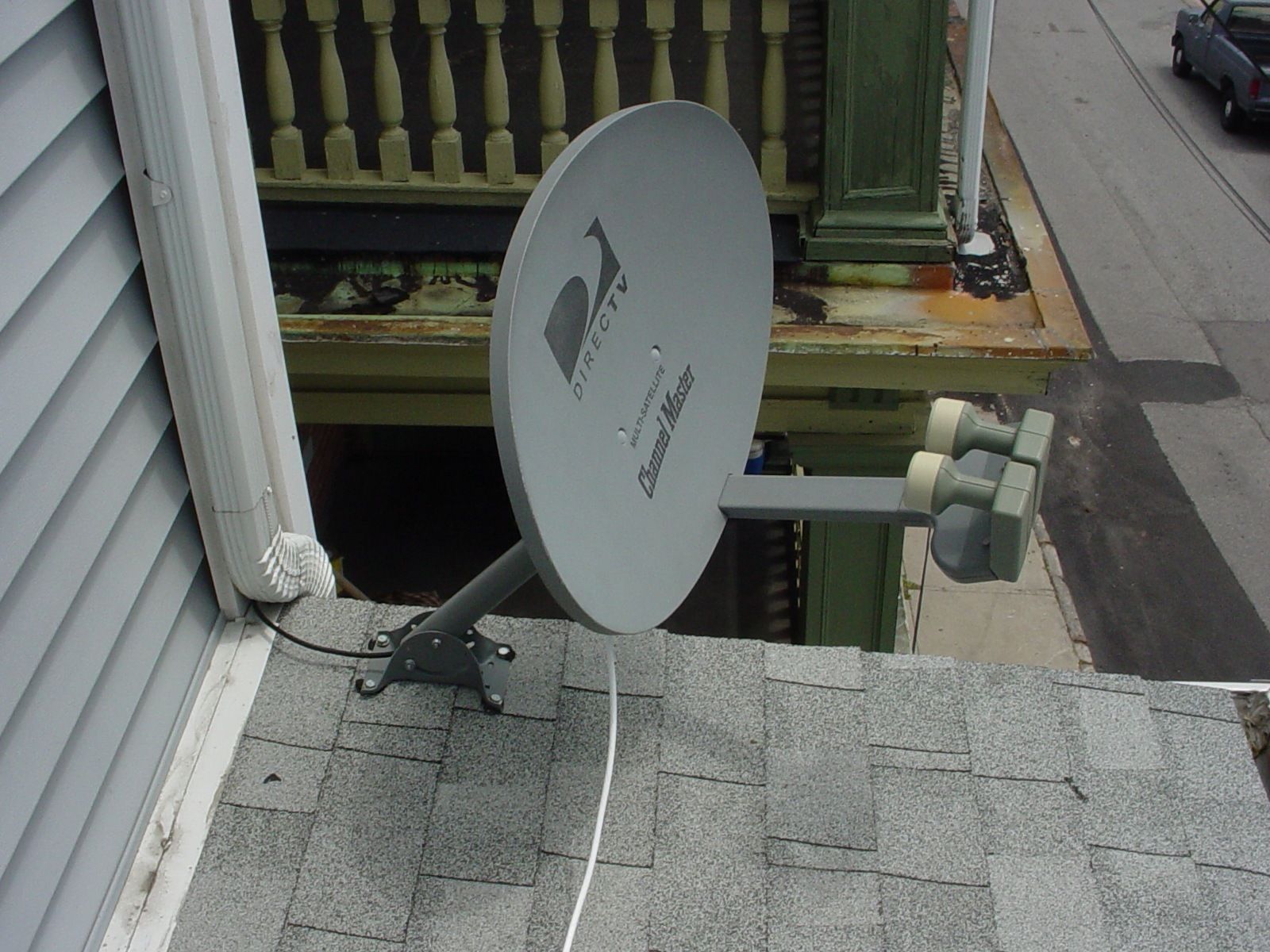

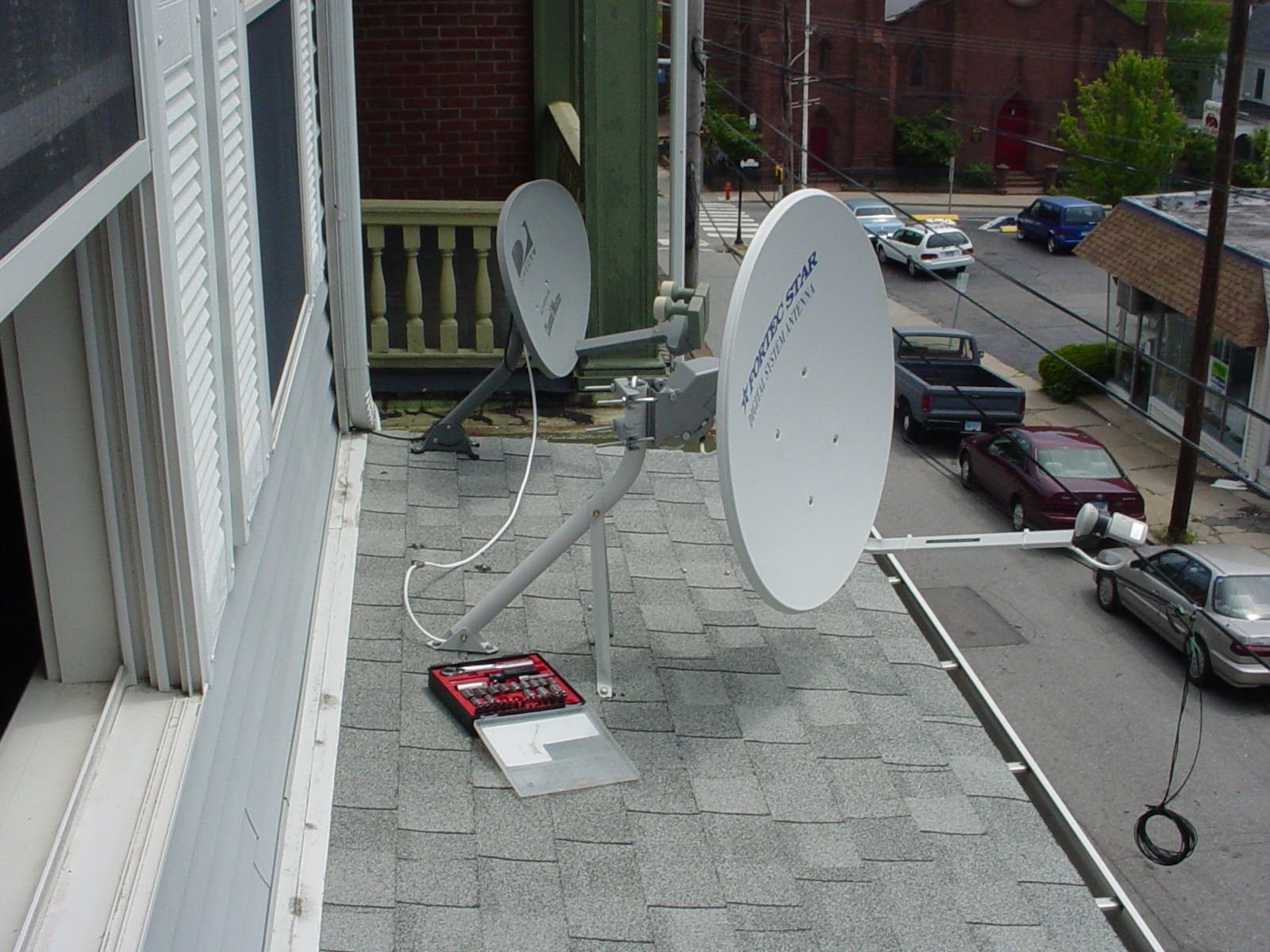

Pic 2 is the balcony roof (All FTA) for BEV and the motorized [82, 91, and motorized]

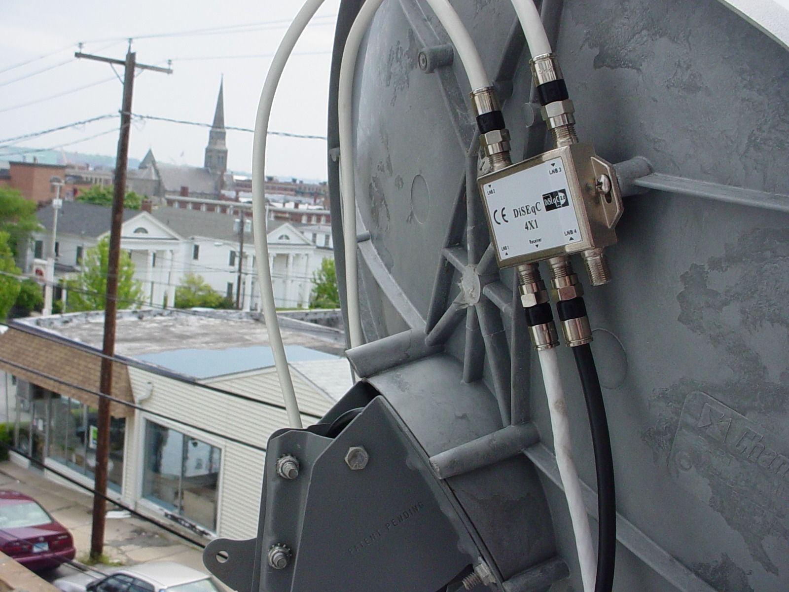

Pic 3 is a closeup of the DiSEqC switch mounted on the back of the Phase II

Pic 5 is just the Phase II

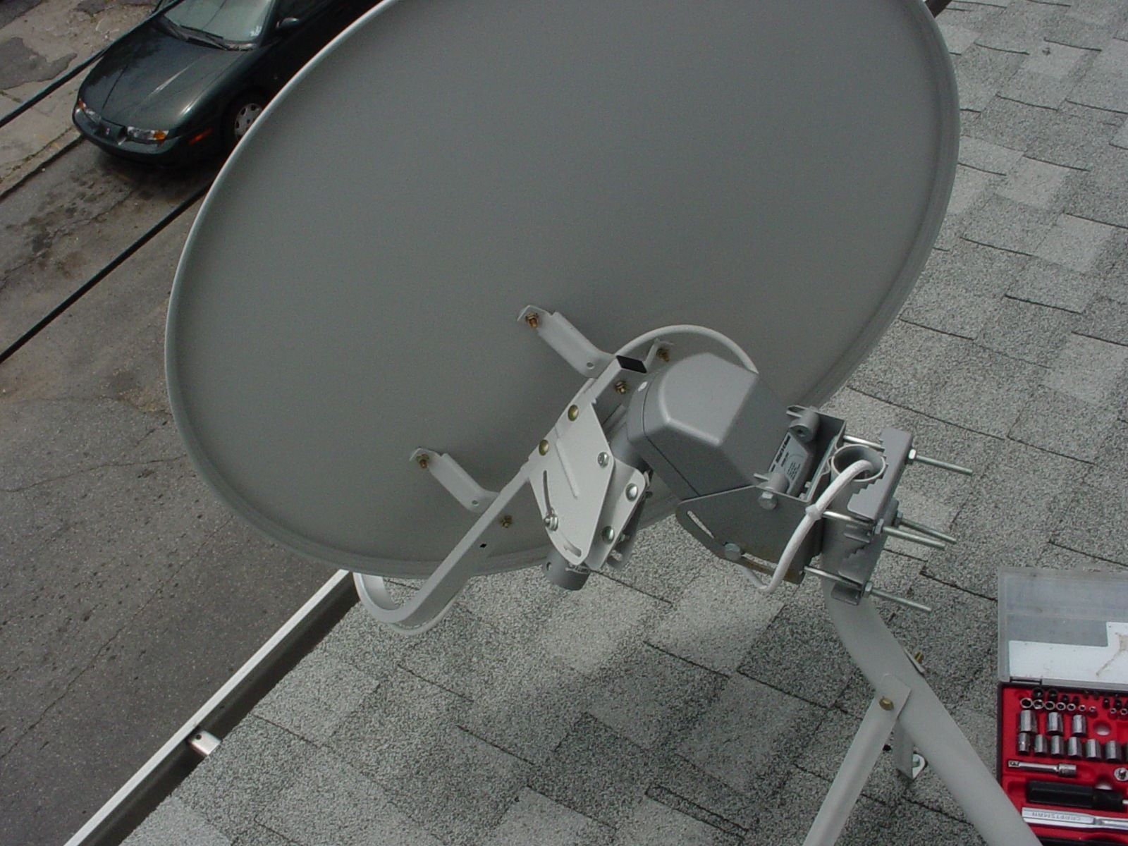

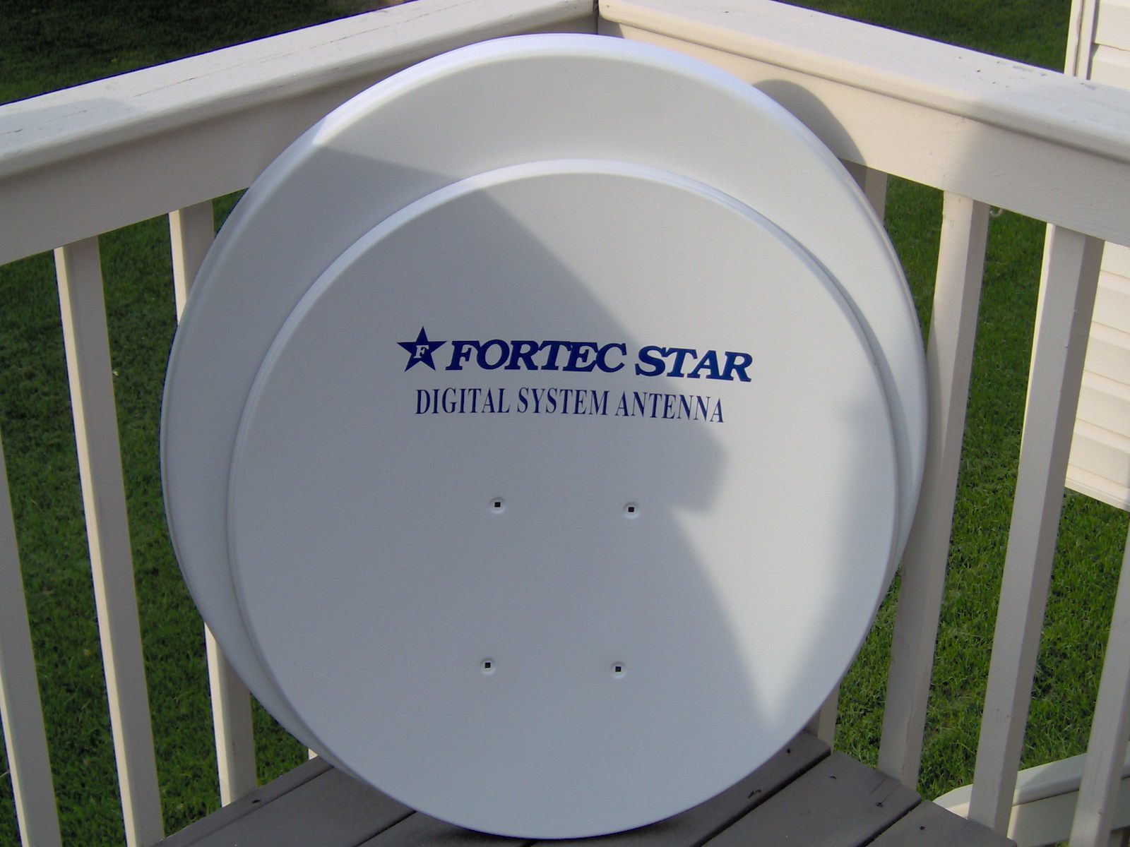

hhhmmm.. in looking at this dish, and arm... it looks like it would be cake to upgrade to 90cm.. just a different reflector and thats it! I can even leave the rest of the mount attached to the motor..
hmmm... food for thought.. ;)
won't work for a few reasons
-the brackets are different (see my 36" review for the pictures of the brackets)
-the spacing for the holes are different
-the arm needs to be out farther because of the larger dish
but unlike me, you can have it on the sloping roof :)
I might mount mine to the deck railing...

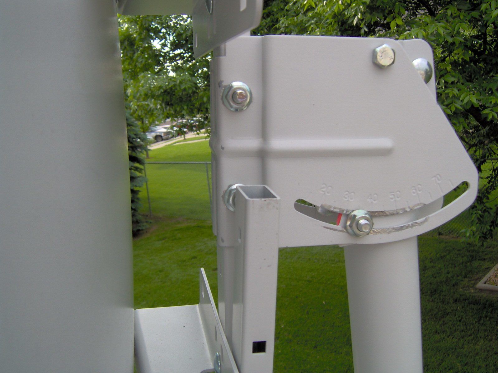

Are you sure? on the mounting arm, there is another hole, about 2cm down (you can see it in the 4th picture) The angle of the arm may need to be adjusted accordingly..
Well, either way, I can mount one on there without disassembling the polemount or motor.. I put the mount on the motor before attaching the arm and dish this morning... just unbolt the arm from the mount, remove the top dish bolt, and slide the whole thing down and off.
yep I'm sure :)
The arm on my Hotdish 30" and Winegard 30" are the same....the Fortec 36" is a couple inches longer :)
oh well, if I do decide to upgrade it still wont be too PITA to do ;)
wonder what that other hole is there for then..

phase2 dishes are usefull for something OTHER then DirectTV?? I have one or 2 of them kicking around here.
yes they are....
If you so desire, you can set up 4 LNB's at 91/101/110/119 for
-Gol TV on 110
-Audio, NASA, and Angel One on 119
-Audio on ExpressVu
-a dummy LNB...nothing is on 101
Iceberg said:
yes they are....
-Gol TV on 110
-Audio on ExpressVu

To use four, I think you'd have to buy a third party 4-LNB holder that is designed for this dish. Has anyone tried this with this holder:
http://cgi.ebay.com/ws/eBayISAPI.dll?ViewItem&category=61386&item=5777392173
Although I suppose you could simply strap the 91 LNB onto the side of the 101 :)
I was considering doing this, since I rescued a Phase II from annihilation by a garbage truck a couple of months ago :) I decided to go with a Dish500 for the music and previews on 110 and 119 instead, because I'm not sure the Phase II would pull in a nice signal with 91 at that far position, plus the Dish500 is larger :)
Or, to use 2 LNBs (110 and 119 with 101 being a dummy position), you would take the LNB holder that comes with the Phase II and open it up. Unlike the Phase III all-in-one LNB, the Phase II has separate, standard D* LNB's plugged into a switch which is inside the LNB holder. Take out the switch, replace it with a DiSEqC, and you're good to go :)
Still might try it someday... I am cringing at having to edit my TP freq's and polarities for the stacked DishPro LNB :( And, this dish is made by a great manufacturer, Channel Master :D

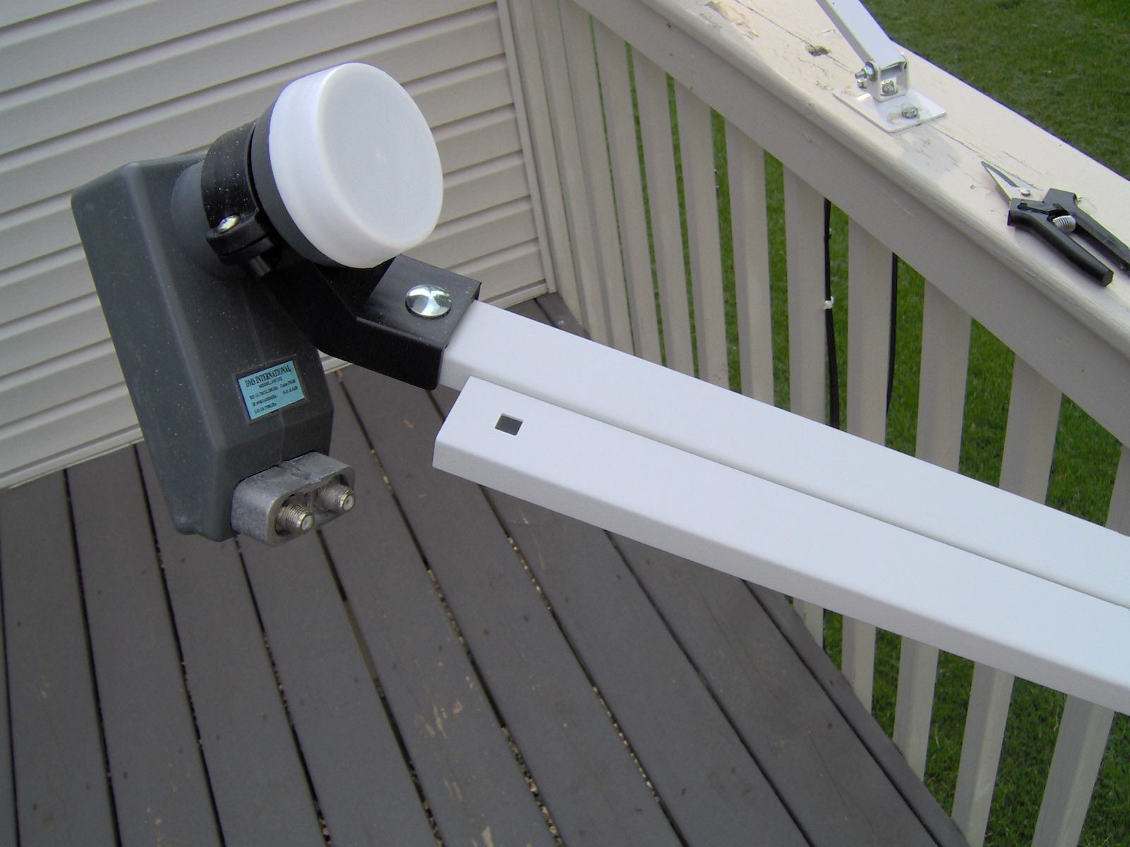

here is proof :)
Pictures of the arm for the 30" and the 36" (the 36" is the one installed)
also for others to see...the difference in size of the 36 vs the 30
