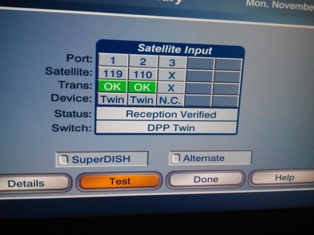

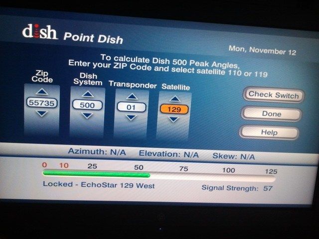

2012-11-12 16.33.06.jpg2012-11-12 16.33.26.jpgES8159_And_Dish500_LRG.jpg The third is the one we have. I have the cord going into "port 1", I also have a satellite finder hooked up at the moment and this is what we got.. Locked - Echostar 129 W.
Also my next question is shouldn't the stations (3,4,5,9,29 etc.) be showing up in the program guide? All I see is like 9000+ and that's it. We were able to watch t.v. at one point and then we lost it and have not had it sense.
While finding signal we have yet to see the 110 pop up and whenever we have the satellite on the t.v. set to 110 it shows up as the echostar 129 and never 110 or 119 satellites.

something isnt right....129W transponder 1 is a spotbeam that doesnt cover your location (it is for Des Moines IA) so it shouldn't be showing any signal

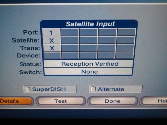

Best thing to do is rerun the check switch and see what it shows in that screen. If it picks up any satellites it will tell you. It really sounds like you are too far west and are getting 129 on the 119 slot and 119 on the 110 slot. That is why you arent getting any locals
If the check switch shows 129 & 119 when done then the dish needs to be moved a smidge east and up a little bit

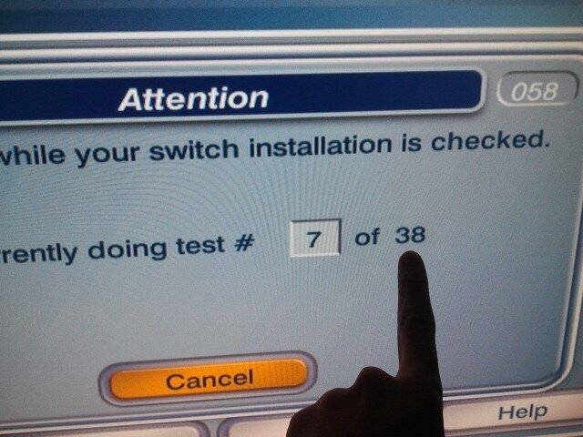

38 is what it does for the older style LNB's (the old Legacy types)....so when its done it probably wont show all satellites. Hopefully it finds something

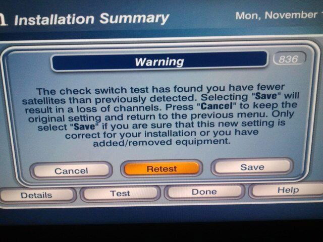

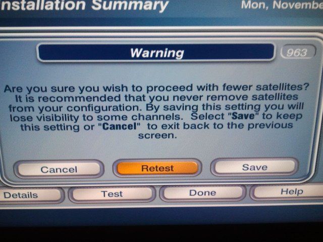

I guess my last message didn't go through. We did watch t.v. on it before about a month ago and then lost signal from a storm and were never able to find the signal again. I did reset to factory settings today. Is that why there were 38 tests?2012-11-12 17.19.41.jpg
well you're not aimed at any satellite then (which is what I figured when it went to 38 tests)

Oh yea everything that you've said is what he have had. we had 32 and the azimuth or whatever was 210. Thats where I picked up that 129. Should we go east then? I already had my line going to port 1 as well.
If you have a Dish Pro Plus Twin LNB like the picture you originally posted, you should not get a check switch that runs 30something checks. In my experience that usually indicates you have a bad connector, barrel connector, ground block, or cable somewhere between the receiver and LNB.
