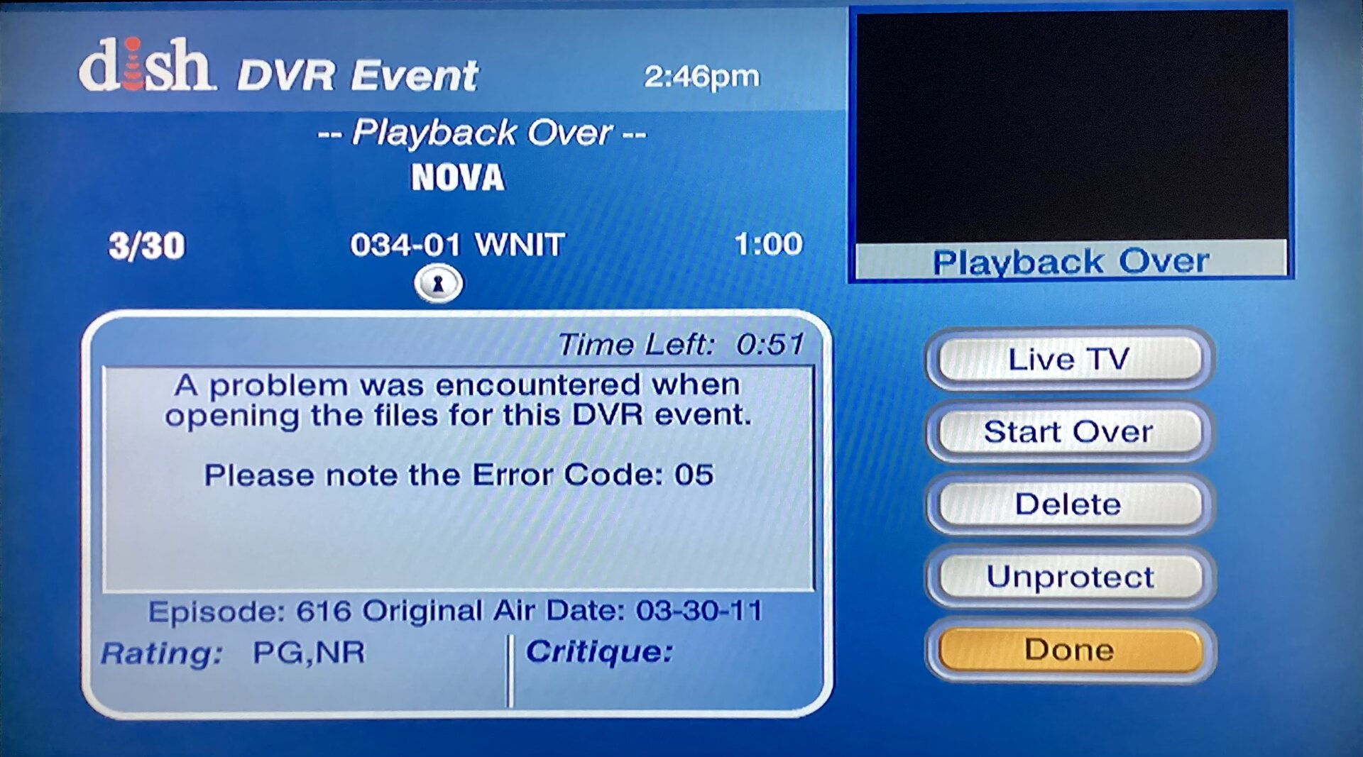

I removed the EHD from the bedroom 211k and restarted it. After it rebooted, I reconnected the EHD and it is rebooting now. I will see what happens, hoping the recordings become playable again.
edit: No Joy, after rebooting it shows the same error:
The next step will be swapping the EHDs to see if the problem moves with the EHD or if it's the receiver.

Actually, I tried something easier. I recorded five minutes of the Olympics and it plays back just fine. I also saw that my Sister must like "Big Brother" as there were a number of episodes recorded last July that also play back. So it seems that old recordings are somehow unplayable.
I'm afraid that somehow the Dish Encryption changed, invalidating the old recordings. The only other thing would be the keys for the encryption were "lost" for our Vacation account and I was "lucky" that we could ever access them.
Any instance of 00-01-02-03-04-05-06-07 is a corrupted DVR file and cannot be recovered.
This typically happens when signal loss or power failure occurs during the recording of the event. If the event was previously playable, it could indicate issues with the EHD.
Thank you for your response, brittanygarden. I wonder if the reason why I could play them before on our Vacation Home account was that somehow Dish had linked the two accounts together, so the fact that these were recorded using our Home account of aaaa-bbbb-cccc-dddd and the Vacation account of wwww-xxxx-yyyy-zzzz.
But now I have some more information. The Big Brother episodes that were recorded July 2024 play back. In the same "Big Brother" folder is an episode recorded in October of last year. It won't play due to Error Code 05.
Is it possible for our account encryption key to change from last year, rendering any recordings unplayable from before we re-activated our account? I logged in and verified that the Account Number for the vacation home is the same as what we recorded when we first activated it in 2016. But then that doesn't explain how the Who concert recorded from AXS pre-COVID plays back fine off of the Family Room EHD.
