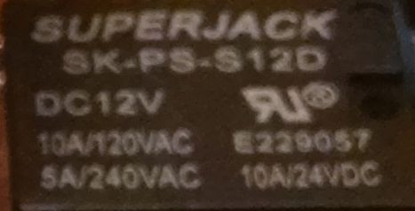

Looks like COIL Voltage is 12vdc. (replacing it with a higher coil voltage unit aint going to work) Load looks like it can be anything up to 240VAC. 10amps @24VDC derate a little for 36volts, so 8amps @ 36vdc. It's plenty heavy. Bet OMRON has one that's identical. (Pin connections on it)
DC12V - coil voltage (nominal voltage to make it 'switch')
LOAD specs: (what you can 'run through it')
10A/120VAC - max current @ 120 VAC
5A/240VAC -(makes sense, double voltage=half the current for = power) Pwr = voltage x current
10A/24VDC
A=Amps
VAC = AC voltage
VDC = DC Voltage
