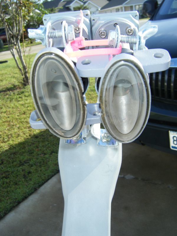

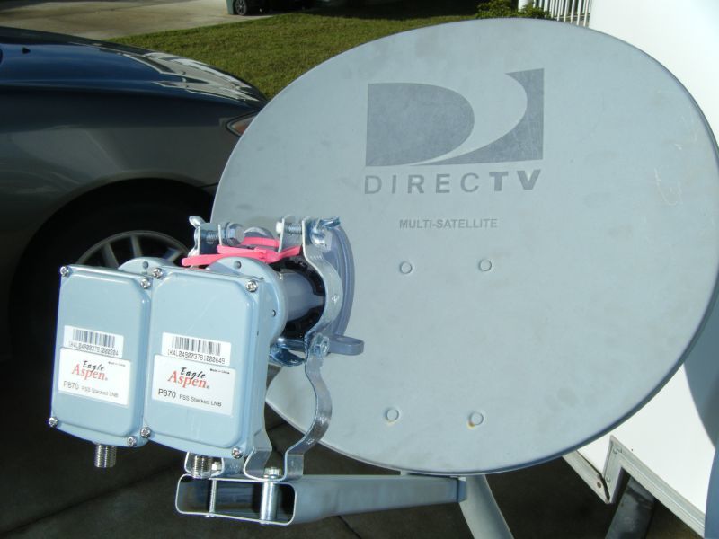

Here's an imaginative idea RedSavina came up with, some time ago.
I've searched and can't find his original post, so I down-sized a couple of his pictures.
Those are DishNet FSS (Standard, but bandstacked) LNBs, with some SuperDish or Eagle Aspen LNBs
Mike Kohl used to sell 'em.
I don't believe for a second those feedhorns match a DirecTV Phase III (nor a Dish 500). ;)
But they might do okay on a DirecWay, which you seem to have plenty of.
Plus, the larger dish, would perform much better, as well. - :up
As always, your mileage will vary, no deposit / no return, objects may be larger than they appear in the mirror.

Woa Anole! That's a trippy looking setup! The second picture looks like a cartoon character. :)
