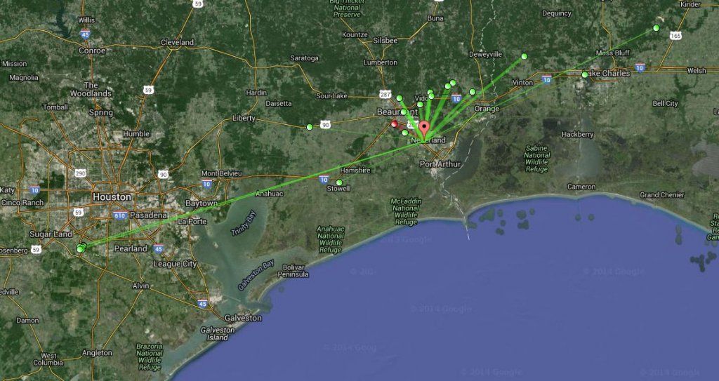

As for antennas, I decided to just go ahead and try putting insane numbers into the TVfool thing just to see what it would take to get past the problem of the earth being in the way.
I tried telling it I have a 200 foot tall antenna, it still said "2edge" (more rocket science terms) which I take it to mean that it's not going to work well.
Then I tried 500 feet and that gave me a "1edge" result. Better I presume but still not ideal.
So just to see what it would take to get a LOS (I do understand this one) I tried putting in 800 feet but it rejected that and knocked it down to 500 feet.
So the app limits what you can tell it you have. And that's fine because there's no way in the world I would ever have anything like that.

However it's not Dallas I'm aiming for it's Houston. Dallas is like 450 miles away, there's no way in the world to pick them up.
Houston (the towers) are 93 miles away and they are very close to the coast like I am so I think their elevation is going to be close to mine.
As for the towers there it appears that there are about 5 of them clustered within like maybe a 1/4 mile area and they all seem to be about 1,900 feet tall, plus or minus a few dozen feet.
Also it seems there are about 75 channels coming in on those assorted towers. Most of them I have no interest in, there's maybe at best 10 channels that I would ever care about.
I haven't taken the time to get the signal strength maps for all of them, I don't see any point in it because I'm going to assume they are all going to be similar since all the towers are close to each other and about the same heights.
http://www.rabbitears.info/market.php?mktid=13
http://www.rabbitears.info/locationmap.php?request=location&location=Missouri+City+(TX)

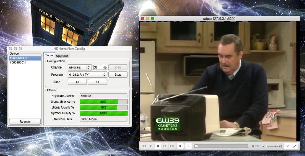

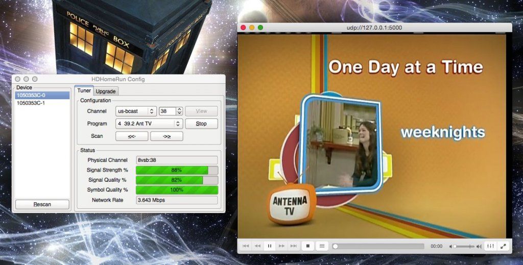

And get this, all day long it's been raining and all day long Houston stations have been coming great.
So the clouds are reflecting the signal back down to this area?

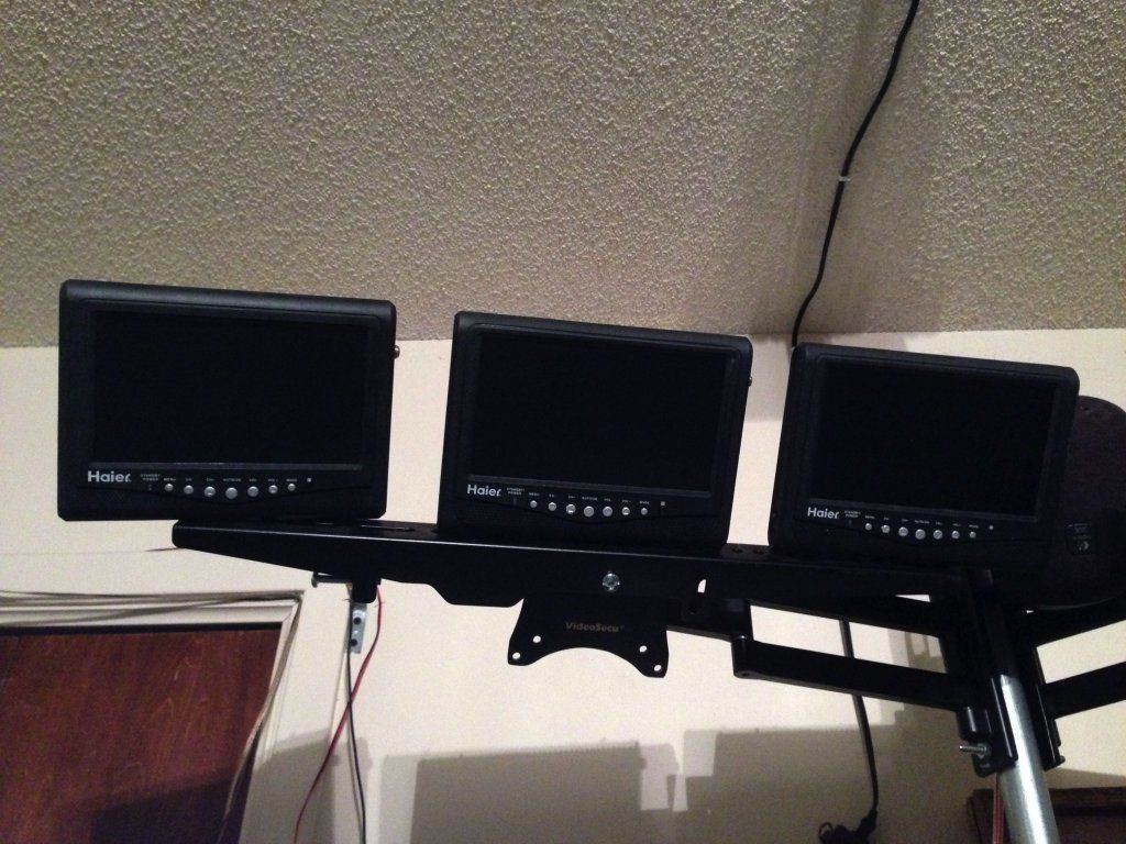

Oh yeah, your little screen.. Those are pretty decent. I bought three of them.. :D
