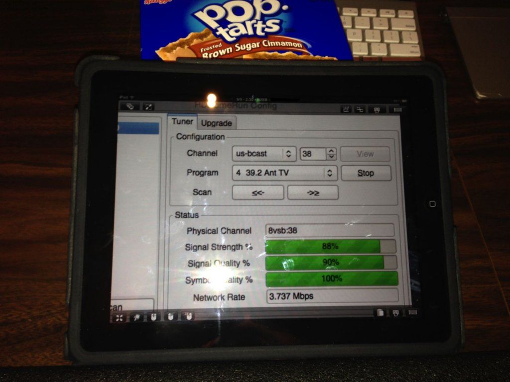

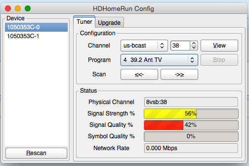

So my dad is coming over in the morning, tomorrow (actually today) is the day to finish this up and take that scaffolding down and return it.
I told him I had to go up one last time to adjust the antenna because the VHF antenna is off a little and the UHF motor is about 10 degrees off of North.

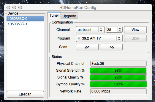

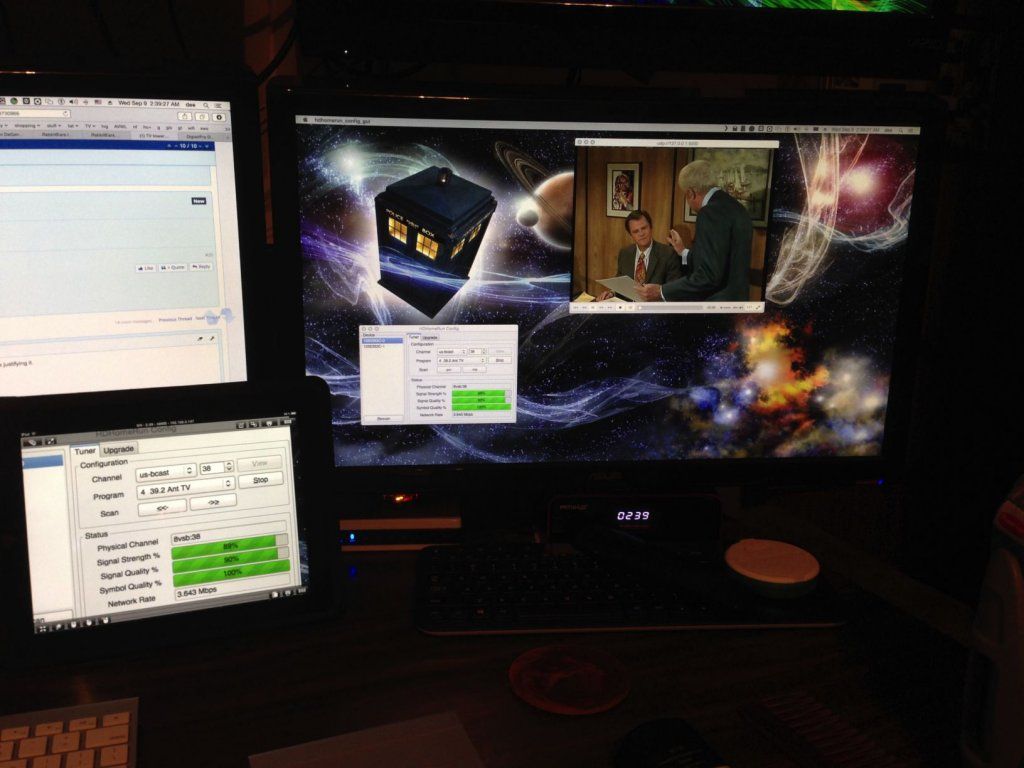

So now I'm in a pinch to get this over with so I figured out something, I can use the HD Homerun Config app as a signal meter.
With my old iPad I can use remote desktop to view the app running on my Mac. I just pinch zoom the iPad so the app is zoomed to full screen and now I have a portable signal meter I can take up with me to help me adjust the antenna.
Where I'll be standing to adjust it is just about 15 feet from the WIFI inside so that's not a problem.
It's not like having a fancy meter but I think it will work well enough this time. I've really got to get it right because I don't want to ever go up there again.

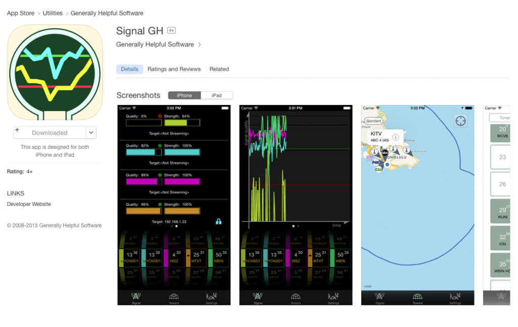

Dee_Anne,
Do you have an iPhone or iPod Touch? If so, then you could use the Signal GH app to remotely monitor the HDHomeRun's SS and SQ. You just need your wifi to be usable up by your antenna.
Alternatively, there is an app called CanCam that will relay the output of a laptop webcam over your wifi to an iPhone. I use that for displaying the MicroHD SQ when tuning a satellite dish. Could be used in a similar way to display a TV SS display (provided it doesn't time out!).
Thank you, I'll see if I can find these apps in the morning. I may just squeak by with remote desktop for now but in the future the apps may be the best thing.
Thanks all ! :)
Edit: Oh man, that app looks like exactly what I needed! I went ahead and bought it, it was $2.99 but it looks like it's more than worth it. And it had favorable reviews.
It won't work on my version 1.0 iPad that's stuck forever with iOS 5.x but it works great on my iPhone 5.
Thanks !! :D

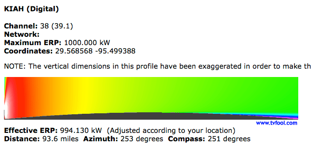

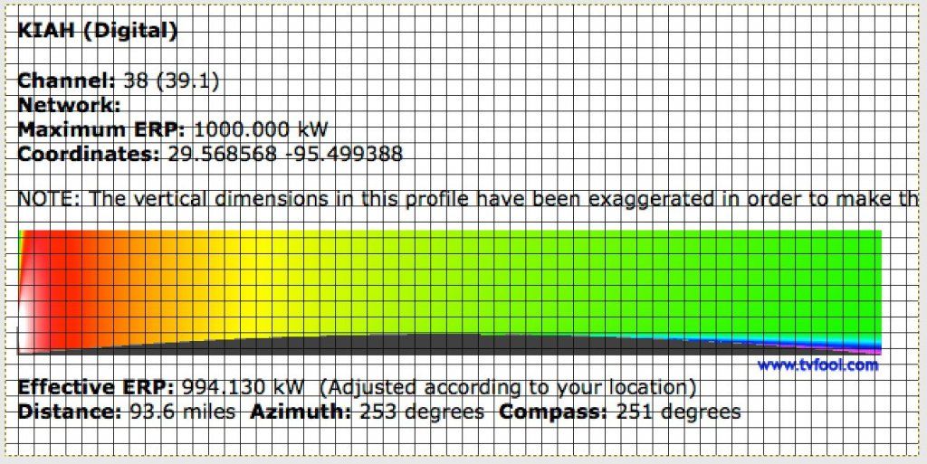

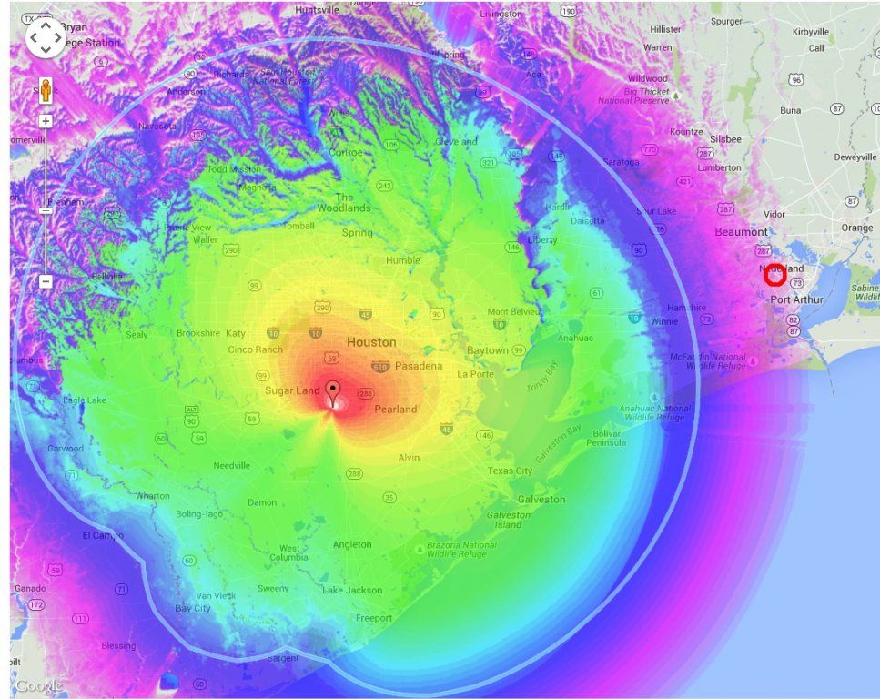

Here you can see the signal strengths between night and day, I took these readings at 1:42am and again at 12:58pm and there's a radical difference.
Also the Rabbit ears map shows me right on the very fringes. This is true for all the Houston channels because almost all of the towers in Houston are clustered together within a very small area that would be like maybe 10 square city blocks out in Missouri City, a suburb of Houston. So I just aim my antenna at one and they all come in. TV Fool says the distance is about 93 miles and says it's "2edge" which I have tried to understand but my brain can't deal with whatever concept is behind it. I do know that there are no tall buildings or any tall things between here and there, only the curvature of the earth. The towers are all close to 2,000 feet tall so that helps I guess.
I put one of the signal displays in a paint program and overlaid a grid on it and now I can see that there's no way on earth for me to have a LOS to the towers without putting up an insanely tall tower myself and that's not going to happen.
I guess the best I can do is go as high as I dare, 40 feet, and build an extreme antenna with the best stuff I can find and just accept that I probably will never be able to watch in the daytime.
As for that, what is happening at night that lets me watch a great signal but not in the daytime? Is it bouncing off of something?
I remember back in the 70's there was an FM radio station in Houston that played GREAT rock but it only came in during the winter. Someone told me that it was because the cold air was denser and the signal was bouncing off the cold, dense air. But this is summer and it's insufferable hot, there is no cold air here until you get like miles up. I don't know, I just have no idea what it is that's causing this situation.
