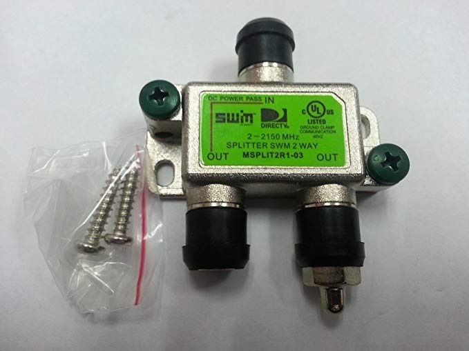

Are splitters also an issue w/ the H3? Currently the DTv sat feed splits with this, running to the HR44 & C61.
No splitters can be in the cable to the H3 between the LNBF and the Hopper 3, itself, other than a Hybrid Tap which only serves to "relocate" the connections of the Hub to another location away from the Hub itself.

Well, perhaps I misspoke, but the only thing that can interrupt the cable from LNB to Hopper is a Hub or a Hub and a tap. Otherwise, the Hopper will have no signal.

The tap! That is what I was referring to. It splits out the MoCA signal that partly blocks the OTA signal, leaving the line from the hybrid LNB free of interference to that OTA signal. Now, if diplexers cannot be placed in that line (LNB side) without interrupting the LNB signal, then you can't do what I am proposing. But I claim they can be. No, I have not tried this.

The tap passes both MoCA and the satellite signal to the Hopper. It strips out the satellite signal on the client line.
I've never tried what you're proposing but I've got a hunch that there might be some control signals being passed on the low frequencies like the SWM control on DirecTV which OTA might get in the way of.
