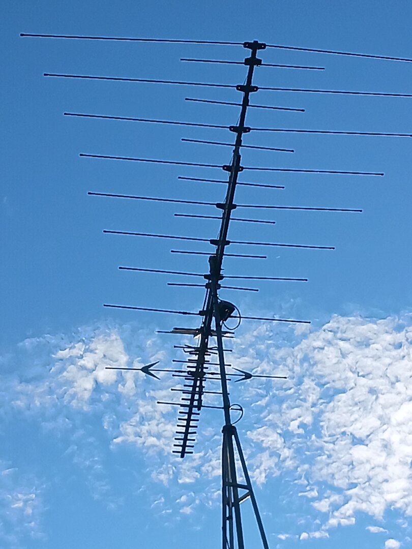

Your symptoms reflect issues with either trees or multipath. Does your antenna face any trees? Multipath is where TV signals from other stations interrupt your signal briefly and cause havoc. You can mitigate multipath, sometimes, by rotating your antenna a bit either way. This is all assuming you have an outdoor antenna. You say you are receiving your Detroit stations from the front of the antenna and Lansing stations off of the side. This could be a part of your issue. You mentioned a rotor in your system. While I know it makes perfect sense to find that happy place where you can receive both cities without turning the antenna it might be the cause. Are the stations that drop down from Lansing or Detroit, or both?
That is a pic of my Channel Master antenna that was installed in 2002 on a 30 foot tower with a CM amplifier up at the antenna and something associated with that in the basement. I also have a 4 way splitter in the coax that I understand tends to It is pointing directly at a stand of mature oak trees about 150 feet to the east (toward Detroit stations). It is very possible that it is a tree problem, however, we have never had a problem with this situation before. It could be that the trees have grown that much in in the last year. I am not savvy on tv signals and equipment and have lost the fellow that has installed all of this equipment over the years. I did have the rotor replaced awhile ago but wasn't empressed by the guy. I think I will drop the antenna and tower before winter and replace the cables and check connections and learn how to test the amplifier and see what the antenna looks like condition wise and if that doesn't fix it I will accept that it is a tree problem and just go with local channels from Dish, although they don't let us have the Detroit channels that we like. Appreciate all of the comments and suggestions so far. I'll keep updating as I do something.
Next test... disconnect the 4 way splitter (tag the cables), and run the input to a single Dish receiver (use an RF barrel). Let that run a little and see if you still have the problem. You can look at the signal meter, but don't put a lot of stock in that.
That splitter is cutting the signal TO 25% for each output. *IF* bypassing the splitter solves your problem, you need another amplifier just before the splitter. Splitters used to have how many db drop labeled for each output. A four port splitter will probably be -6 to -7.5db. Take that number, multiply by 4, and add an amp equal to that (6 x 4 = 24, so get a 25db amplifier).
