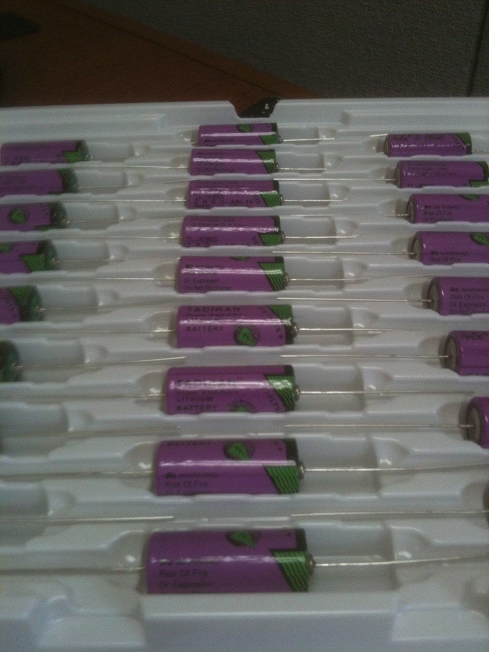

I replaced a few batteries in DSR-410 units on Sunday.All ten batteries were leaking so I would get on it soon:)
Its crazy how the battery's have green and white stuff coming out but yet still work.
I wonder how low we can go in volts i saw one at 2.92 volts and still had unit ID?

I use digi-key part # 439-1008-ND
