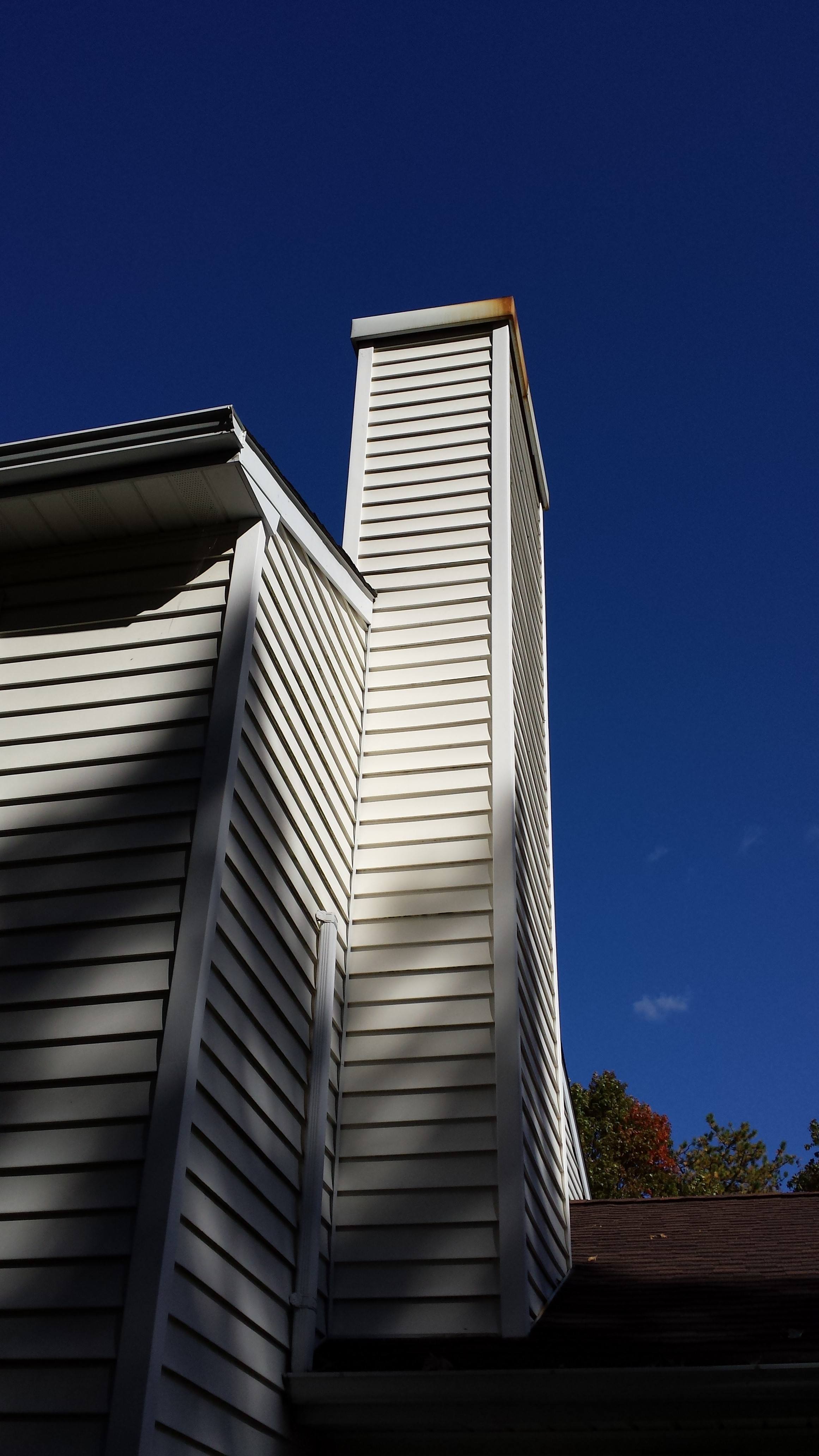

I am thinking of switching to Directv from Cablevision (better price, channels, etc. etc.). I live in a community with a HOA that has specific rules on mounting a dish. I'm being told that the dish must be mounted on the chimney and not on the roof and must be on the back of the house.
I'm fine with that, but the chimney is surrounded by vinyl siding and I don't want anyone to be drilling into the chimney. Also, a pole mount is not an option per the HOA.
Are there alternatives that don't involve drilling into the roof (which I'm being told will void the warranty for the roof). Also, what is considered a "standard installation" by Directv? Do they even perform any other types of installations?
I took a photo of the back of the house so you can see the chimney. Any advice anyone could give would be much appreciated!
Thanks,
MrMetView attachment 92173

That roof warranty thing is a load of crap....From whomever told you that, ask to see the hard copy of the terms and conditions per your roof. Or ask for the internet link....I guarantee you'll not find a single word that specifically states where a penetration into the roof material will void the warranty on the entire roof...One must ask this question...."Do the stack vents for my plumbing waste that are sticking through my roof void the warranty?
Of course not.
Thanks for this info. I'm going to sound like an idiot here, but what is the risk of mounting against a 2x4? Is this pretty commonplace for chimney mounts? What can I do to ensure that even if I get my landlord to agree, that the installer completes this properly? What would be the risk of having the dish mounted to a chimney even if it were done properly? Also, here's what the rep from the board gave our landlord:
***From his email:
Yes you need to submit this hold harmless agreement and an insurance certificate from Directv naming :
HOA name and address
Also the dish must be installed on the chimney, not on the roof. The roof warranty will be void if dish penetrates it. Dish has to be installed in the back of the house not the front. ****

The HOA is WAY out of bounds on this. Those rules are unenforceable as they violate federal law and FCC regulations.
Do this. Order the system from Directv. Be sure you get a letter of permission from the property owner indicating they permit the install. Show it to the tech when he arrives.
The letter should include the name of the owner and a contact phone number and their signature.
If the property owner has any restrictions on where you cannot install the antenna, be sure those are listed on the letter.
The HOA can't put rules into place that force you to install in unacceptable locations.
If DirecTV says a chimney install is not acceptable, then the HOA rule is invalid. They can't say you can't install on the roof OR pole mount, particularly if any of those areas are exclusive areas. Also, they cannot say you "must" install it on one side or the other, if the side they demand you install it on will not work for any reason.

Iam an installer. The HOA has NO power to stop the install. You can and should get the dish installed on the roof in the back of the house. I would NOT install on the vinyl if I was the one doing the install. I DO NOT like installing on a chimney if I have to leave my ladder and crawl onto the roof to get to it. It is a safety issue. The OTARD rules spell out exactly the limits of HOA rules on you as owner or renter when it comes to being able to get television services. Those rules keep HOA cops in check and allow you to install antennas and satellite dishes.
