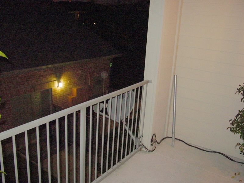

My situation is a little different. My balcony at my condo faces east into some trees. I am in an end unit. If it turn to the right(south) there is a small open grass area and then the next building. To get a good southwest view would I need to mount a pole on the patio that clears the roof two stories above? Or can the dish be mounted on the right(south) side deck facing the open grass area at an angle to try and catch a southwest view? Or is a ground mounting (provided the HOA approves it) back behind the condo with a clear view of southwest the only option? Thanks for any input. Ask me for more details if needed.
Need some advice here... Upgrading to Slimline Dish from 3lnb dish, in about 10 days.
I have a second floor apartment, right now my 3 LNB is ziptied on the outside of the railing for my balcony. The dish is pointed almost parallel with the face of the building/balcony, it is about 10 degrees from parallel outward.
If I was to install the Slimline, I would think since the dish needs to hang out of the balcony to point sideways, I would need some type of pole mount.
Would the installer let me U-Clamp a pole to the railing and he simply attaches the dish to that with an arm? My balcony is a metal railing, similar to this
Is there a possibility to install it in a 5 gallon bucket with concrete on a pole, or is that too unstable/flimsy?
I don't think I could do anything like the original poster did with the concrete bricks, because the apartments are fairly picky with things on peoples balconies... They forced me to remove my HD Antenna Channel Master 4228 which I mounted on a pole on a tripod about 4 feet high.
Any advice would be great.
Thanks.
I want to tell you to do a Google search on OTARD, but any place that fussy you have to wonder about having your dish extend beyond your deck/personal area.

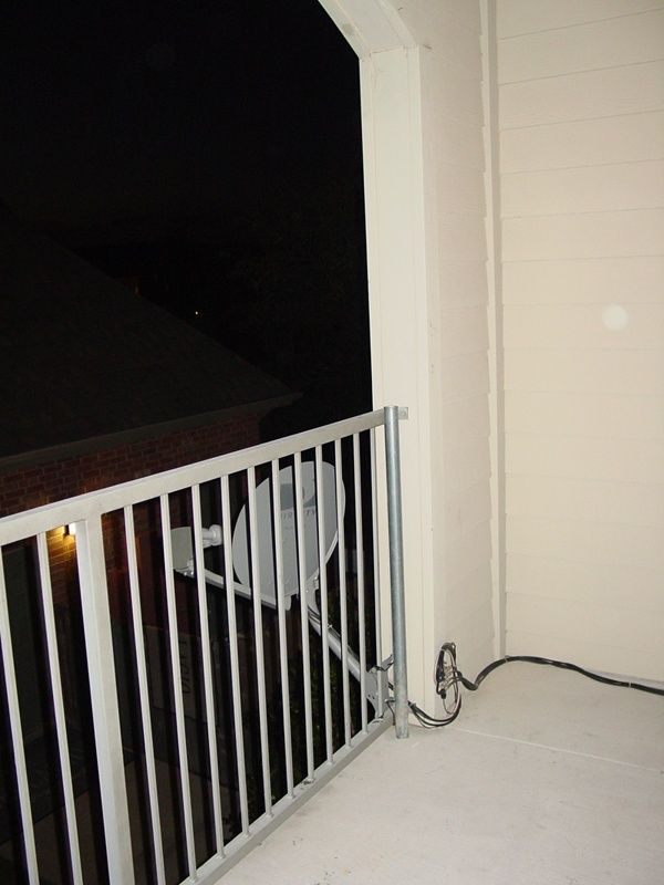

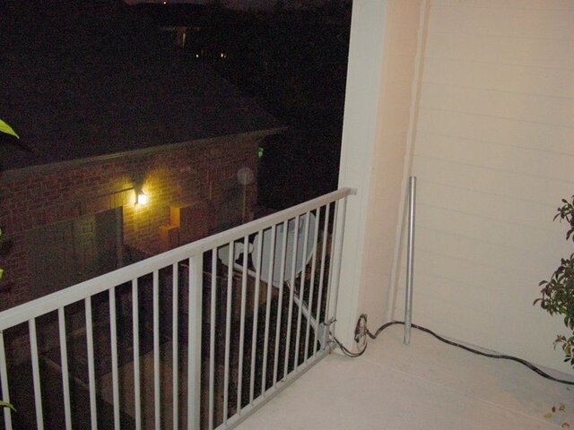

I took some pictures and I think I have a solution, I just hope the installer has no issues with it. I can put a 4' 1-5/8" post butted right against the metal railing which is pretty sturdy, doesn't move unless you really put heavy pressure on it. I will u-clamp it to the railing very tightly and he can simply mount an adapter to fit the 1-5/8" post, and put an arm on the end which will push the dish hopefully far enough outside the balcony to be where my current dish sits.
Here are some pictures of my current dish and placement of the pole (not the 4' pole but a temporary short one to show the placement)
1. First picture shows my current dish and how its mounted
2. Second picture, shows possible location one on the railing for the pole
3. Third picture shows another possible location for the pole

From the pics, looks like that will be close. Installer will verify. The 99 sat is 2 degrees to left of 101. Looks like the only thing holding your current dish up wire-ties…wow. Guess that is what you posted. So that's why they make all those dumb rules.
To the left darn, well I guess I will hope it clears barely!
I could have used some u-clamps for my current dish, I have in the past, but I saw one installer just use some thicker zip-ties once, and I have done several installations with the triple LNB dish with them, they are fairly strong, and I use like 10+ of them, it would take some one swinging off the Dish with their full body weight for it to potentially break.
About the antenna, I knew there was rule where I was for sure allowed, but they were not budging, and I had just moved in. My apartment is also right beside the front office and the front gate, so all potential renters would be seeing it when coming in, and I"m sure the management were fairly pissed about that lol.
So clamping that post to the railing is ok? Would the installer not install it like that possibly? (if the sats were all lined up of course).
Thanks
