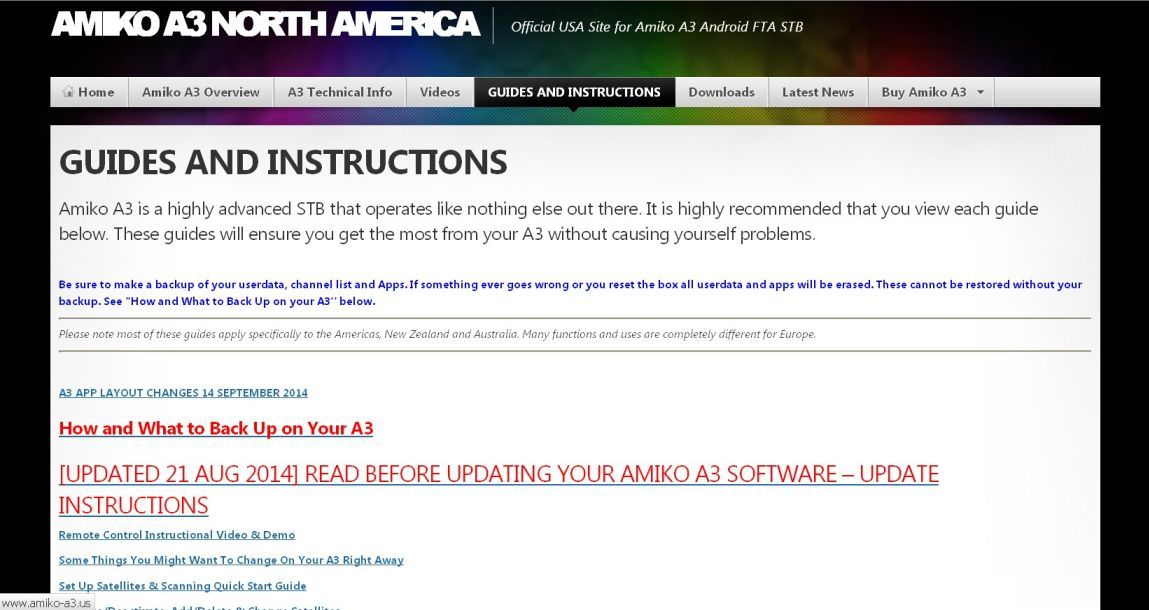

My A3 came with a Quick Start Guide and a sheet that stated "Please visit www.Amiko-A3.us for guides and instructions" as well as the FCC Part 15(b) compliance notice. Knowing I was going to receive the A3 I had already read and downloaded all the guides so I had some idea what should be done. I still went to the indicated web site and selecting "Guides And Instructions" and was greeted with this:
The very first thing I did was insert a microSD card into the A3 and make a full backup of the system and apps to it, just like the instructions say to do. I also made a backup to a USB flash drive just for insurance. As the web site says, the A3 does not operate like any other STB and I wanted to be sure I could start over if I screwed it up during setup.
