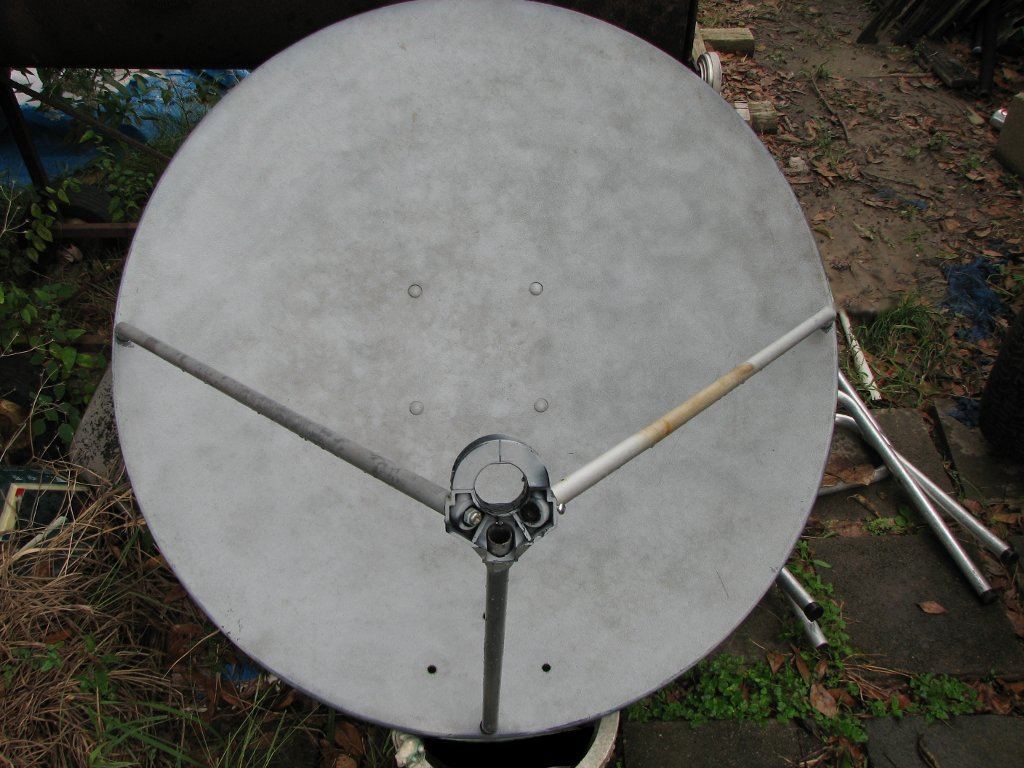

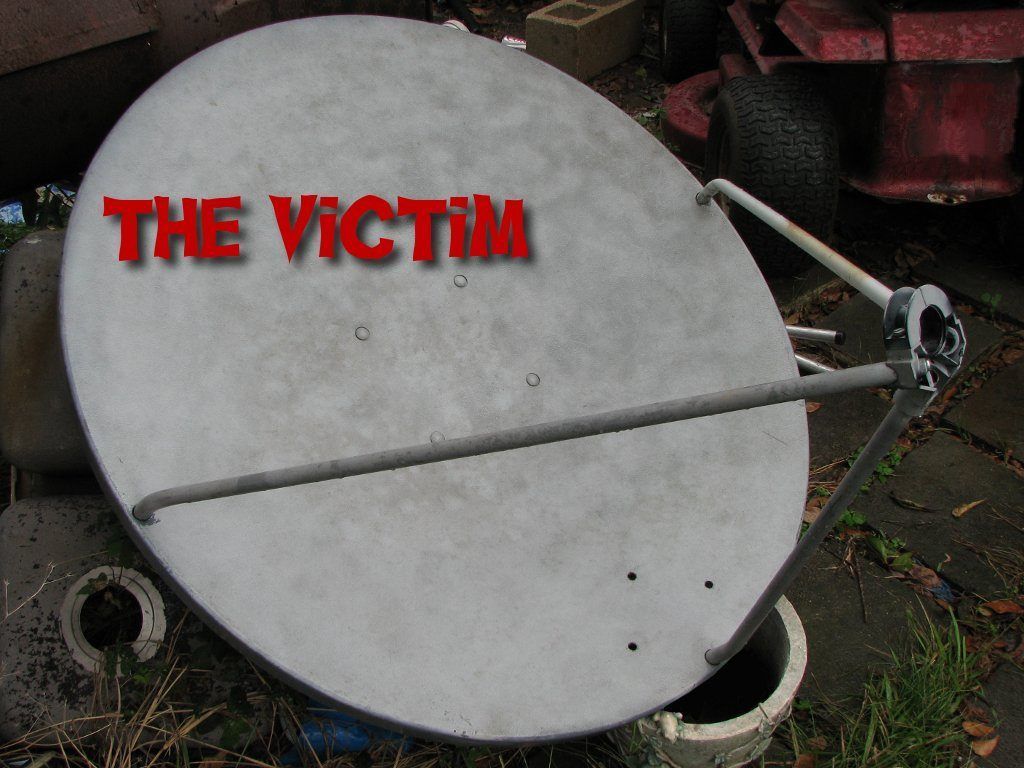

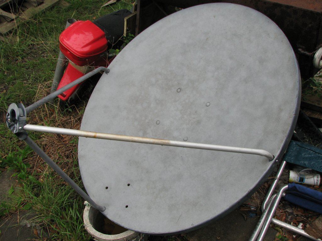

As noted in my previous post, I've been tweaking all night and all morning on Pepsi and Monster power drinks. :p
I went poking around in boxes, in the garage, in the shed, under the car, everywhere. Looking for stuff to make the BIG primestar work once again.
(Not that I remember it ever even being up before anyway :rolleyes: )

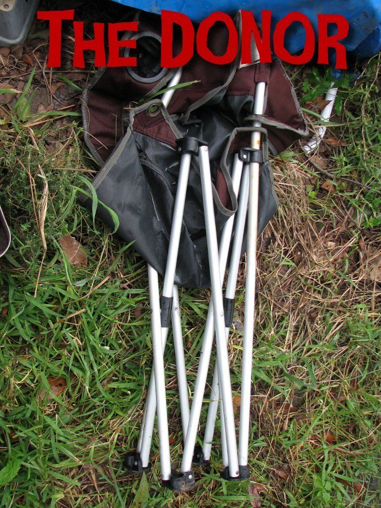

While I could NOT find any parts that would allow me to connect the dish to the motor, I DID find a donor part to replace the missing arm on the dish!
When I was in the shed aka the 60's travel trailer, I found an old folding camp chair that was all icky and chewed up by critters. Time for the trash. But, I noticed the tubes it was made of. Lots of little aluminum tubes that are like an accordion or something so the thing opens out into a chair or collapses into a small bundle for storage.
So I dragged it out to the deck and hosed it down. Then I went and got the one arm that I do have and compared them. Not only was it the same size around, one of the back legs of the chair was the exact right length for what I needed!
OMG!! So, being all full of caffeine, I proceeded to take the little camp chair AKA "the donor" apart and got the prize, the chair leg that would soon become a satellite dish arm. Yes, I was about to Frankenstein it into a new creature! :D
Muhahahahahahahaha!!!
So I took a chance. I figured it couldn't hurt. There are two of them in the chair, if I ruined one I would still have one left over that I could send over to dad for a more professional attempt at what I was about to try.
So I stuck the tube into a hole on the BBQ bit and began to bend it. Very slowly, very carefully. Bend a tiny bit, stop, check it against the good one, bend a little more, etc, repeat, etc...
After a lot of sweating and a little cursing, I finally ended up with a mangled up looking tube that LOOKED like it might just work after all! :D
So I fitted all the parts together to see and sure enough, it looked like it might work after all! I then got out my little cordless drill dad gave me and drilled some holes in the dish and through the tube then put some screws in to keep it from falling apart. UH OH!! It looks like it might just work!!
Well... Looks aren't everything, as they say. Will it work? I don't know. I can't really try it just yet, I don't have any way to put the monster beast up. But it looks OK. So I'll have to say, this is a BIG step towards getting the thing working. I was really concerned about that missing part. I knew without that there was no hope. Now that has been resolved and I can focus on the next part, finding a strong, light way to attach the dish to the motor.
That's going to have to involve help from dad. That's beyond my ability or skill level. Not to mention, I only have a few very basic little tools here for doing simple household repairs. Dad has all the tools in this universe and the other 10 universes. When dad dies we are going to bury him in a tool box. Really. It would make him very happy.
So anyway. Here's a few pictures of my latest Frankendish project.
Sheesh, I'm scaring myself with this stuff. I think I need to counter all this machinery stuff with a shopping spree. :eek: Just to reclaim my softer side ya know. ;)

Good fabbin, Dee. That dish should work like new! If I come out that way next week can you rebuild my transmission? LOL
Frankendish project:
Iceberg the moderator is always joking about using wood blocks, 'n hose clamps, and gets lots of things done.
The most entertaining reading on this forum, is seeing the creativity of the members!
Your Primestar arm is right up there with some of the best I've seen!
Damn! We're gonna have to make you our poster girl for DIY projects! - :eek:
So now, we don't want to hear you mumble, "I can't". There are projects a-waitin'!

I took a digital scale and put the entire dish including an lnb on it and it weighs out to 18.3 pounds or 8.3kg for those that are of the metric mindset.
Now of course there is no other stuff on the dish yet. There's no mounting stuff on the back at all. I would guess that another 5 to 10lbs will end up being added to it by the time it's all said and done. Wouldn't ya think? So I'm guessing anywhere between 25 to 30lbs total for the whole dish and it's mountings in the end.
Should that motor be able to move that? :confused:
Oh and just for fun, I put an lnb on it and took my birdog meter out and was able to find the galaxy satellite at 97, really fast and really easy, just holding the dish on the ground and aiming it by hand, no poles at all AND trying to go through heavy trees. The yard is flooded so I can't go out there for a few days yet.
I am very, very certain that if I went out and put the thing on a pole out away from the trees I would be able to find any satellite I wanted to. :D
So far this is starting to look pretty good. :D :D :D
