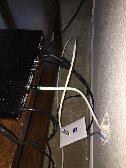

I then had him help me move the TV and SJ next to the wiring panel and we plugged the installers cable from outside directly into the SJ bypassing the home wiring. This actually seemed to work, the SJ stayed up and we didn’t see any issues. So the issue looks to be with the home wiring. We then move the TV and SJ to another outlet and hook it up, this one has the same issue as the original one. At this point I let the installer go as it seems the issue is only with the home wiring.
I then went around the house and plugged the SJ into the other RG6 outlets and it has the same issue in every one. It may work for a few minutes but will always disconnect from the HWS. I verified that the coax is 3ghz RG6 and the connections/barrels all look good. Finally I move the HWS to the other outlets and it has no issues on any of them; the SJ has the same issue even plugged into the outlet the HWS was originally using.

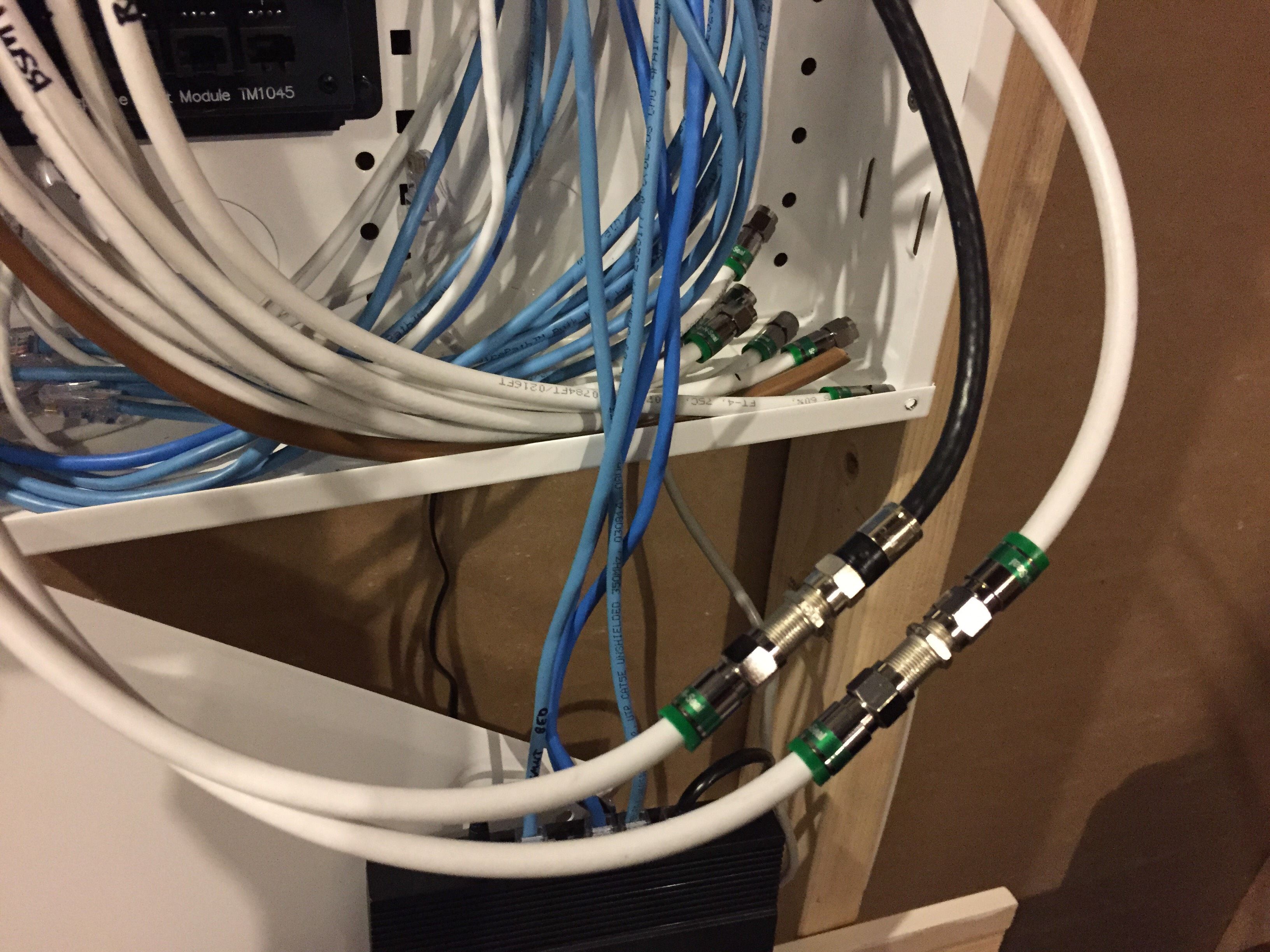

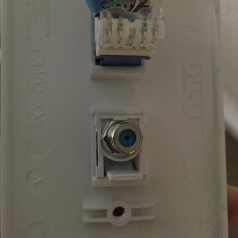

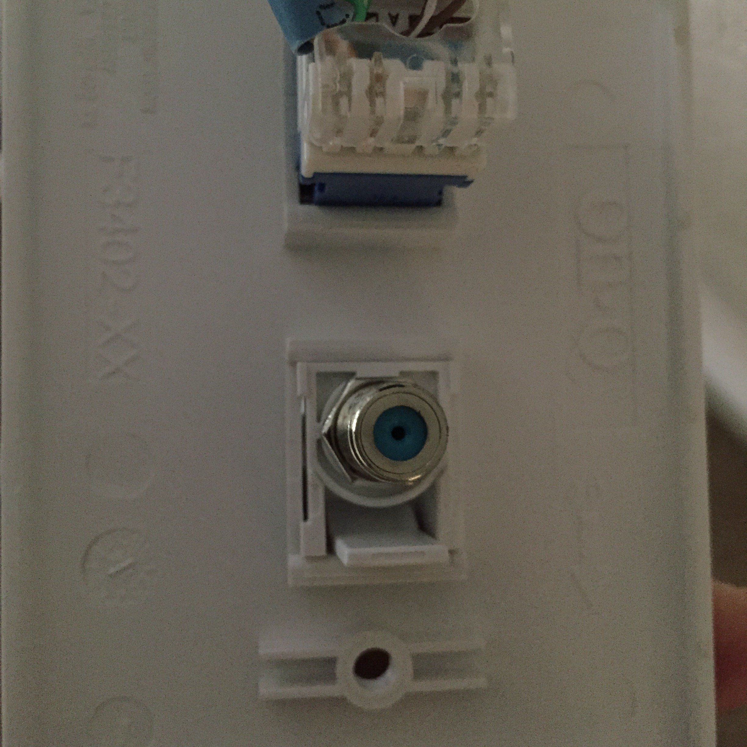

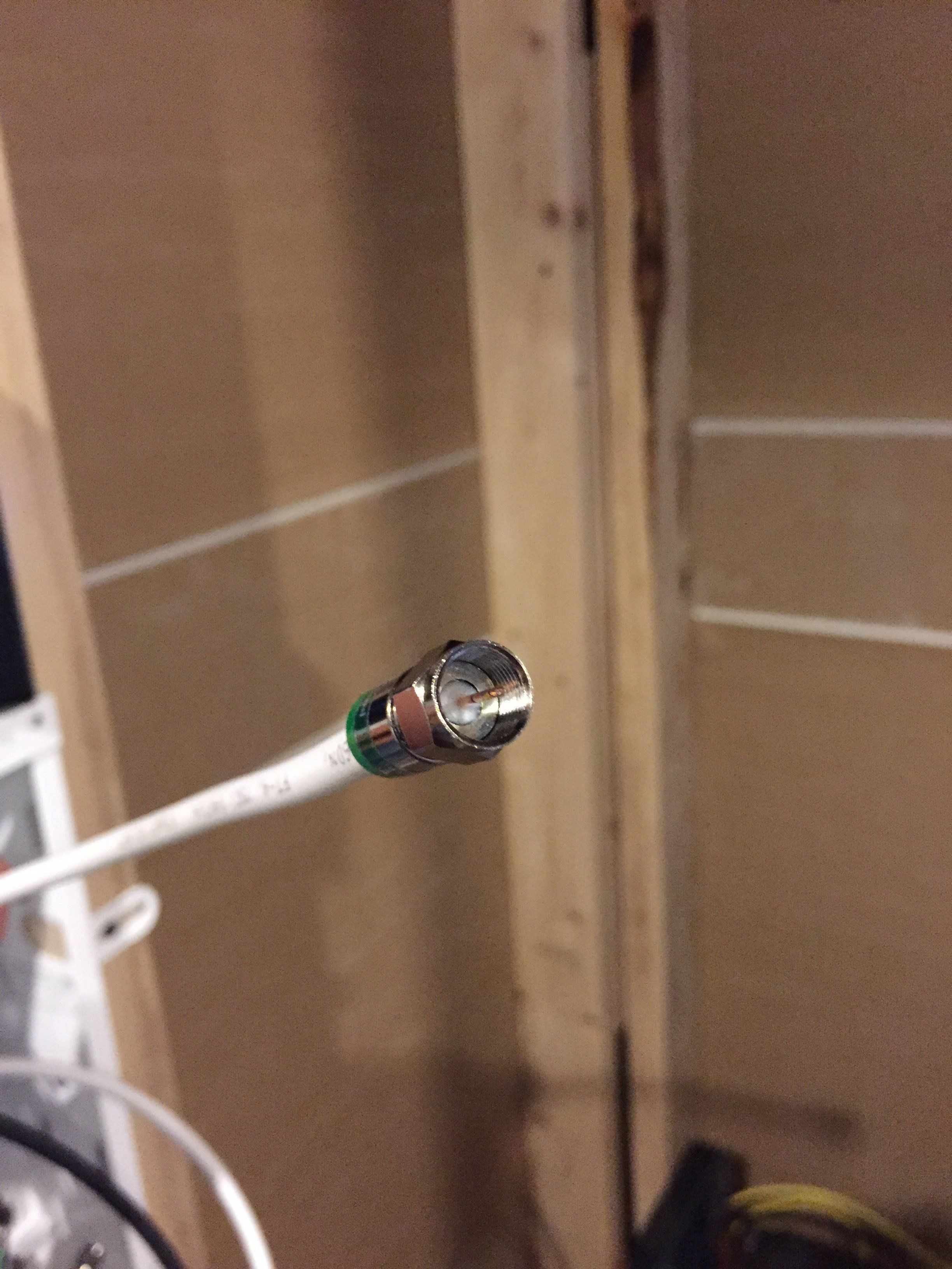

I have done a little more digging and was able to get the SJ working in the room closest to the patch panel when I bypass the barrel connector. I thought it was maybe the barrel connector, but the other outlets don't work when I bypass it.

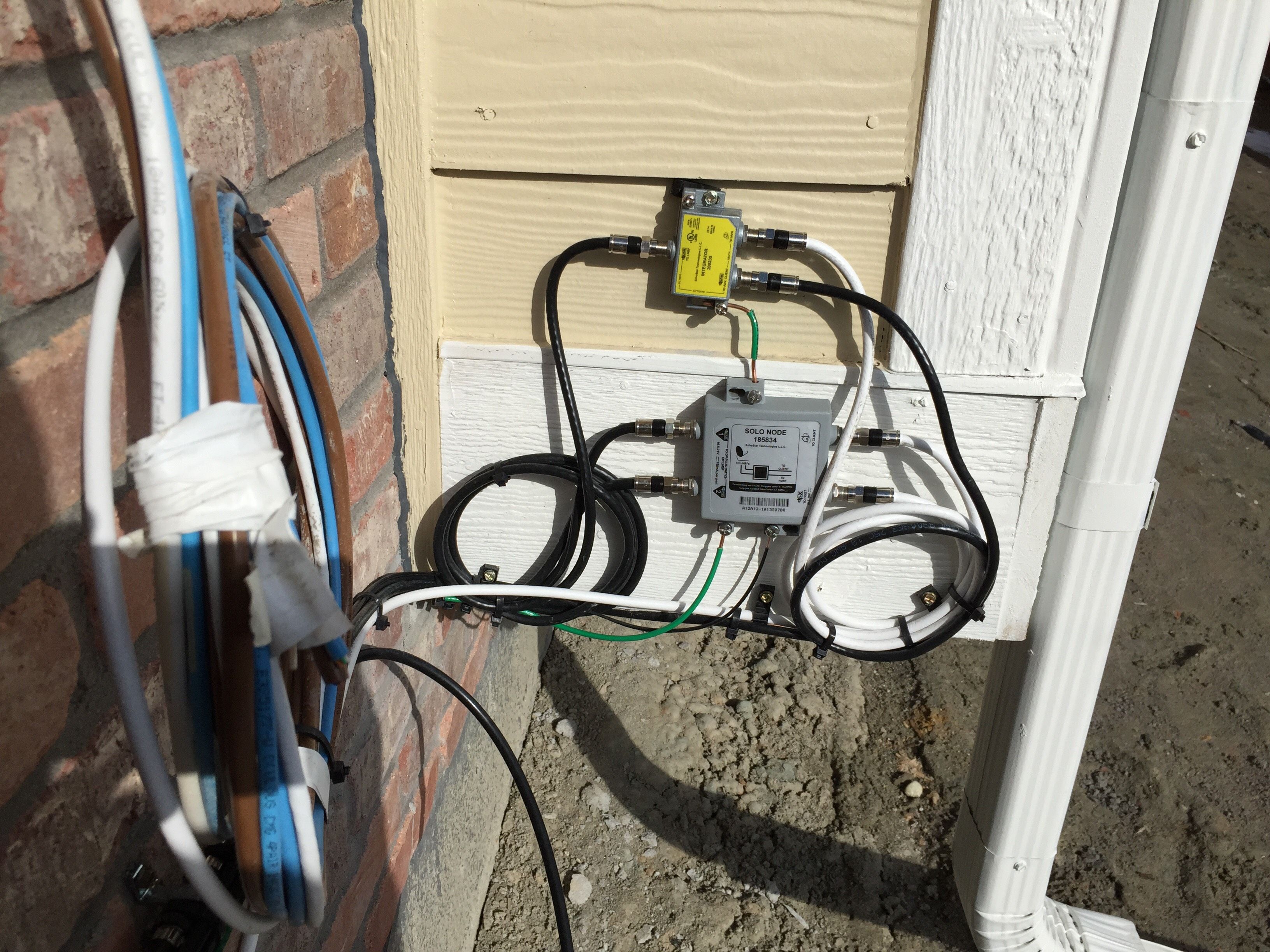

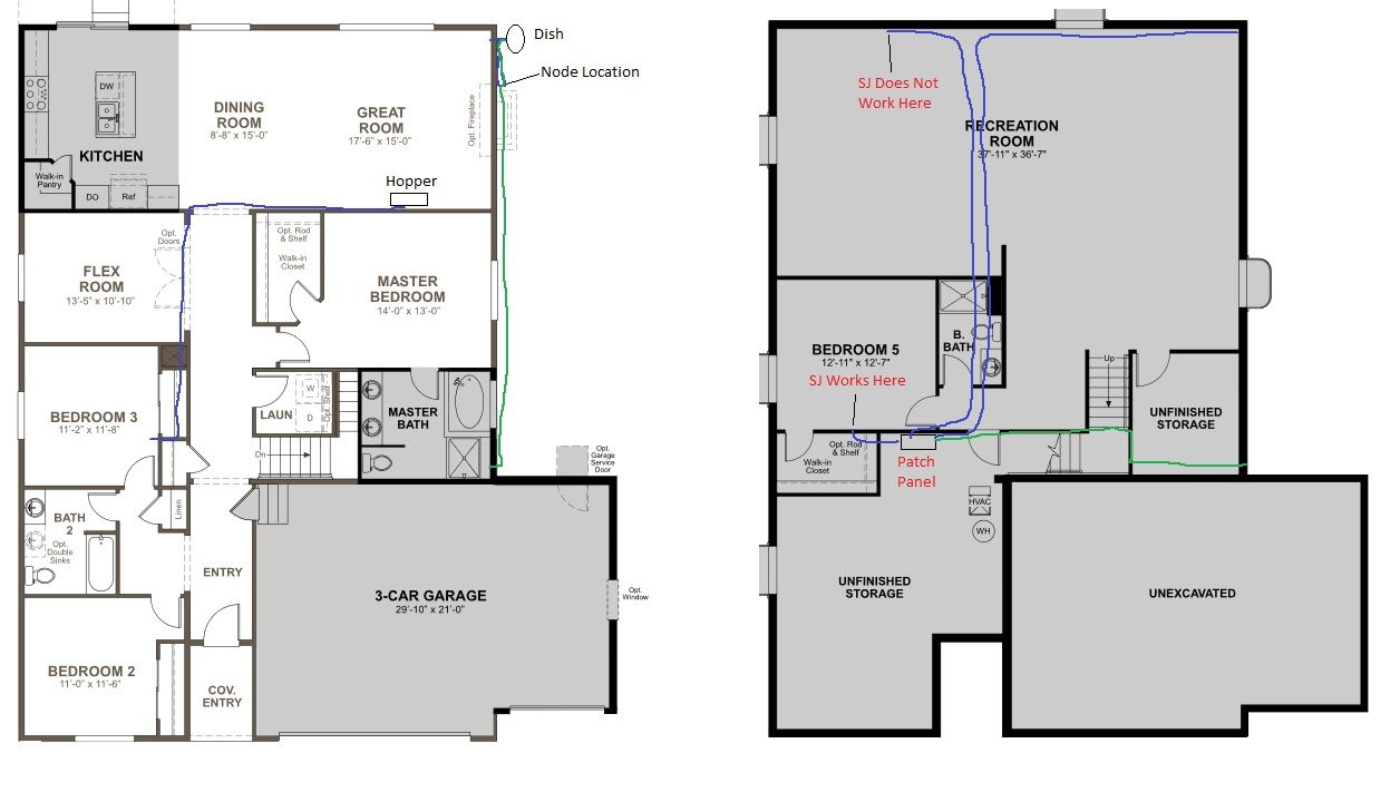

I took a closer look at the cabling and it looks like the builder used CCS RG6 for all the in-home wiring. I'm wondering if there is maybe just too much distance/too many connections for the CCS between the SJ and the Hopper. I don't have good measurements yet, but The Hopper is connected with CCS back to the patch panel (~85ft), then uses a barrel connector to go to another run of CCS out to the solo node (~60-70ft), the cabling from that point is all dish installed CCS back to the patch panel (~75 ft), then goes through another run of CCS to where the SJ is hooked up (this varies in length by room location).

Sounds like cable length issue between hopper and sj.
You can have the node and integrator inside by the patch panel, but it will need another line coming in.
Well, since your wiring apparently cannot handle a super Joey, either stick with regular, or, if you need more tuners, belly up two more dollars a month for another Hopper.

I'm also considering having them run more wires and just move the node inside by the patch panel, I think my distances would be fine then.
Would a signal amplifier also work in this situation? I've seen them but I'm honestly completely clueless as whether or not they would work in this scenario.
