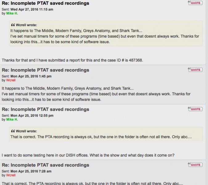

This is a real issue and it only involves ABC. I had this problem with an old Hopper and now still have the same problem with the H3! I reported this to their tech support forum back in April and they said that they would take a look at it. Still no resolution. Here are the facts:
1) The program is only messed up AFTER the program drops out of PTAT. The saved program and the PTAT program both work fine.
2) After the program drops off the PTAT, the saved program becomes time-shifted later by a random amount of time. So instead of all Modern Family, you get half and half Blackish.
3) It cannot be fixed by just saving 3 shows in a row (i.e., 8:30 to 10) just to capture the 9 PM show. Each separate show will have different cutoff points!
I am currently testing to see if it is a PTAT issue by turning off ABC in the PTAT. Now I need to wait a week to see if the recorded ABC shows have survived.
Here is the interaction with Dish, note there is a Case ID #:
