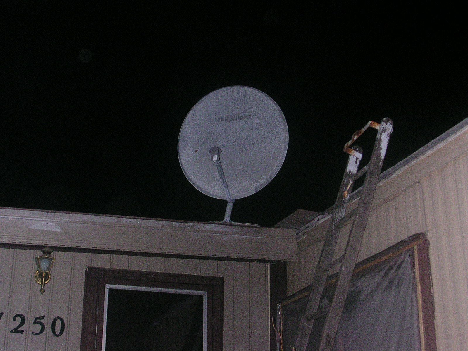

I was at a service call today to repoint a dish at Telstar 5 for a guy, he and his brother had been trying for WEEKS to find the signal using his Pansat 2500 and a TV. It was a pointing problem the whole time, the dish was mounted the wrong way round, the mast/pole was not plumb, and never could be made plumb the way it was on the roof, any chance of posting some pictures of your set up?

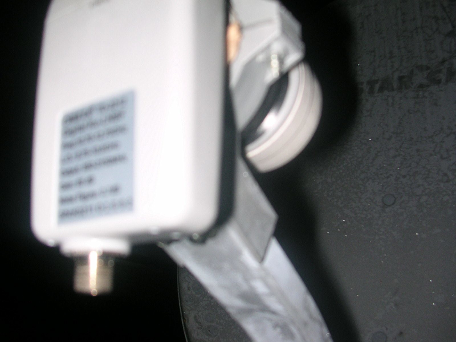

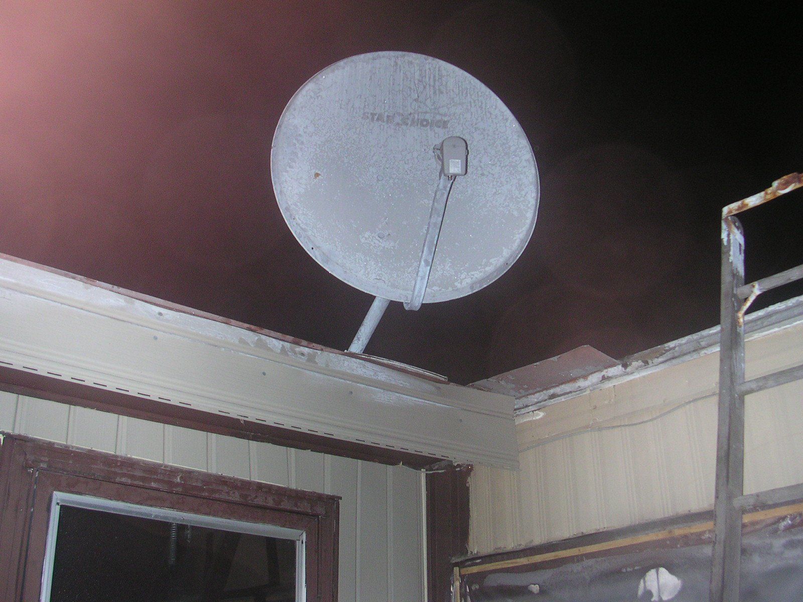

here are some pics

Hi Botherhood, I am a fellow Canadian that had nothing but trouble with getting Ku-band reception. But, it is like PSB said if you used 2 receivers and still got nothing, them it is a setup problem. I thought the same thing, but in fact it was the angle of my dish that was the problem. Also, it was thinking I was on one particular satellite, when in fact it was another. I had to trial and error frequencies of neighbouring satellite to see what i was really aming too and presto! Plus, the angle notches of the Fortec Star dish have been known to be off, so that didn't help me initially.
BTW, your dish seems a bit dirty. Is that just ice (being from Thompson Man., you have cold winters) or is it the way the the camera caught the dish?

I'm sure you have heard this many times, but double check that the mast is at 90 degrees. I have a Dish Network dish that I dismantled. Then I put the dish back up in the same place, but I had no signal. Everything looked straight up and down, and I knew I was pointing at a satellite, but no signal. I adjusted the mast angle slightly and BAM! I had 125% signal strength. The same thing happend when I installed my FTA dish. I mounted the dish to a board on the ground and could not get a signal. Then I bought a pipe, located a spot on the ground, installed the pipe so that is was straight up and down and level on both the vertical and horizontal axis, and I found quality signals with no problems.

AMC-4 is at 101° W., so you need to be pointing your dish over toward the 180-200° azimuth range. Use a compass to get a general idea where that is. Remember that the elevation marks on your dish and compass readings may be misleading: sometimes you'll need to turn your dish beyond, below, or above where you "think" the satellite should be...
(I noticed that one of your pictures shows a missing R-6 cable on your LNBF; I assume that's just because you had removed it... Silly me, if you are getting signal strength I guess that means the cable is indeed connected!)
