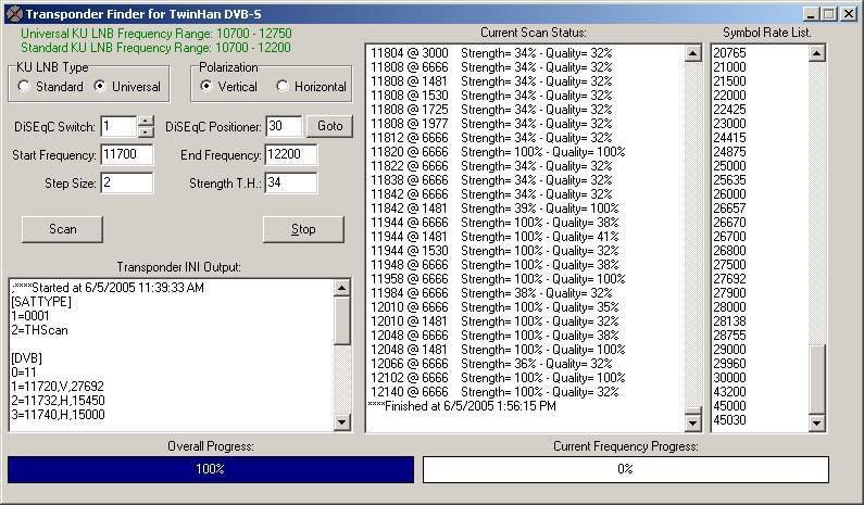

Something fun for TwinHan owners?
Cascade
Goose.
Jun 1, 2004
1,457
37.134004N 76.561779W
See pic.
Hey Hey - pseudo Blind scan :)
FWIW, I think the CoolSat uses a 'step size' of 8. I'm doing a detail scan right now and it's incrimnenting in .008 steps.

do we have any programers around here?
if so i have the source code for that little gem and have been trying to figure out how to make it faster..
that program as it sits.. take a long long long time to scan a full sat.
Attached is the source code for this program.. the guy that wrote it sad he did it in delphi and used the 2.5 sdk drivers..
  • THScan_and_Source.zip
Yep, 2 hours to scan one sat on the USB visionplus.
I'd love to see a version for the Nexus/Skystar.
As far as I can tell the only thing slowing it down is the changes in symbolrate.
Still, it's better than nothing I guess.

It's slow because of the hardware not the software.
The program is pretty basic, it just loops through all the frequencies trying the different symbol rates. The slow part is waiting for the Twinhan to lock the frequency settings that you are trying. There is no way to speed up the Twinhan.
