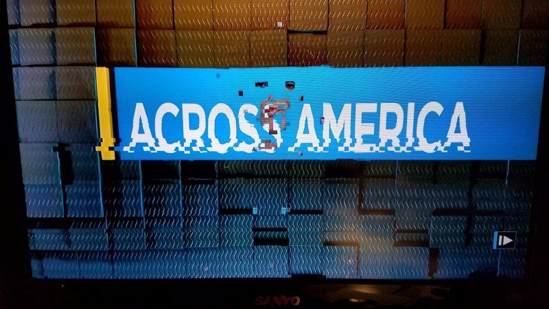

My breakups are not as bad as they were, but I'm still getting audio blips and occasional minor video stuttering.

The longer I watch the worse it gets. Video and audio breakups every second or two.
