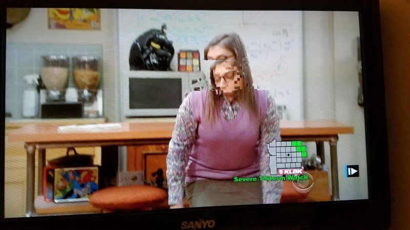

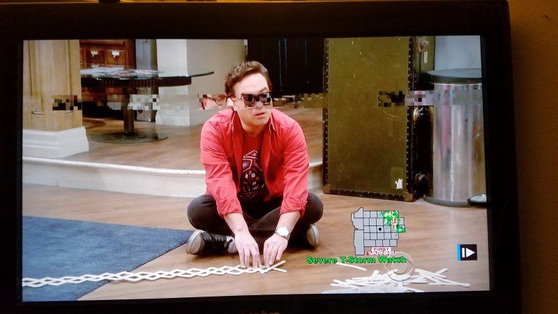

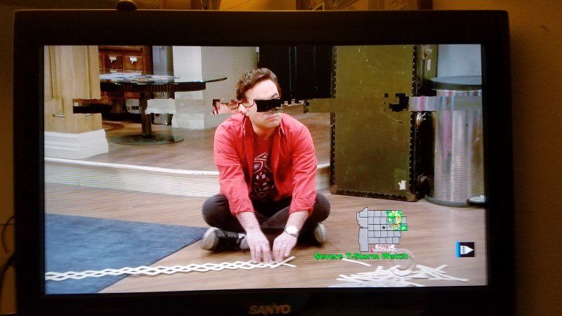

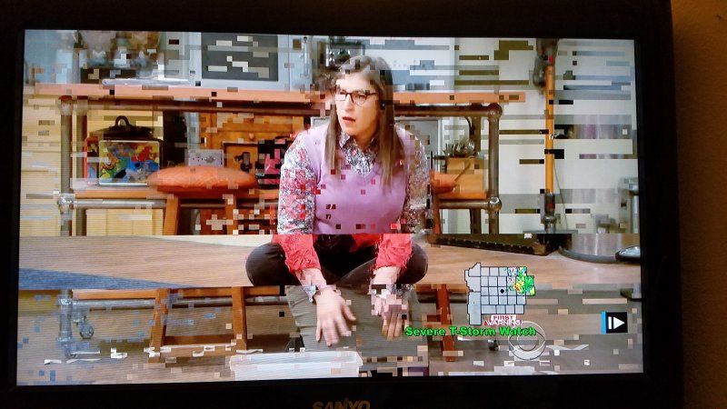

Here are 5 examples just photoed off CBS station OTA viewing from my Joey 2.0.
I have a single tuner Dish network OTA adapter that worked super fine on my old H2 but now has constant video and audio breakups on the H3.
I tuned the Hopper to the same OTA channel and the breakups did not stop.
