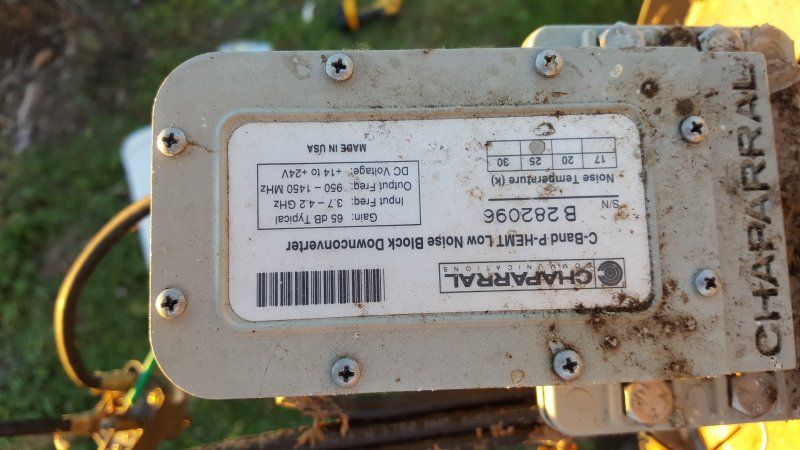

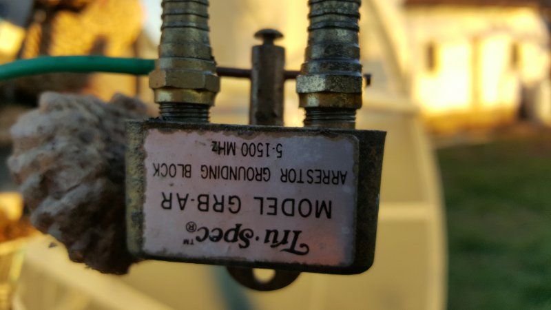

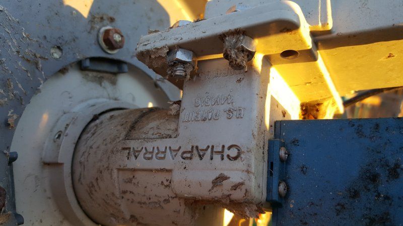

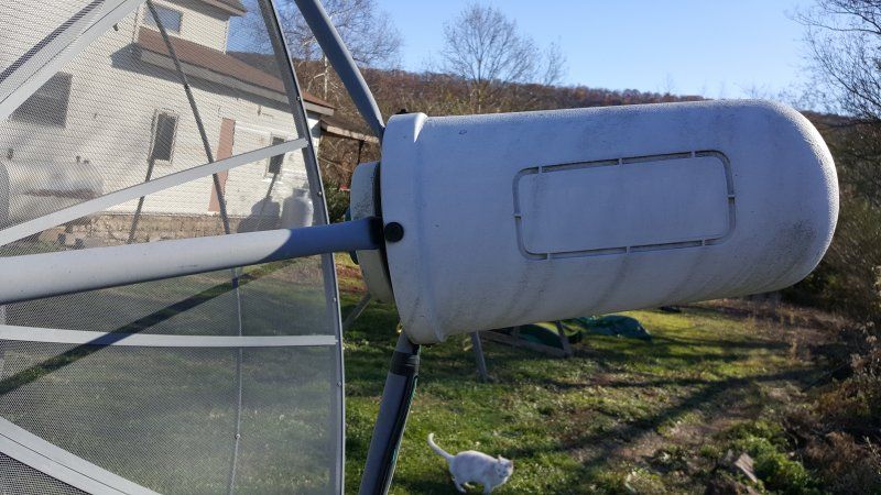

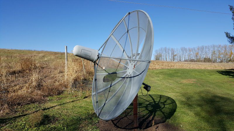

But here are the more important pictures that you guys can help me with. At this point I have no idea what I have or need. Next thing will be to take the motor end apart.

I can understand that.Its an 8 footer?..Winegard made a good dish...JMO I would contact ke4est,Titanium or Rick for a receiver and dish positioner...Keep it right here local rather than going over the pond. ...Worth going forward no doubt and a great hobby to boot.
Pull the cover off of the feedhorn throat and check for bee's nest in there too, often they go in there.
Looks like all of that should be usable, but that feed has a polorotor to switch polarity, the ASC1 is the only modern dish mover that can work with that. It might be worthwhile to just swap out the feed and LNB for a CIPLL to make things easier. I'd just eliminate that grounding block that's in there too.

The small blue box with three wires coming out of it on the back of your feedhorn is a polorotor, it's there to switch between horizontal and vertical transponders.
The problem with it is modern receivers can't control a polorotor, so you'll need either a old receiver, which won't be able to receive a lot of channels, or use a ASC1 dish mover, which is a nice unit, but costs about $150.
For between $25 - $60, you can buy a Titanium PLL LNBF that will work with modern receivers because it uses voltage to switch polarities instead of a polorotor and so eliminate the headache of the polorotor altogether. The PLL LNBF will also lock channels better than the DRO LNB you have now.

If you just want to see whats up there, i wouldnt see any problem with using the feedhorn and lnb you have but you need to figure out if it is horizontal or vertical (hopefully its horizontal as most of the strong transponders are horizontal if i remeber correctly), and use a 12v car battery to move the motor (after you test, clean and lube it up). I dont know what you will and wont get with an 8' dish as the first one i put up was a 10' but there is plenty for sure up there to watch. After you get a taste of what there is then you can make a decision from there how much you want to spend, and could do it in phases. Read the bud guide from fat air, and browse these forums to learn learn learn. Like i said in a previous post, i thought c-band was going to be a cake walk but boy was i wrong.

Just so you know, the actuator is upside down, the motor should be on top!
I will disagree with that statement. It may depend on the unit. If you look at one of my actuators you will find on the end or gearbox there are two drain holes for any water to drip out. If you put the motor on the top you would have two places for rain to run into the gear box. The other Thomson-Saginaw is just the opposite. The motor is up and the long shaft has a drain hole on the bottom as does the gear box.
