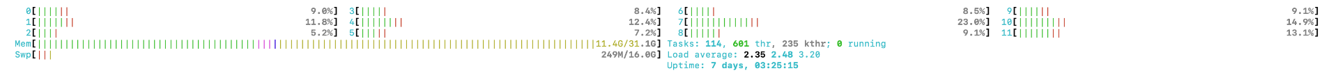

I am definately seeing it on the server. Our loads were around 0.50 and now they are in the mid 3's. Grr... I let Matt know.
Ok I restarted the web server and database server. I hope that helps. Have to run out again to Sams Club and get some things before the snow / ice storm comes in here.

You had a massive spike in traffic from Alibaba Cloud Network
Code:
47.82.10.249 - - [15/Feb/2025:11:19:55 -0500] "GET /xen/threads/the-un-official-missed-recordings-thread.209628/page-3 HTTP/1.1" 200 32906 "https://www.satelliteguys.us/xen/threads/the-un-official-missed-recordings-thread.209628/post-2216102" "Mozilla/5.0 (Windows NT 10.0; Win64; x64) AppleWebKit/537.36 (KHTML, like Gecko) Chrome/114.0.0.0 Safari/537.36 Edg/114.0.1823.43"
47.82.11.159 - - [15/Feb/2025:11:19:55 -0500] "GET /xen/threads/dishnow-problems-with-service-activation.166565/ HTTP/1.1" 200 37071 "https://www.satelliteguys.us/xen/threads/dishnow-problems-with-service-activation.166565/post-1723041" "Mozilla/5.0 (Windows NT 10.0; Win64; x64) AppleWebKit/537.36 (KHTML, like Gecko) Chrome/114.0.0.0 Safari/537.36 Edg/114.0.1823.43"
47.82.11.181 - - [15/Feb/2025:11:19:55 -0500] "GET /xen/threads/811-and-dvi.1924/post-13897 HTTP/1.1" 301 - "https://www.satelliteguys.us/xen/threads/811-and-dvi.1924/post-13897" "Mozilla/5.0 (Windows NT 10.0; Win64; x64) AppleWebKit/537.36 (KHTML, like Gecko) Chrome/114.0.0.0 Safari/537.36 Edg/114.0.1823.43"
47.82.11.173 - - [15/Feb/2025:11:19:55 -0500] "GET /xen/threads/analog-stations.2314/ HTTP/1.1" 200 33722 "https://www.satelliteguys.us/xen/threads/analog-stations.2314/post-17138" "Mozilla/5.0 (Windows NT 10.0; Win64; x64) AppleWebKit/537.36 (KHTML, like Gecko) Chrome/114.0.0.0 Safari/537.36 Edg/114.0.1823.43"
47.82.11.45 - - [15/Feb/2025:11:19:55 -0500] "GET /xen/threads/new-guy-811-question.34320/post-310098 HTTP/1.1" 301 - "https://www.satelliteguys.us/xen/threads/new-guy-811-question.34320/post-310098" "Mozilla/5.0 (Windows NT 10.0; Win64; x64) AppleWebKit/537.36 (KHTML, like Gecko) Chrome/114.0.0.0 Safari/537.36 Edg/114.0.1823.43"
47.82.10.120 - - [15/Feb/2025:11:19:55 -0500] "GET /xen/threads/questions-about-the-new-xip-receivers.254573/page-21 HTTP/1.1" 200 42289 "https://www.satelliteguys.us/xen/threads/questions-about-the-new-xip-receivers.254573/post-2648244" "Mozilla/5.0 (Windows NT 10.0; Win64; x64) AppleWebKit/537.36 (KHTML, like Gecko) Chrome/114.0.0.0 Safari/537.36 Edg/114.0.1823.43"
47.82.11.27 - - [15/Feb/2025:11:19:55 -0500] "GET /xen/threads/playboys-first-non-nude-issue-is-an-ode-to-snapchat.357472 HTTP/1.1" 301 - "https://www.satelliteguys.us/xen/threads/playboys-first-non-nude-issue-is-an-ode-to-snapchat.357472" "Mozilla/5.0 (Windows NT 10.0; Win64; x64) AppleWebKit/537.36 (KHTML, like Gecko) Chrome/114.0.0.0 Safari/537.36 Edg/114.0.1823.43"
47.82.8.31 - - [15/Feb/2025:11:19:55 -0500] "GET /xen/threads/denver-market-kmgh-abc-audio-sync.80132/post-863773 HTTP/1.1" 301 - "https://www.satelliteguys.us/xen/threads/denver-market-kmgh-abc-audio-sync.80132/post-863773" "Mozilla/5.0 (Windows NT 10.0; Win64; x64) AppleWebKit/537.36 (KHTML, like Gecko) Chrome/114.0.0.0 Safari/537.36 Edg/114.0.1823.43"
47.82.11.181 - - [15/Feb/2025:11:19:55 -0500] "GET /xen/threads/mirror-tvs-with-a-joey.280084/post-2812235 HTTP/1.1" 301 - "https://www.satelliteguys.us/xen/threads/mirror-tvs-with-a-joey.280084/post-2812235" "Mozilla/5.0 (Windows NT 10.0; Win64; x64) AppleWebKit/537.36 (KHTML, like Gecko) Chrome/114.0.0.0 Safari/537.36 Edg/114.0.1823.43"
47.82.9.227 - - [15/Feb/2025:11:19:55 -0500] "GET /xen/threads/lets-get-a-list-of-receivers-where-dolby-digital-does-not-work.7360/page-2 HTTP/1.1" 200 39553 "https://www.satelliteguys.us/xen/threads/lets-get-a-list-of-receivers-where-dolby-digital-does-not-work.7360/post-93714" "Mozilla/5.0 (Windows NT 10.0; Win64; x64) AppleWebKit/537.36 (KHTML, like Gecko) Chrome/114.0.0.0 Safari/537.36 Edg/114.0.1823.43"
47.82.9.195 - - [15/Feb/2025:11:19:55 -0500] "GET /xen/threads/home-media-center-update.32851/post-301809 HTTP/1.1" 301 - "https://www.satelliteguys.us/xen/threads/home-media-center-update.32851/post-301809" "Mozilla/5.0 (Windows NT 10.0; Win64; x64) AppleWebKit/537.36 (KHTML, like Gecko) Chrome/114.0.0.0 Safari/537.36 Edg/114.0.1823.43"
47.82.11.45 - - [15/Feb/2025:11:19:55 -0500] "GET /xen/threads/can-r10s-2nd-tuner-signal-be-sent-to-other-tvs.23407/ HTTP/1.1" 200 29755 "https://www.satelliteguys.us/xen/threads/can-r10s-2nd-tuner-signal-be-sent-to-other-tvs.23407/post-201317" "Mozilla/5.0 (Windows NT 10.0; Win64; x64) AppleWebKit/537.36 (KHTML, like Gecko) Chrome/114.0.0.0 Safari/537.36 Edg/114.0.1823.43"
47.82.10.225 - - [15/Feb/2025:11:19:55 -0500] "GET /xen/threads/thinking-of-switching.218488/reply HTTP/1.1" 200 18699 "https://www.satelliteguys.us/xen/threads/thinking-of-switching.218488/reply" "Mozilla/5.0 (Windows NT 10.0; Win64; x64) AppleWebKit/537.36 (KHTML, like Gecko) Chrome/114.0.0.0 Safari/537.36 Edg/114.0.1823.43"
47.82.10.120 - - [15/Feb/2025:11:19:55 -0500] "GET /xen/threads/unauthorized-sears-promotion.12172/ HTTP/1.1" 200 29327 "https://www.satelliteguys.us/xen/threads/unauthorized-sears-promotion.12172/post-111243" "Mozilla/5.0 (Windows NT 10.0; Win64; x64) AppleWebKit/537.36 (KHTML, like Gecko) Chrome/114.0.0.0 Safari/537.36 Edg/114.0.1823.43"
47.82.11.115 - - [15/Feb/2025:11:19:55 -0500] "GET /xen/threads/my-hr-20-100-crashed-got-a-14-861-message.260845/ HTTP/1.1" 200 32145 "https://www.satelliteguys.us/xen/threads/my-hr-20-100-crashed-got-a-14-861-message.260845/latest" "Mozilla/5.0 (Windows NT 10.0; Win64; x64) AppleWebKit/537.36 (KHTML, like Gecko) Chrome/114.0.0.0 Safari/537.36 Edg/114.0.1823.43"
47.82.11.57 - - [15/Feb/2025:11:19:55 -0500] "GET /xen/threads/return-lnb.222063/ HTTP/1.1" 200 29648 "https://www.satelliteguys.us/xen/threads/return-lnb.222063/post-2279534" "Mozilla/5.0 (Windows NT 10.0; Win64; x64) AppleWebKit/537.36 (KHTML, like Gecko) Chrome/114.0.0.0 Safari/537.36 Edg/114.0.1823.43"
47.82.10.165 - - [15/Feb/2025:11:19:55 -0500] "GET /xen/threads/problems-with-wow-and-at-t-u-verse.146539/ HTTP/1.1" 200 31827 "https://www.satelliteguys.us/xen/threads/problems-with-wow-and-at-t-u-verse.146539/post-1499098" "Mozilla/5.0 (Windows NT 10.0; Win64; x64) AppleWebKit/537.36 (KHTML, like Gecko) Chrome/114.0.0.0 Safari/537.36 Edg/114.0.1823.43"
Count of requests by hour:
Code:
[root@cloud domlogs]# awk '
function ip_to_int(ip) {
    split(ip, octets, ".")
    return (octets[1] * 16777216) + (octets[2] * 65536) + (octets[3] * 256) + octets[4]
BEGIN { FS=" "; }
    ip = $1
    ip_int = ip_to_int(ip)
    if ((ip_int >= ip_to_int("47.74.0.0") && ip_int <= ip_to_int("47.87.255.255"))) {
        match($4, /\[([0-9]+\/[A-Za-z]+\/[0-9]+:[0-9]+:[0-9]+)/, time)
        split(time[1], t, ":")
        minute = t[1] ":" t[2]  # Extract "DD/Mon/YYYY:HH:MM"
        count[minute]++
END {
    for (m in count)
        print m, count[m]
}' satelliteguys.us-ssl_log | sort
