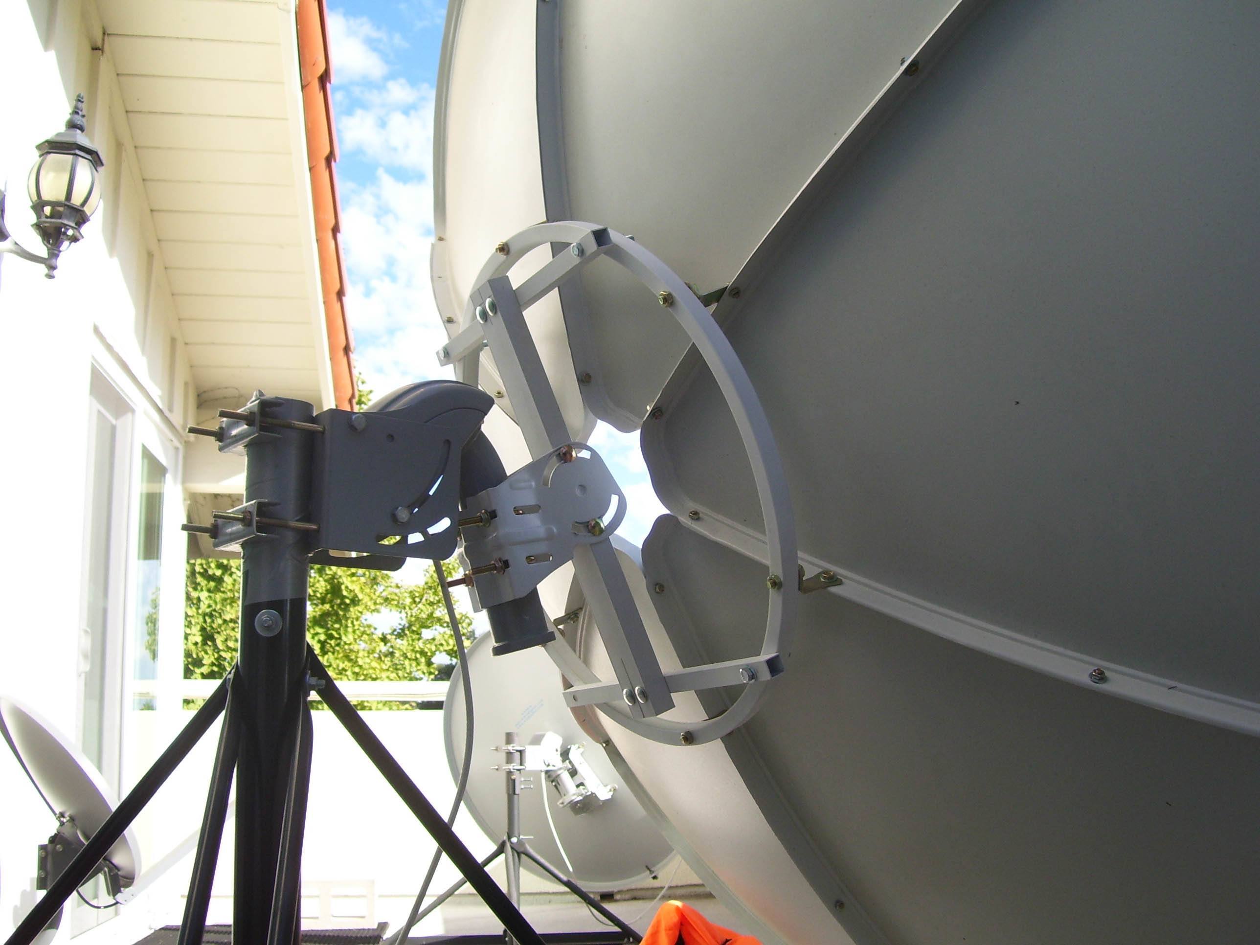

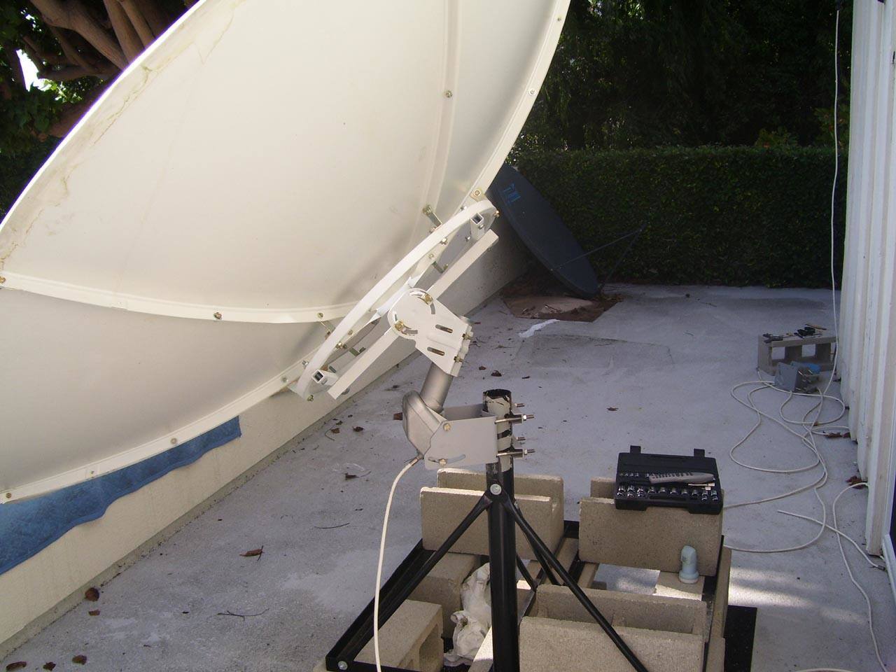

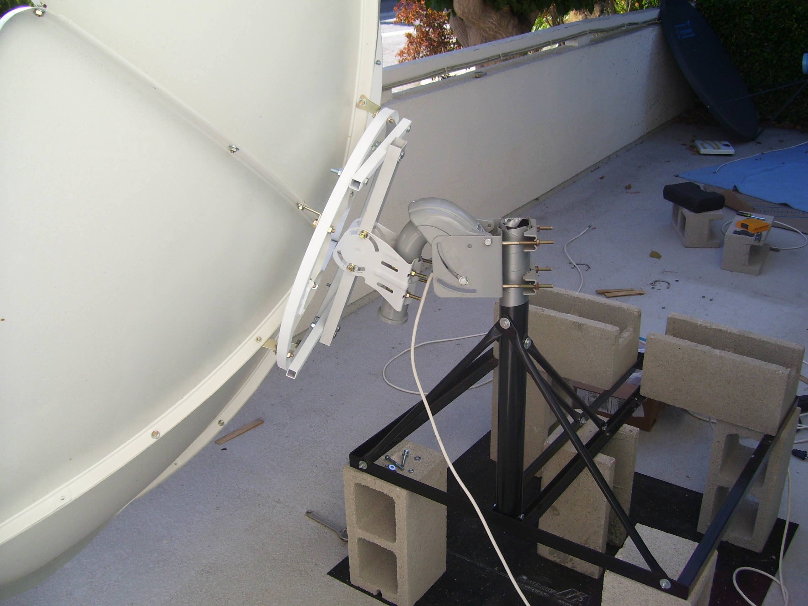

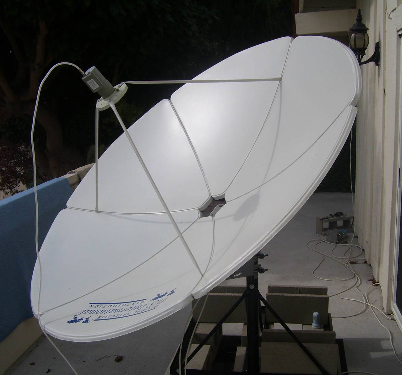

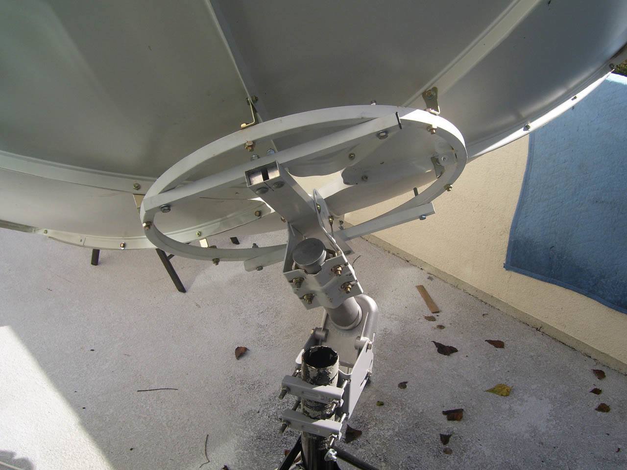

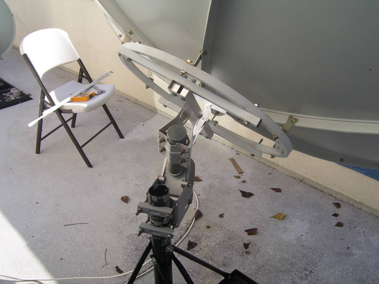

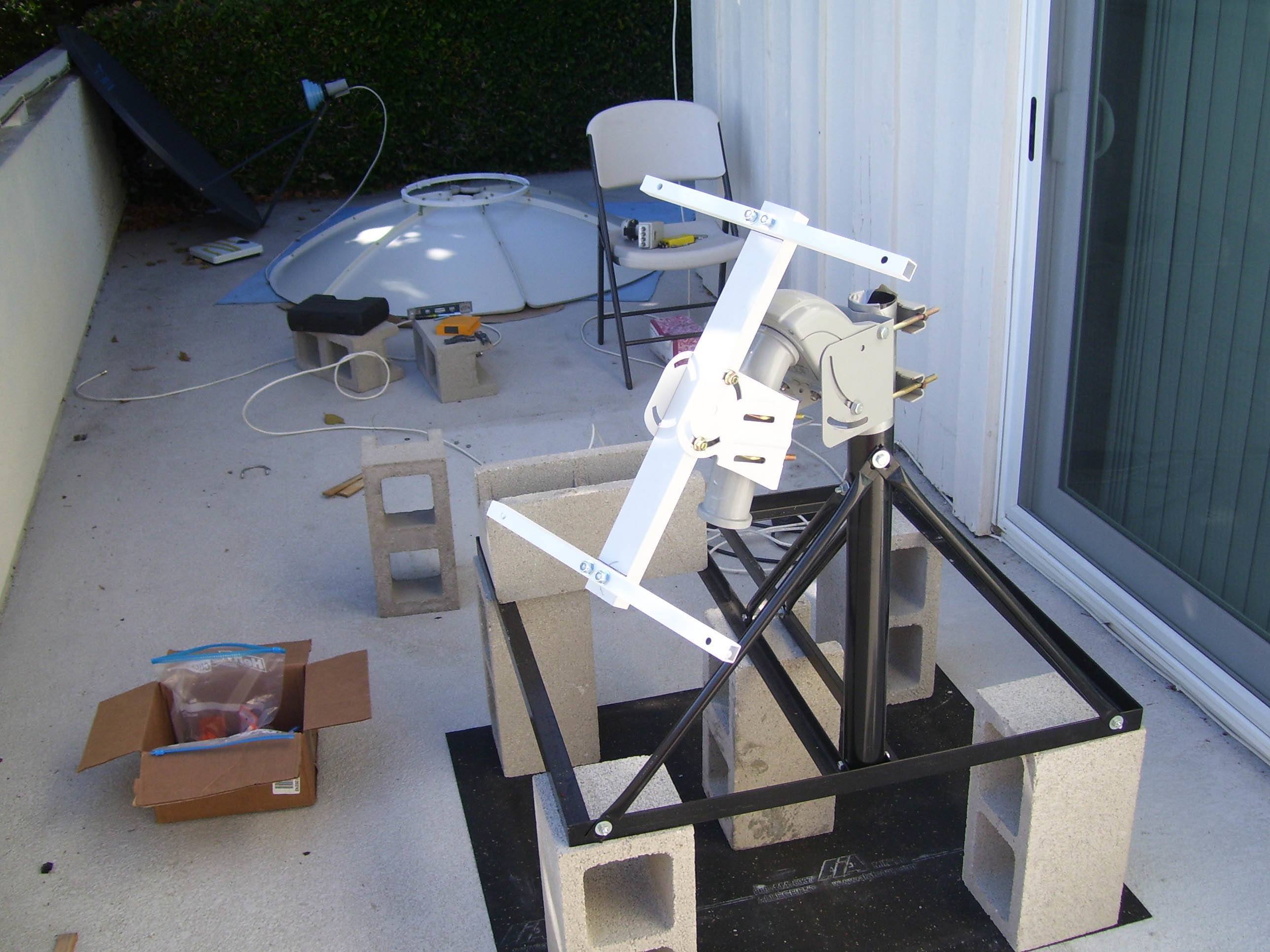

Well if you are looking for a project here is what can be done if you really want to try ...
As mentioned above, it still works so I haven't modified bracket for 9120 but hopefully this summer.

mr3p, very nice pictures. I was thinking about something to that effect. After looking at those picture, my SG2100 motor looks too much under powered for the size of the "bargain" dish. It seems that the wind factor will be too much for the setup, specially down here in hurricane alley. It is still a good idea, but with a heavier different type of motor. I have not given up yet. Will check into the 9120.
Thanks for sharing the pictures.
