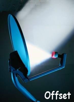

Before you start chopping down trees...remember we are using offset dishes and not prime focus dishes. Offset dishes will fool you as to exactly where the signal is coming from. See the attached pic:
