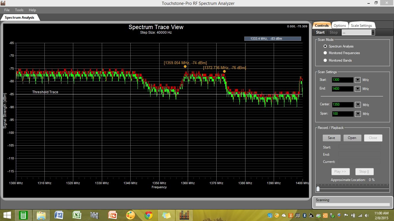

Next, removed the RG/6 cable from the STB and hooked it into a Channel Master CM-1007A satellite finder. This powers the LNB and also allows you to change polarization and LO frequencies. So I set the meter on 13v (vertical polariz) and turned on the 22 KHz tone to select the 10600 LO (am using a Universal LNB 9750/10600). Then, attached the dongle to the output of the meter and scanned 1300 - 1400 MHz. See pic below. Not too encouraging, but there appears to be a wide flat peak between 1359 and 1372 MHz. The center would be around 1364 MHz. If you add the LO frequency of 10600 to that it would be around 11964, the downlink frequency for TPAI/TVGE.

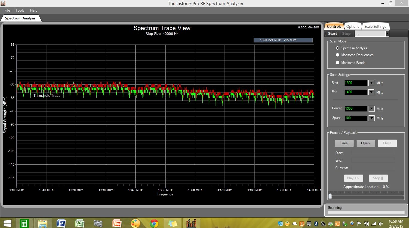

I could be way off base here. But just to confirm, I shut off the 22 KHz tone and the peak disappeared. See next pic.

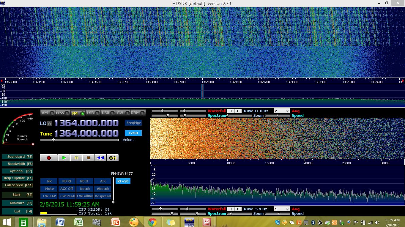

Last thing done was to start up HDSDR and look at what 1364 MHz is like on the dongle alone. See pic. Don't know how to interpret this, but definitely shows some transmissions on this frequency. Many narrow band signals. (See third pic). And if you tune below 1350 MHz or above 1372 MHz the signal slowly disappears. So this transponder signal appears to be about 22 MHz wide. Again, just to be sure it was a legit signal, I turned off the 22 KHz signal and the waterfall went blank - see fourth pic which shows upper half of waterfall (22 KHz on) and lower half of waterfall (0 KHz).

11964 is a QPSK with a symbol rate of 14714. That carrier appears to be about that wide. Notice the large carrier below? That carrier is TP frequency 11920, a 8psk with a symbol rate of 45000. You should note that that carrier extends down to approximately 11895MHz. The carrier to the right is probably a feed as TP frequency 12044, a 8psk has a symbol rate of 45000 and the low freqency of the carrier would be around 12020 (above the current frequency range of the spectrum scan).
