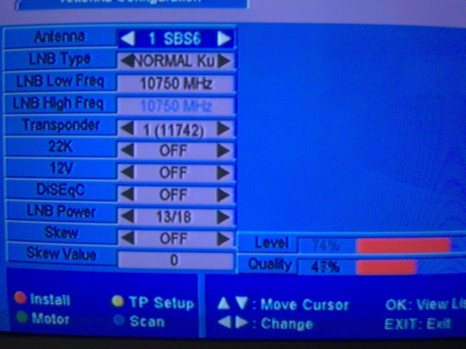

Here is what the screen looks like for the 3688 LNB setup...yes there is quality there because its slaved. If I power off the Pansat (via the switch) the quality goes to zero (even though the dish is still at SBS6)

I am starting to think you have a bad reciever, it sounds as if you are doing everything right..............
Not looking good but for the hell of it I would turn on the 12v, skew and 22k just to see if it had any effect. If your adventurous check that power cable inside with a volt meter on mine the voltages are labled. As a last resort maybe pick up an old el cheapo analog c/ku reciever on fleabay and let it power the lnb.
