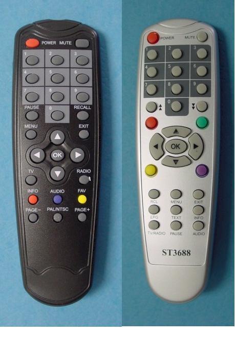

Updated to 3688 and I like the menus better then the 3618's. Although the 3618's remote works, it lacks the TV/RADIO and AUDIO keys.
If anyone who has an original 3688 Remote and switched to 3618, and wants to straight up trade (my 3618 remote for your 3688 remote) send me a PM please. Mine is brand new condition, and I hope yours is in near new cond.
