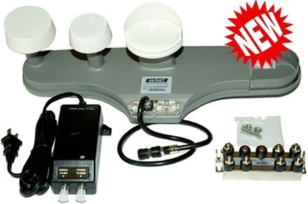

Direct TV uses SWM which sounds to be the same concept. More advanced in my opinion is the new Optical LNB by Invacom that uses Fiber Optics as a transmition line. It also allows for so many receivers (I do not remember hiw many but a matrix of 32 sounds familiar) to be conected to an LNB. Very usefull in MDU distributions (ie buildings). check Tele Satellite magazine for more info, the past issue had an article on it.
Since you referred to SWM (Single Wire Multiswitch) technology, this thread about optimal Sat System design is a good fit to give more info about it, which can be found at SWM8 FAQ and weaKnees SWM Equipment sites.
"SWM Single Wire Multi-Switch, provides DIRECTV programming from all current and future Ka/Ku satellites via a single RG-6 coaxial cable run to a simple splitter. Then only one line is required from the splitter to each receiver."
