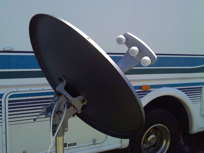

There is a western arc LNBF made specifically for the 1000.4. I have both arc LNBF's for my 1000.4 and switch as needed depending on my location and/or aiming needs.
Here's my 1000.4 with the western arc LNBF installed:

Thanks. Is it called 1000.5?
I haven't seen it labeled that way, but I bought it as an eastern arc 1000.4 and just added the western arc LNBF to the order. Both LNBF boxes were labeled for the 1000.4. The 1000.2 is commonly used for either arc LNBF with the same dish number though, so I never gave it a thought until you mentioned it.
Reactions: charlesrshell
It sure has gotten confusing since the LNBs started getting mixed around. I think the 1000.4 reflector is prettier and that there screw elevation fine tuning adjustment rod looks awesome to me.

When I bother to break down the 1000.4 by just removing the four wingnuts and screws holding the reflector, the two pieces are easily stored in a bin along with the folded tripod, spare LNBF's, extra coax cables, and a bunch of unrelated stuff. Most of the time, I just pop the dish assembly off the tripod and stow it in the back of the towed car along with the tripod until we reach our next stop.
The 1000.4 screw rod adjustment is for the elevation not the skew, but I guess you don't move around much if you haven't had to adjust the skew in all those years. Where we are right now, just changing from the EA to the WA would mean a 40 degree skew change. And when we hit southern Florida in a few weeks, the skew settings will again be entirely different from our current location for either arc.
We don't have any immediate plans to switch to an H3, but I would have no problem using a DPH42 to maintain our current 1000.4 setup. We do find it useful at times to have access to the EA 77 sat, if for no other reason. Then again, there is a simple mod that adapts a DPH LNB to work with a 1000.4 dish if I wanted to go that route.
I agree with the ability to fine tune being the best part of a .4. Just like on an International dish, I can fine tune all 4 sats to maximum peak, and not just by elevation, but fine tuning the azimuth, also, whereas with a .2, you do the best you can but I always think in the back of my mind, how it COULD be better if I could fine tune it
