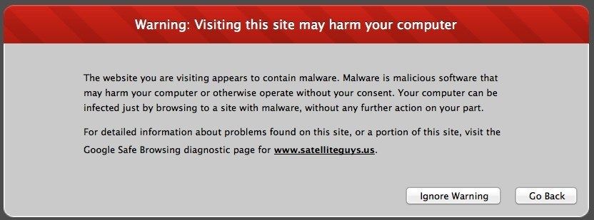

Keep getting it on Safari ( 6.0.2) if that helps??
Looks like some other sites including DBS are having the same issue and none of them can clear the error.
It only appears to be a firefox issue. Google Chrome (which uses the same database) is not reporting anything.
