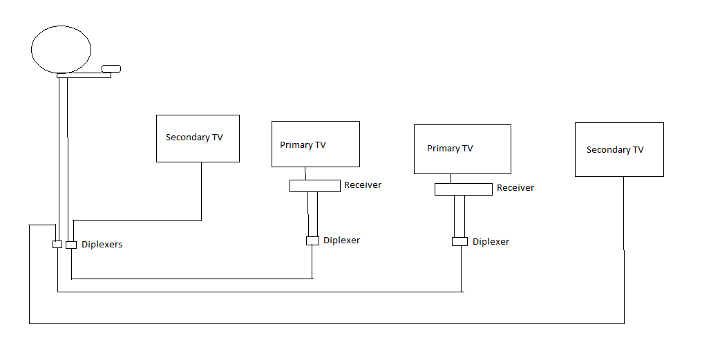

As mentioned on the hopper forum ( bad post, asked to delete), I have 2 receivers that are supposed to send signal to 2 other TV's without receivers.
The cables were disconnected during a remodel. Now we have service on the 2 receivers physically connected to 2 TV's but not to the other 2 remotely.
MY question is: Do the other TV's need to be connected to the 2 cables coming from the dish through a splitter in order to get that signal?
Thanks!
Mark
How is your house wired? Do the cables from your dish go into a utility room? You should have a cable coming from the TV2 output of the receiver and going to the secondary TV. The are a few ways to accomplish this but I would need to know more info about your setup.
The TV2s must be connected by coaxial cable, but not directly from the dish. There should be a coaxial cable connected to the "HOME DIST" jack of the receivers. If there isn't, there used to be.
We need to know if there is a small device that looks like a splitter but is labeled either "diplexer" or "triplexer" behind the receiver. If not, there should be a coaxial cable running between the receiver and TV2.
Photos are likely to be an imperative at some point.
Always ask before something like this happens as opposed to after when the evidence of how things were hooked up has been destroyed. It is much easier to advise when you can see what we're talking about before it is all ripped apart.
Those are the diplexers (on the dish end).
The open leg of each diplexer needs to be connected to a coaxial cable that runs to the corresponding TV2. While they used to be connected, you're on your own to figure out where the coaxial cables got to and which coaxial cable goes to which TV2.
If the cables cannot be located or have been damaged/destroyed, you'll have to run new ones.
Dual Tuners Diplexed.pngI believe this is what you have and how it needs to be hooked up. I hope it's not to complicated to look at.
