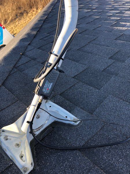

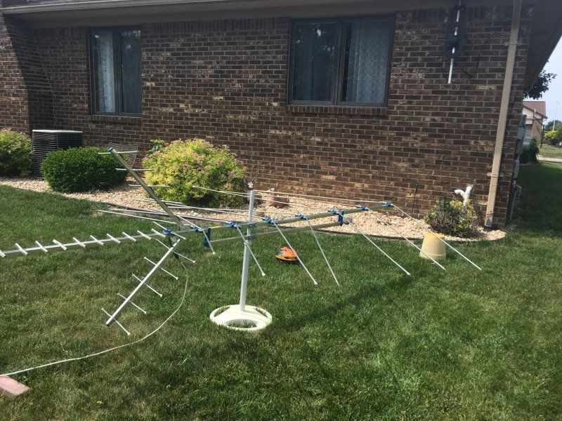

I have the ANT751R. It is a solid antenna. You will likely NOT receive stations 70 miles with this antenna away without a preamp, however.

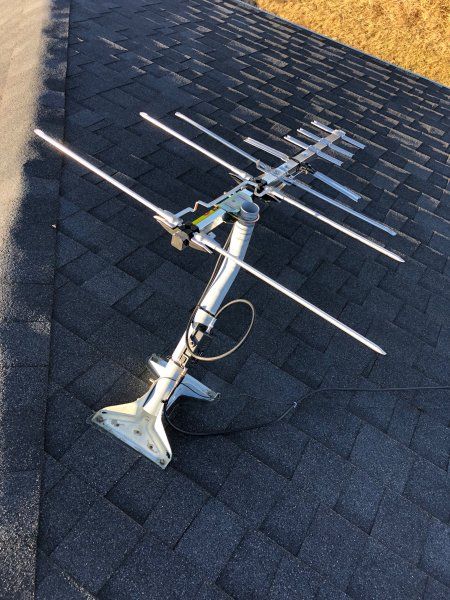

These are photos of my setup.

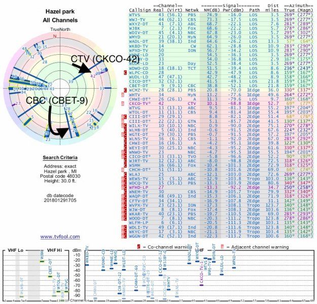

Using TVfool you have a lot of LOS signals with the poor directive capabilities of the 751 I would expect a lot of Co Channel interference. I would guess a range of about 40 miles without amplification.

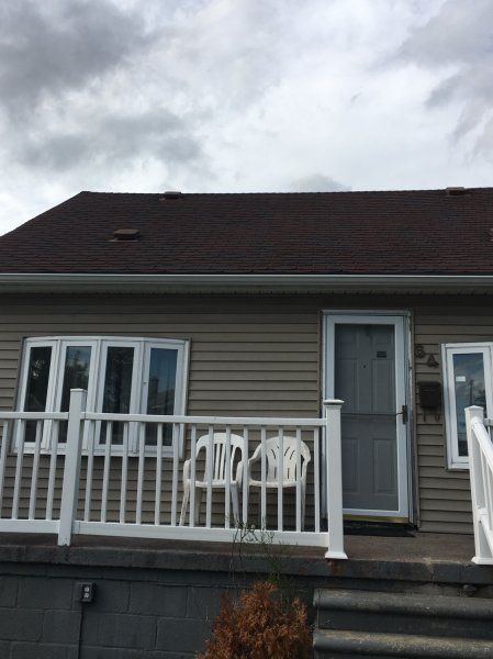

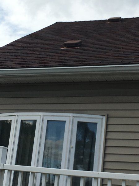

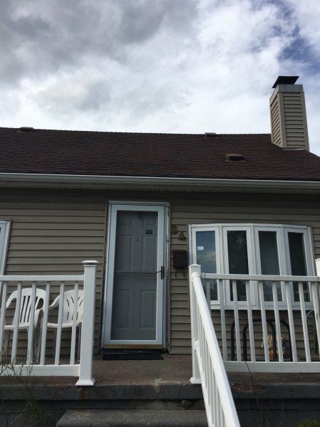

This is the view
The antenna will be installed by the window on the left on the roof
Aimed south 167
Or should I put it by the chimney

I would lag screw it to the chimney. The corner should have a 2x4, use lag screws long enough to go into the 2x4. You also should be able to run the coaxial cable down the chimney inside the attic or outside. Mounting on the chimney won't put holes in your roof, and it should be as high as possible. Why are you aiming at 167 degrees that looks like you will be aiming the back of the antenna at most of the broadcast channels?
Reactions: comfortably_numb
You also need to consider if there is anything in the line of sight to the towers. How far are any trees or other tall objects that may be in the way. In general, height is better for an antenna. (however this is not always true) Your TVFOOL shows a height of 30 feet. You are most likely less than 30 feet elevation. Your location shows 22 miles and line of sight, should be good.
A gable mount also would do great if you want to mount it on the other end of the house. (google antenna gable mount for pictures)
The issue that transcends distance predictions is that most of your locals are west of you while the Canadian stations are NNW and ENE of you. Without a rotator, this is a problem that a Yagi typically can't deal with (unless it has a very wide beamwidth).
As boba pointed out, you have a remarkably large number of co-channels (other stations broadcasting on the same frequencies) that you're being bombarded with. It may well be that you need multiple antennas and a switch or a rotator and that's inconvenient at best. This is where a very directional antenna may allow you to only pick up stations from a very narrow segment (narrow beamwidth).

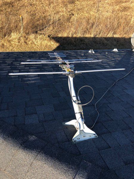

Larry, Just remember that CTV (CKCO-TV 42)is still broadcasting in NTSC analogue and their transmitter is in Sarnia ON. You won’t be able to get CTV and CBC with one antenna, you will need two antennas or a rotor because they are in complete opposite directions. You shouldn’t have any problems getting CTV either because they broadcast in analogue .
Here’s my Antenna setup. The RadioShack is aimed South, to get most of my channels including CBC and TVO, And the Clearstream is aimed towards Sarnia to get CTV and Global (marginally)
