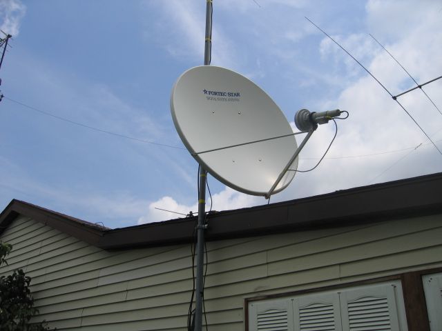

My ultra gets fussy under 35%.
l had been using an Invacom 031 on a 30" dish. This LNB gives about 15 points less. So 80 turned into 60 to 65, and 55 turned into 40-45.
So far, my Ku has been OK.
My biggest issue has been the weight of the bigger dish, and HH120 motor on my mounting pole. I'll be changing it out from telescoping push up pole, to the current 2" tubing, to a new 20 foot piece of 3" EMT tubing I swiped from work...
The 2" is better, but still flexes a bit. The 3" should be OK.
Pic attached is of the 2" pipe.
