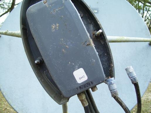

Ok the LNBF is not round, but I am sure it is the original, I have seen a cuple that look like it, it is flat, kind of like a sardine can, but larger, it mounts to the feed horn on one of the flat sides, then it has the leeds that you hook the cable to on the bottom, one for H and one for V, it does have the little scale on the feed horn side to set the angle with, but it does not say weather it is for H or V, so not sure how to set it, I read some where that if you hook up to one of the leads either H or V that the voltage will either burn out the LNB, or the receiver, can't remember which one now, land don't know if that is true or not, I know it worked fine when I was hooked up to the V side, I never have gotten it to work on the H side!

Edited to add: the LNBF looks just like the one in pictured in the first post of this thread:
http://www.satelliteguys.us/free-air-fta-discussion/57938-primestar-lnbf-1x-7-cm-dish.html
dovebar LNB
These pictures were previously posted to the forum.
I think the casual nickname we use for 'em is: dovebar
Not sure why you'd ever want to skew the LNB when you should be skewing the elliptical dish instead.
Note the V and H markings on the back side.
I've never seen one in the wild, but maybe someone who's used 'em will chime in.

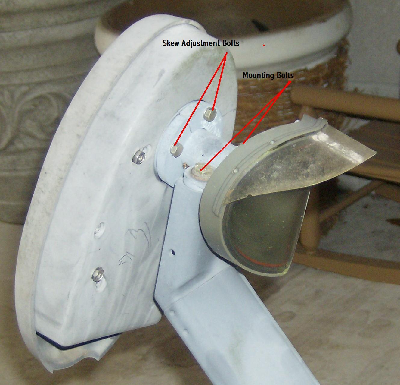

Ok that is what mine looks like, how would you skew the dish instead of the LNB?
Terry
You stand in front or behind the dish, and put one hand to each side.
Your hands go at 9 o'clock and 3 o'clock.
If you can twist the dish like a steering wheel of your car, that's skew.
There should be some bolts on the back side to loosen , of course.
See table in this post for how it may be identified.
But what worries me, is that those dove bars are skewable, so maybe the dish mount isn't!?
Never had one, and never read that much about one, so I just don't know.
Take a look on the back side of the mount, and tell us (or post some pix).
I took a dove bar off a 1m Primestar, but didnt hook it up to see how it worked. The Oval Primestars ( 60e.75e, 84E) feedhorn has a line cast into it, and the LNB's, especially the aluminum cased ones, have a line stamped into them. You line them up, and you are at zero skew, if you install it on the dish vertically at the TS satellite. I think I still have the dovebar, if I do I'll check and see if I can discern the mounting position for ya.

I have a round 1m dish presently with a dove bar lnb (not pictured) The only way to skew on this style dish is to rotate the lnb, thus the scale on it comes into use.
