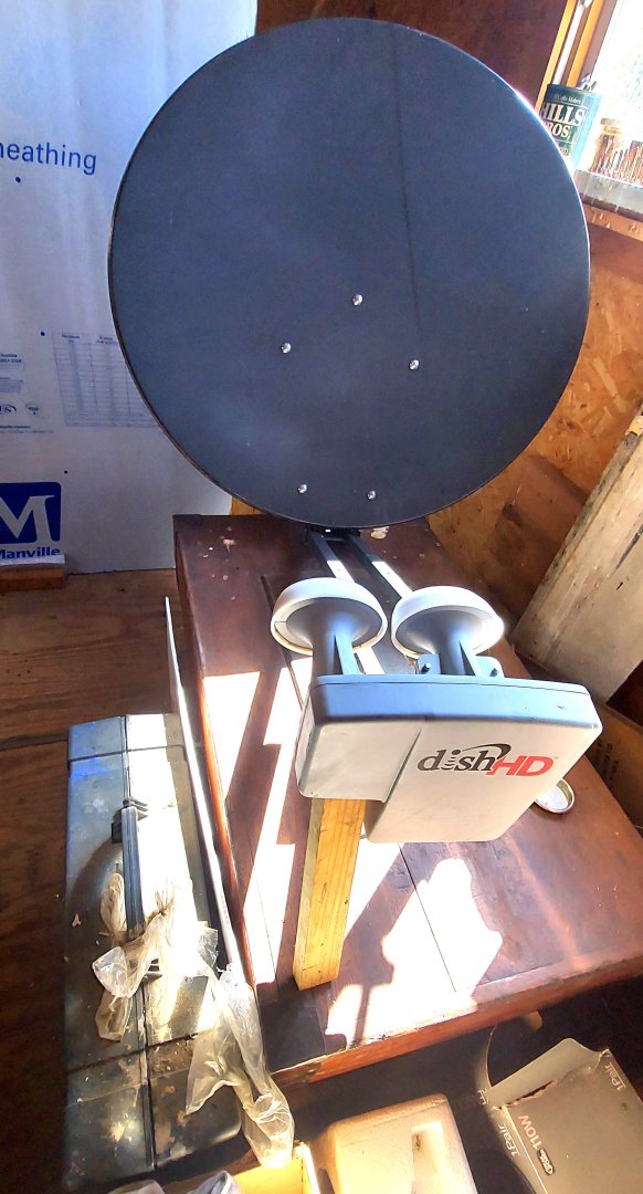

I pass this dish on the way home from work every day. It's just off the road so I grabbed these pictures for you. Hope they help! It looks like the aiming point is directly at the center of the dish.
Thanks for these pictures! I just discovered yesterday that I have one of these in my stash, had completely forgotten about it. This will be my project for the upcoming weekend.

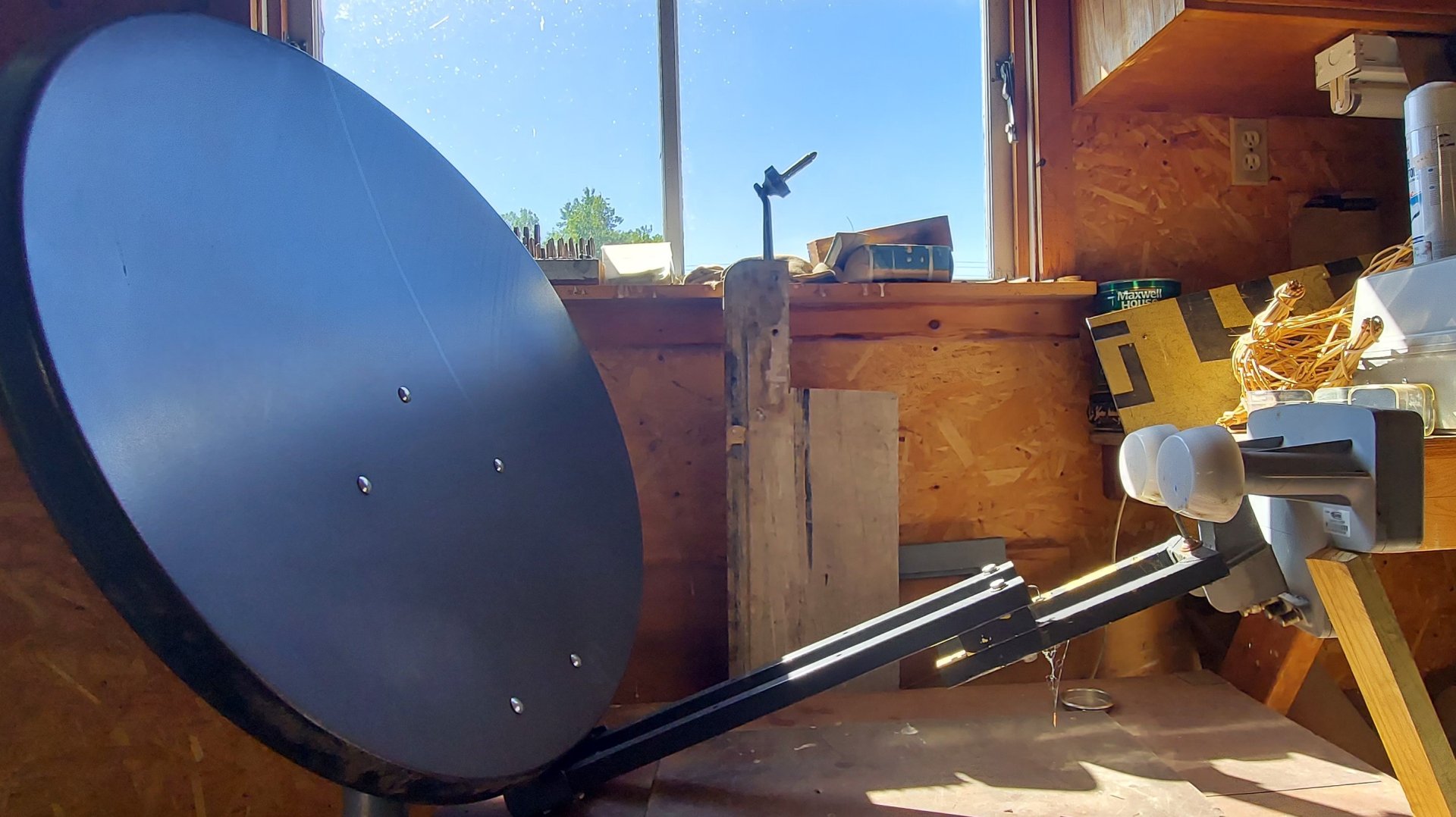

Pulled my retired Wild Blue dish from 'the pile'. It initially had a tria mounted under the arms pointed at a subreflector.
It took a bit of doing. The water trik was a disaster. Little stick on mylar mirrors and maybe a little smoke. The sun and a piece of paper. With a bit of playing around with angles to get the best offset figured out. That was back in my chinabox days before my friend got 'the letter'. But after some tweaks it worked pretty good. That's where i learned how important skew was with multi lnb setups. To balance signal levels. Getting that sun spot as tightly focused dead knutz in the center and jotting down the measurements. Then swinging it left and right to make sure it stays a spot. Adjusting elevation and doing it all over again. Patience.
