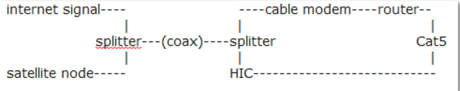

Would I be able to use the same coax cable that has my internet (to modem/router) to connect to HIC? For example, get a splitter of some sort and combine the dish signal from the node and the internet signal (cox) run it through the existing coax and then split it again to the modem/router and HIC. So it would basically look like this:
<img src="http://www.satelliteguys.us/attachment.php?attachmentid=76468"/>
I don't think that would work too well without a ton of interference from both internet & sat signals. A pair of diplexers would theoretically work better due the signal isolation, but I'm not sure what freq range the HIC uses or your ISP uses.
Sent from my HTC EVO using SatelliteGuys
They both are on lower frequencies. So diplexer wouldn't work. Splitter would likely cause intermittent connectivity throughout entire system. Could you tie a rope or some dual cable to the existing line and pull it through?
