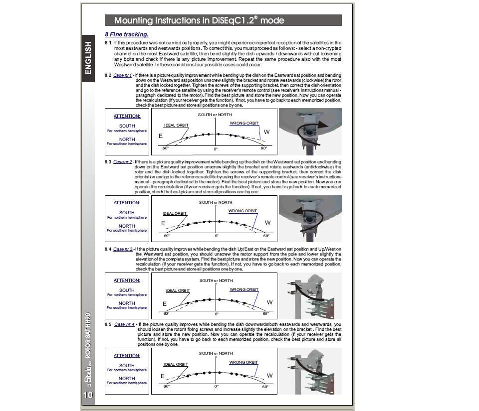

Dish Arc Adjustment
Found it! Hope this may help you.
To see if that dish is warped, do the two string test: one string hortizonal (centered at dish) and the other verticle (centered at the dish). If the strings at the center of the dish doesn't touch, the dish is warped.
I hope this info on the arc adjustment may stop you from going thru all the trouble of taking the dish off and reassembling all over again.

THanks to all for the advice! I seem to have things back in order. Here is what I did - not sure if it was one thing or several that was causing problems:
I but my old 80cm Fortec back up. Put the old Fortec Universal LNB back on. Peaked the dish at my true south satellite. Did a factory reset on my receiver. Adjusted/tightened up the backlash on the motor.
I now get all satellites and am getting everything with good signal quality. I even have some hot tp's in the 80's on several birds :)
I do still have one problem. RTN - I just can't get a lock on it. I get the NBC bars just a booming in, but no go on RTN. At least I can get RTN OTA.
So, No I need to see if my 90cm is warped, and replace the broken bolts. THen I will set it up and attempt to get RTN. THANKS again!
