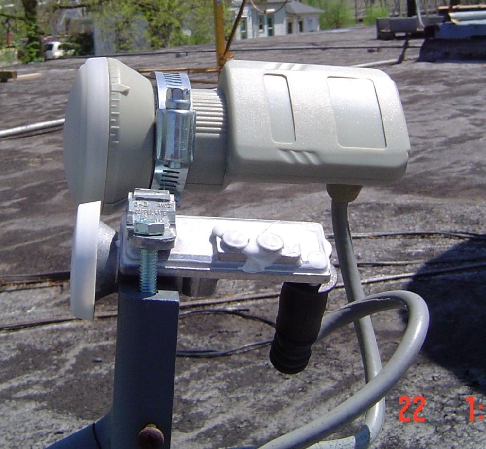

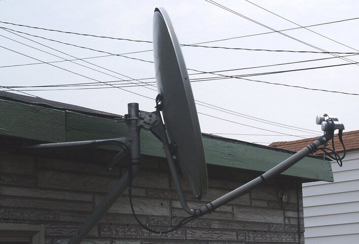

Side rim shot for Iceberg
Ice, here's a side view of the rim.

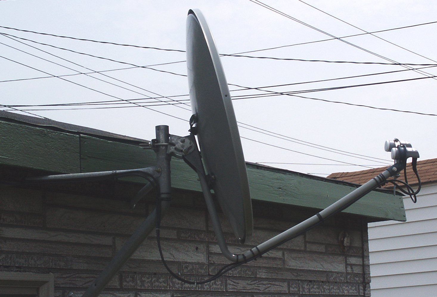

Here my Dish farm. Picture one 12 foot Unimesh, C band movable. 85cm ADTH with dual LNBF's for G-10 and G-27. Picture two 90cm Primestar for AMC 3.

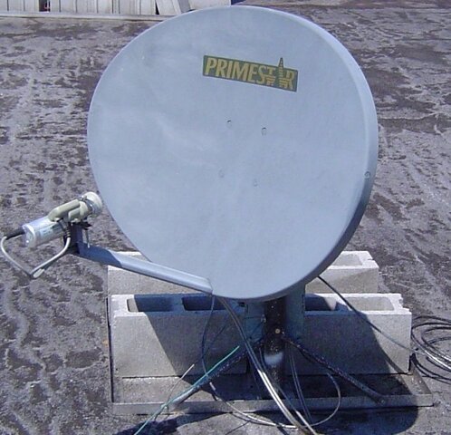

As promised, these are pictures of my latest dish "Farm" taken just a little while ago.

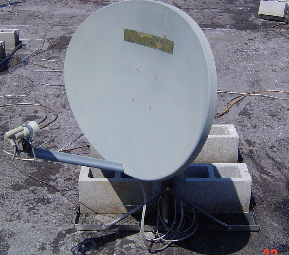

First picture is family Pstar 84e pointed at Hispasat 30W

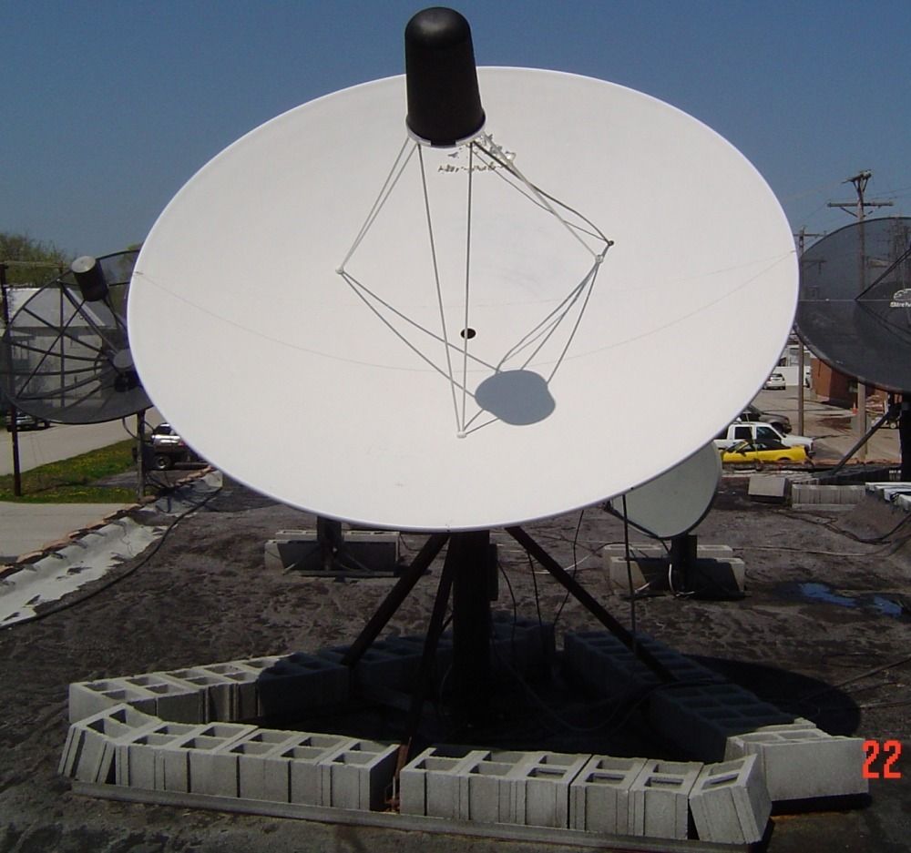

Second picture is the family 10 foot Winegard Pinnacle.

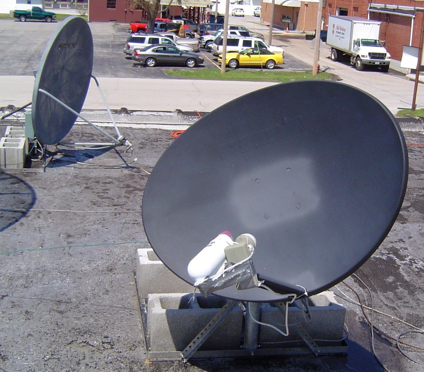

Third picture is the family 123W and 129W multi-lnb setup.

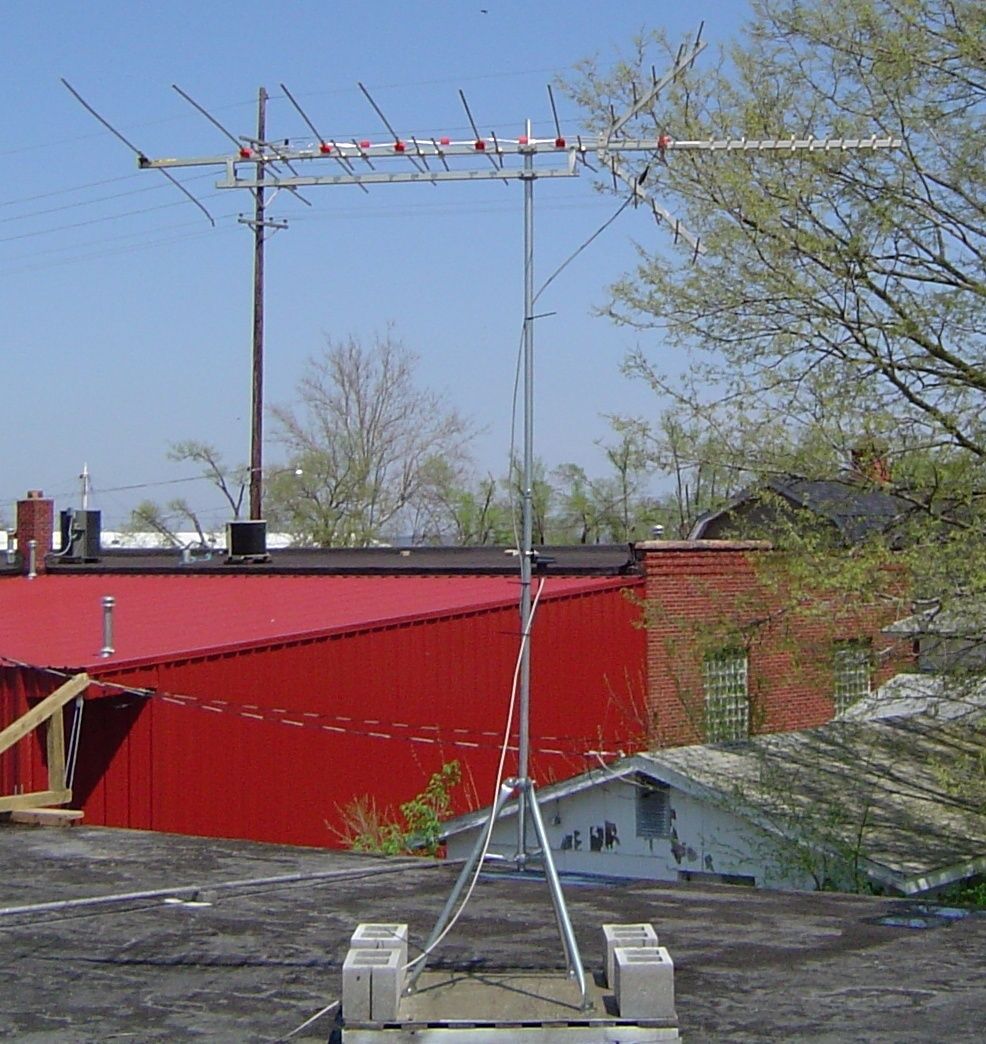

Fifth picture is our OTA antenna.

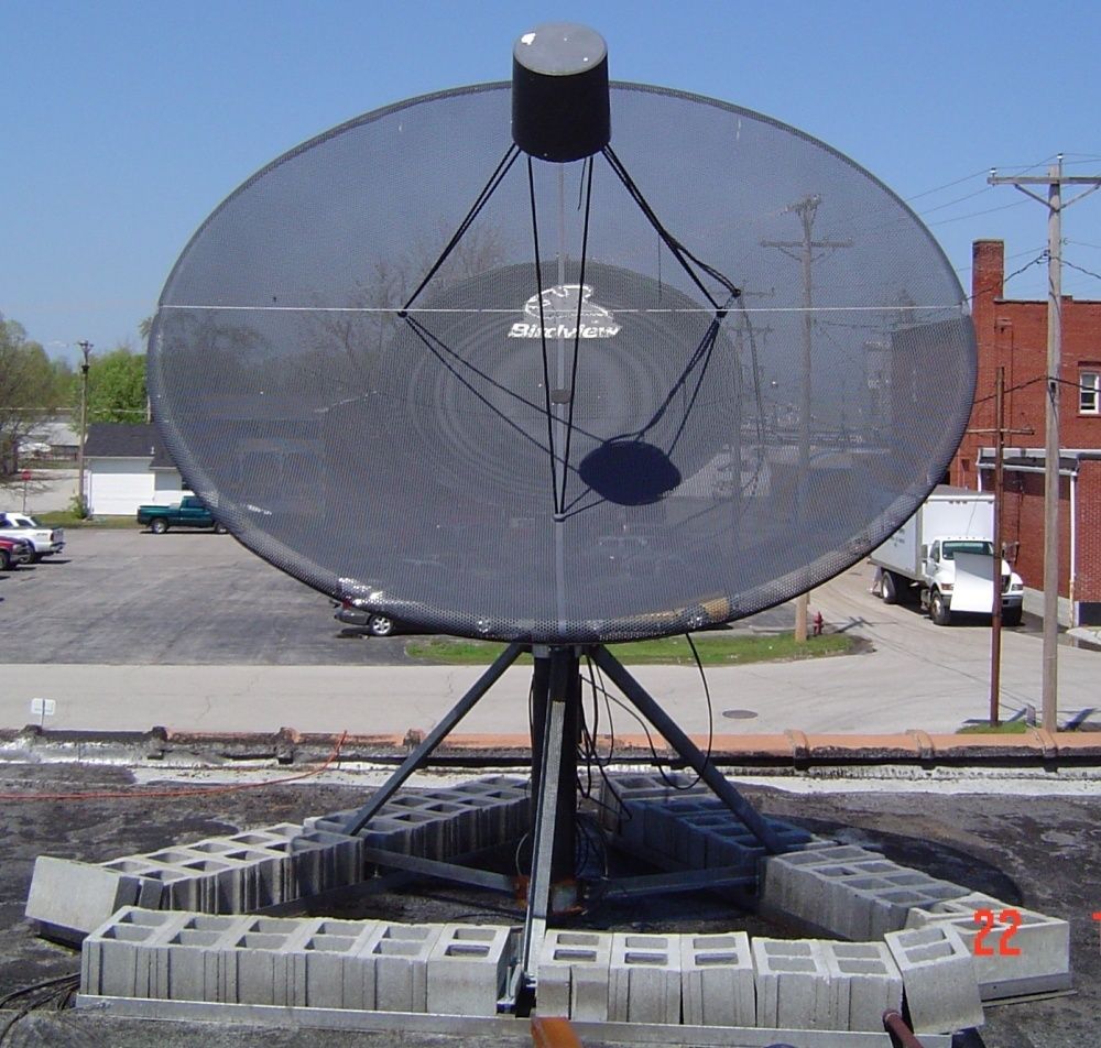

Sixth picture is my newly acquired Solid Birdview that I drove to Nashville to get. :)

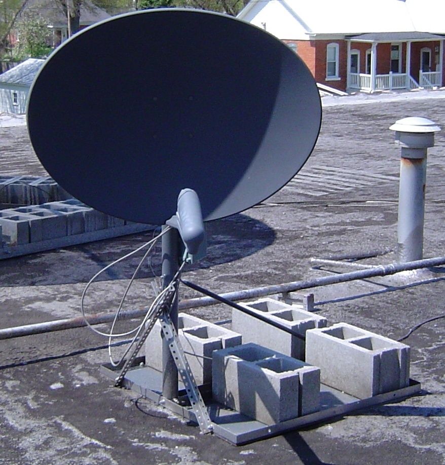

Seventh picture is my 123W and 129W multi-lnb setup.

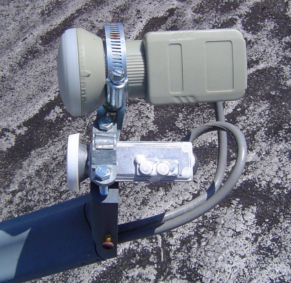

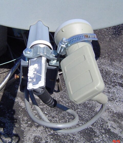

Eighth through eleventh is still of the 123/129 setup but just for Anole, shows the naked Bullet LNBF from SatAV mounted with the top half of an ordinary ground clamp from Lowes. I ground off the little hole and set-screw on the very top. See the little notches that hold it in place with the proper skew. :cool:

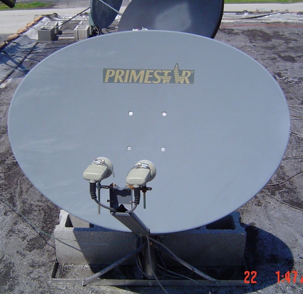

Twelfth picture is my 87W and 97W multi-lnb setup.

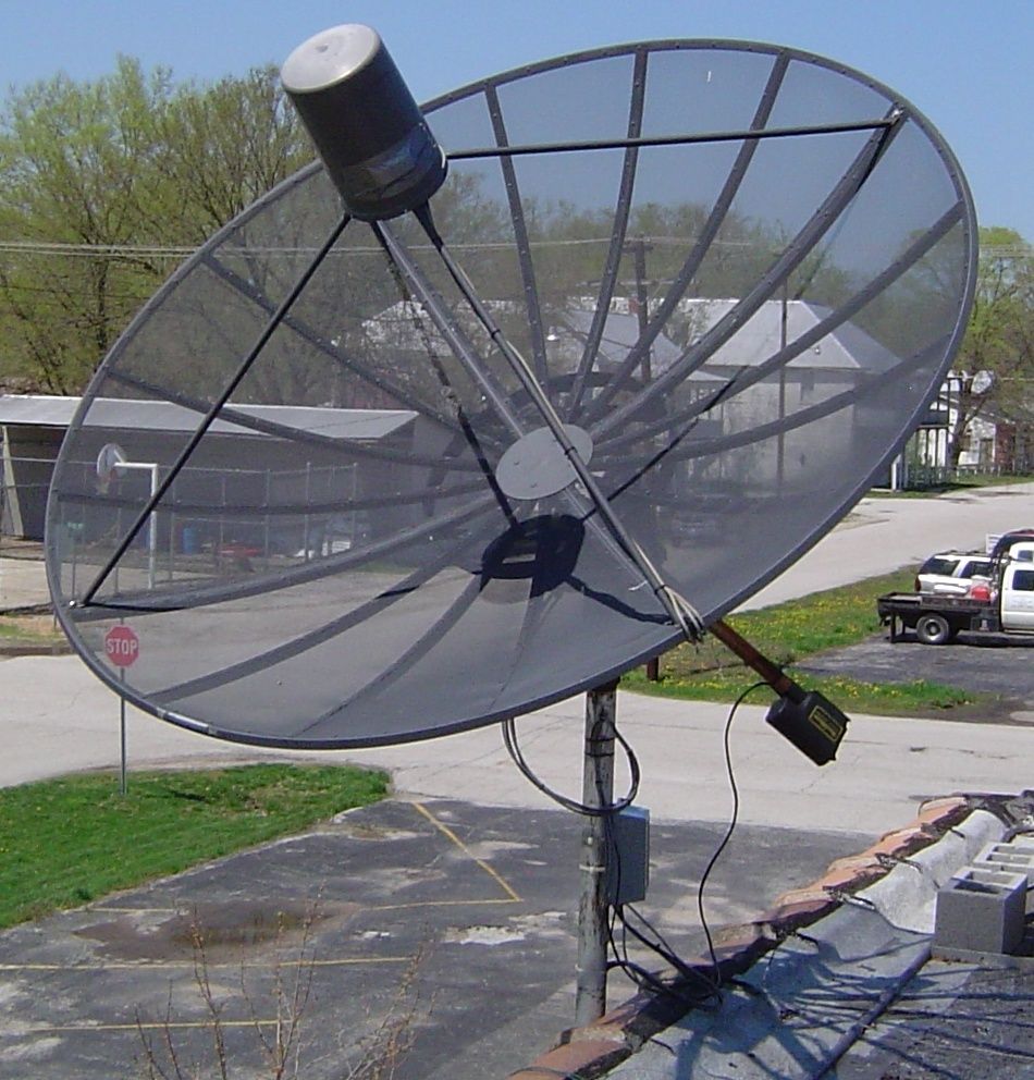

Sixteenth picture is my pride and joy, and first Birdview I found on my own, my Perfed Birdview.
